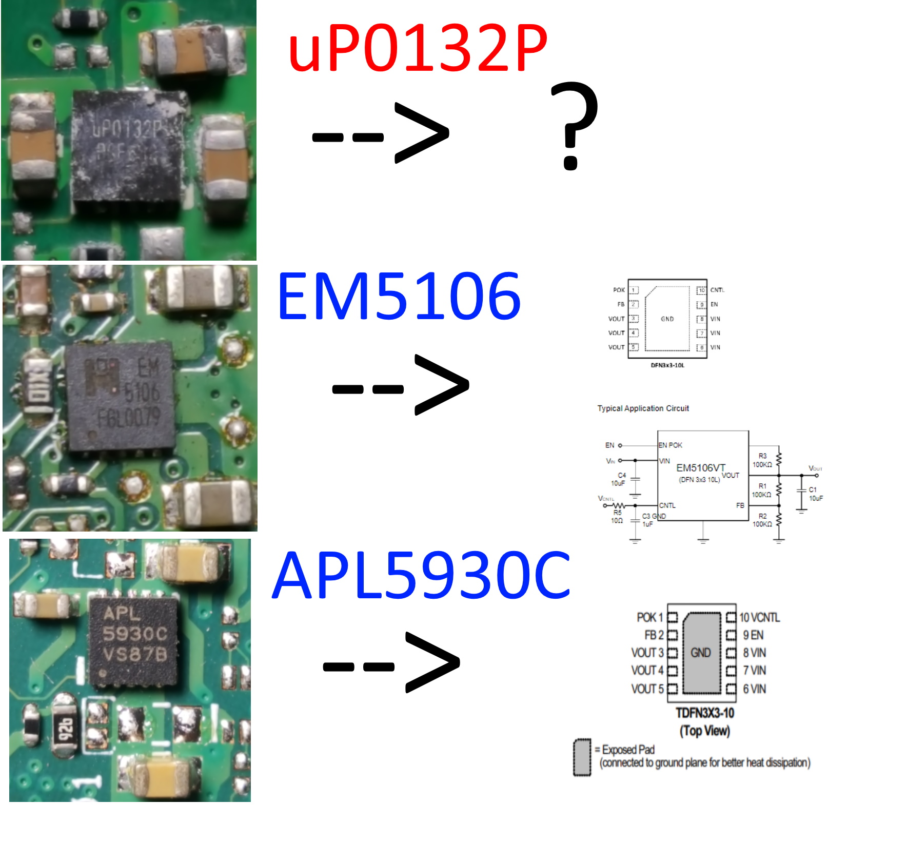

    Hi All,
    Can I replace uP0132P with APL5930C or EM5106 ?
    thanks

    EM5106VT=UP0132P. Dont know about APL5930C. I'm Working on an Asus X555SJ rev. 2.0 motherboard and UP0132P is shorted. have replaced with EM5106VT and it has worked.

      Re: subsitute uP0132P with ?
      thanks
