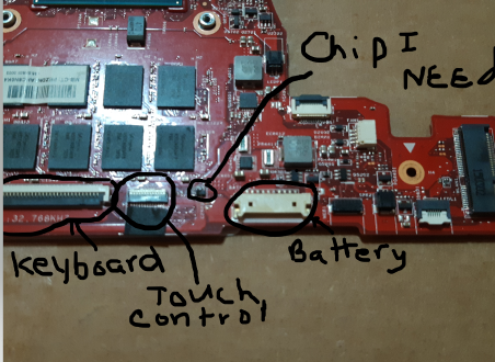

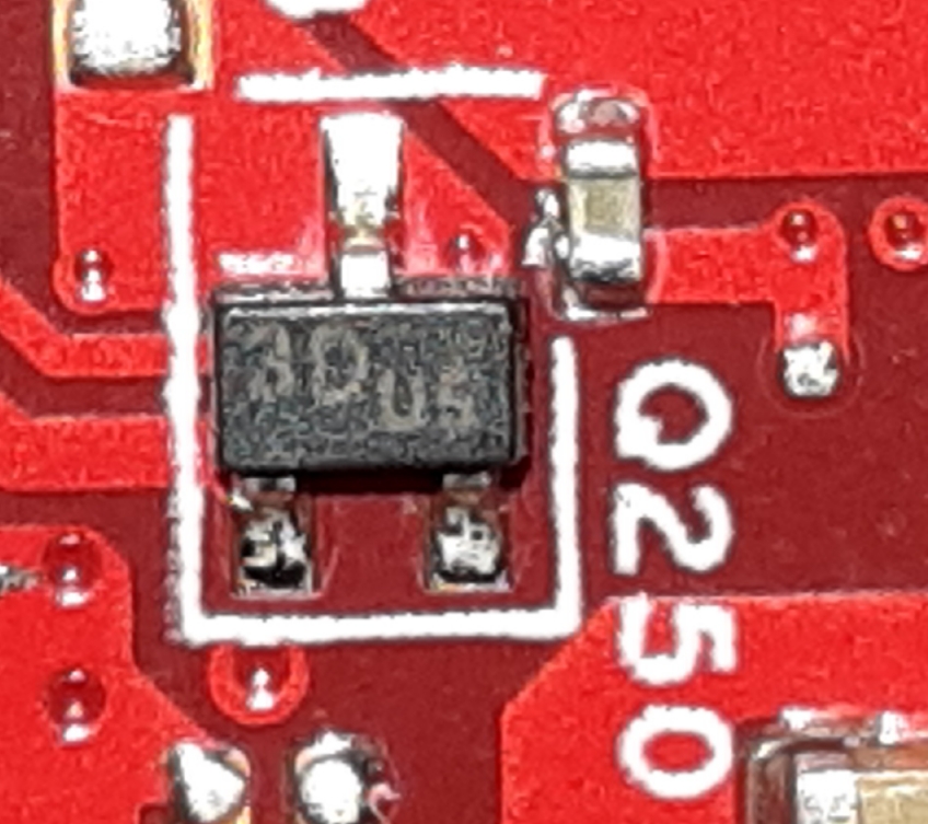

    Need help identifying the chip in the pic so I can order one. It looks to have "3D" and "U5 or maybe Q5" printed on it. I went on a couple sites to try and find it, but there are too many and I don't really know how to find it. I think it's a mosfet? of some kind. With some help on another site, I ordered 3 BC856 transistors as we thought this was the right part. But as you see in the 2nd pic, it's a little too big. Any help would be appreciated! Btw, this is near the battery connection terminals on an HP Omen 15 at location Q205.

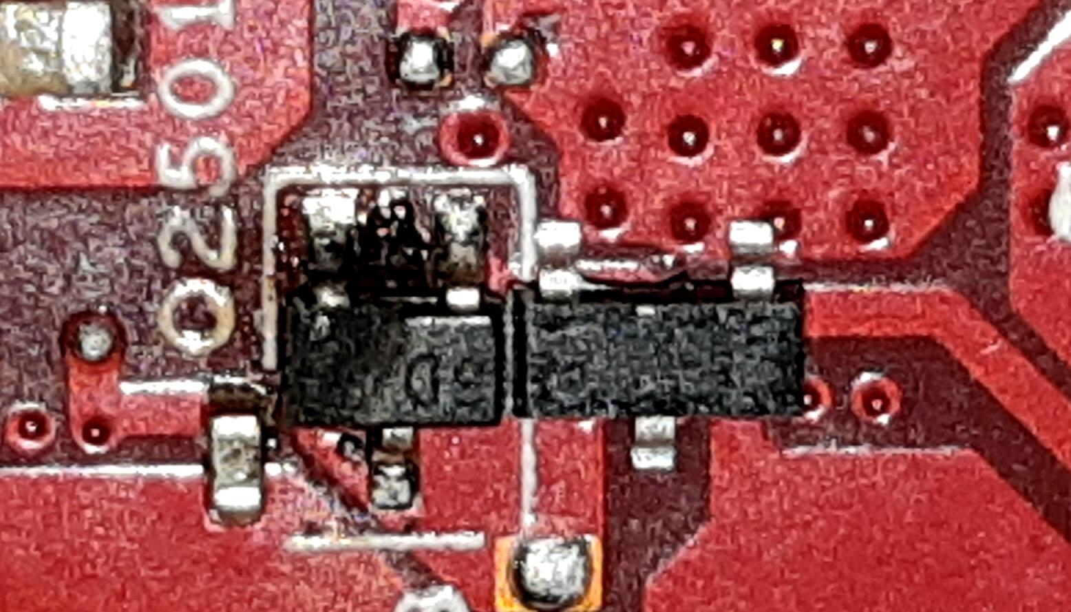

                        If you look at the single chip (pic on the left), that's the chip on my new motherboard. I used that one so people might be able to see the markings. The pic on the right comparing the 2 chips shows the one that's fried. That's the one I need to find a replacement for.

                          Did you check the transistor on the new motherboard to see if it was NPN/PNP or maybe a MOSFET etc. It depends where it is used but it might just be a simple switching transistor, It could also be a custom number for the board maker
                          I do see a BC856W marking code 3Dt, Package style SC-70/SOT323

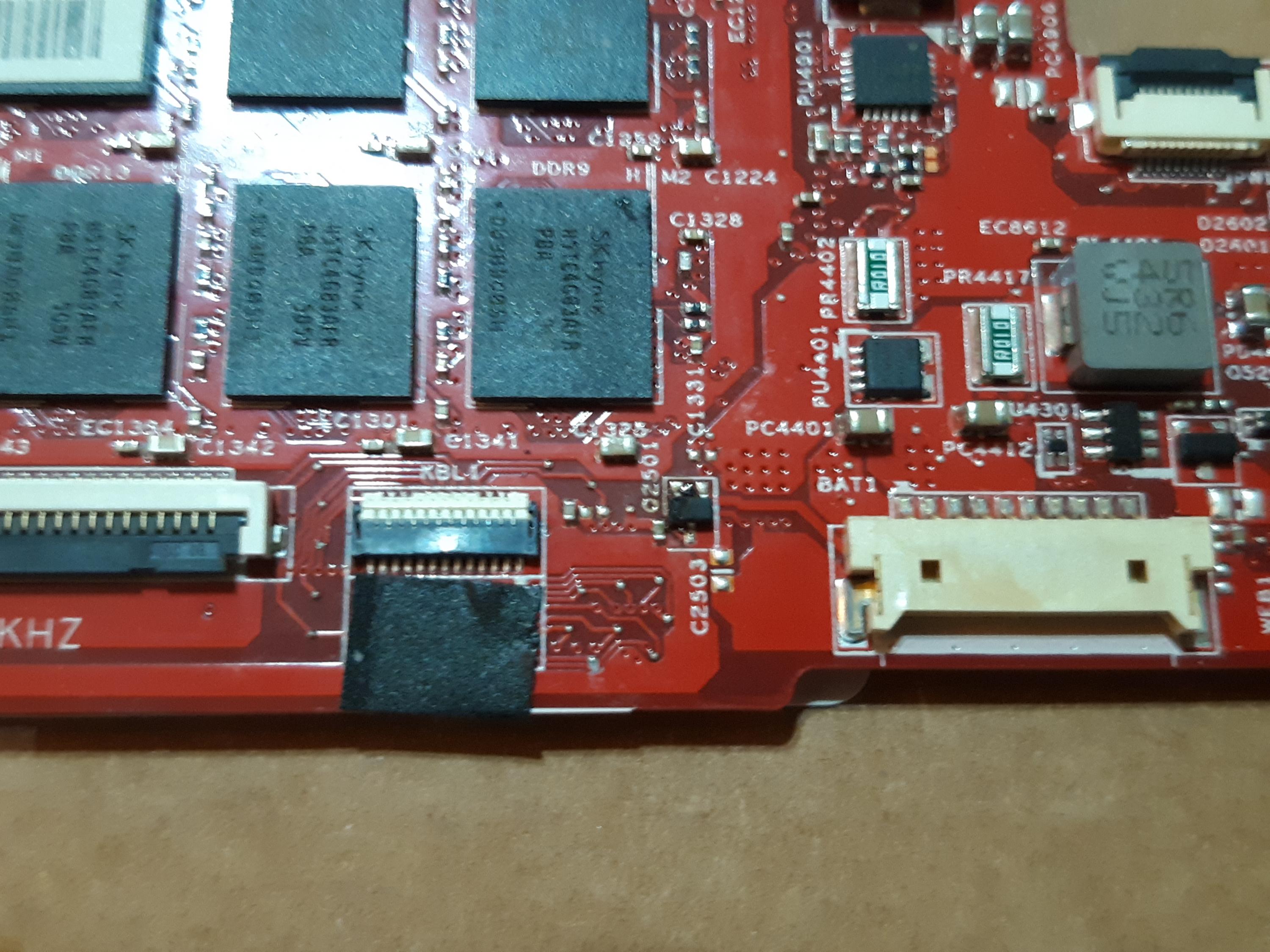

                              Post more photos so we can see whats around it

                                Use your multimeter in diode test, with one probe on the base then with the other probe check emitter then collector should read around .6xx if not reverse the probes and check again, depending on which probe is on the base should determine the polarity.
                                Based on picture 1, the base would be on the left, emitter on the right, collector by itself at the top.
                                If the new transistor checks like the one on the new MB, you could likely solder it in place even though the leads don't quite match the pads you should be able to solder it on to try it.

                                  OK, y'all are gonna love this! I'm not very good at drawing...lol! Here's a pic of the board and stuff around it and one more pic. Btw, those larger black chips above and to the left are components of the 16GB of RAM.

                                      Instead of taking the laptop apart to get at the new board, can I use the old one with the bad chip? I just checked it and with the red lead on the base (leg on left) and black on the leg on the right, I get 0.340 and it started dropping and kept dropping slowly. It was at 0.251 when I removed the lead and still dropping. Red on base and black on top leg, I get 0.260, no dropping voltage. With black lead on base and red on right leg, I get .480, then it went up slowly to 0.504, then dropped slowly and kept dropping till it seemed to stop at 0.491....but after about 15 seconds, it dropped to 0.490. After about 25 more seconds, it dropped to 0.489 and that's when I removed the lead. Red lead on base and black on right leg, I get 0.340 and it dropped fast to 0.315...then slowly to 0.308 and seemed to rest there for 12 seconds, then dropped to 0.307 and I removed the lead. Red lead on base and black on top leg, I get 0.455.

                                        The old chip will be bad, likely shorted if it burnt like in the picture
