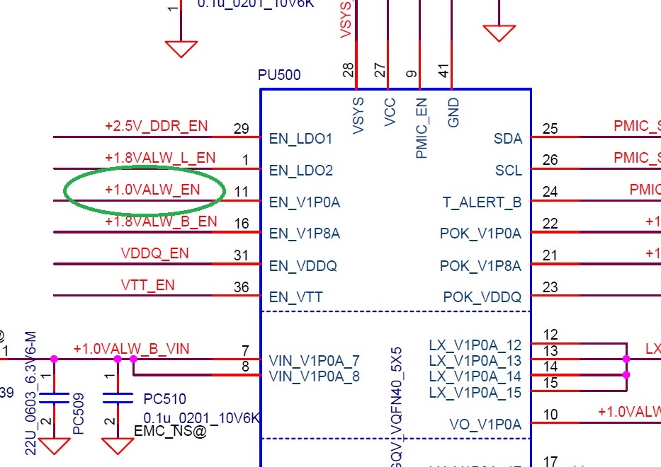

    hi all friends
    lenovo ideapad 310 no power on
    but after about 10 sec of pressing power button led 2 lighting orange for 1 sec then off
    mb nm-a752
    pl401 3.3v ok
    pl402 5v ok
    ue1 (ite8586e)
    pin 93 rsmrst 3.3
    pin 108 ACIN# 3.3
    pin 109 LID_SW# 3.3
    after pressing power button
    pin 18 PM_SLP_S3# 0v
    pin 21 PM_SLP_S4# ov
    i reflashed main bios and ec (ite8586)
    what can i measure after that
    thanks

    Re: lenovo ideapad 310 no power
    Check AD_ID

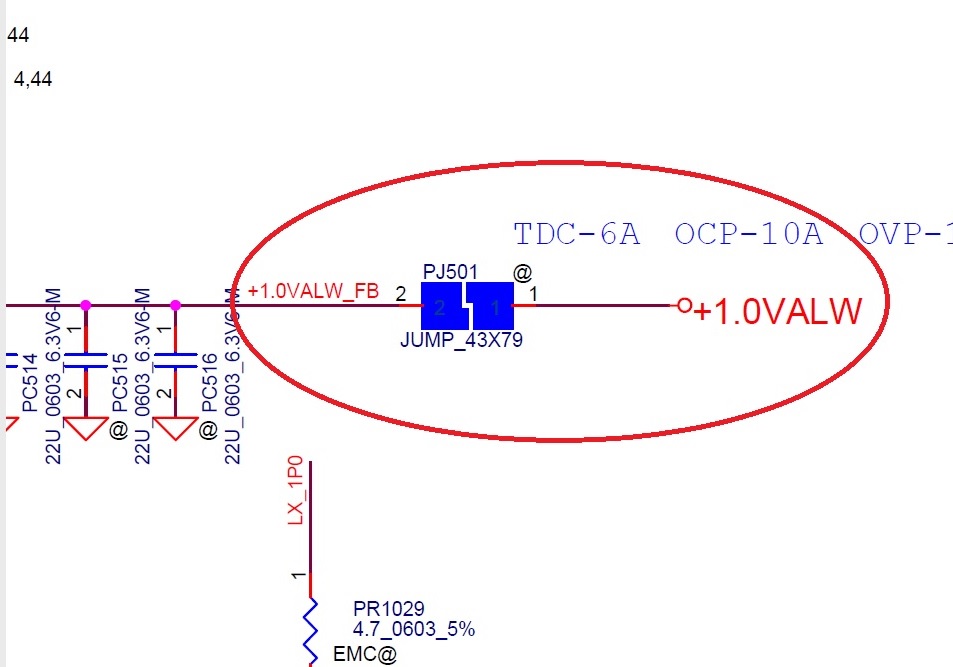

        problem solved
        when i measuring MB again found pl500 +1.0VALW is not present
        +1.0VALW generating by pu500 LV5075AGQV
        pu500 pin 11 +1.0VALW_EN is 3.3v ok
        replaced pu500
        pl500 +1.0VALW 1v ok
        MB power on normally and display ok
