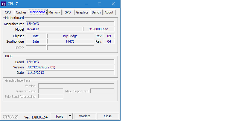

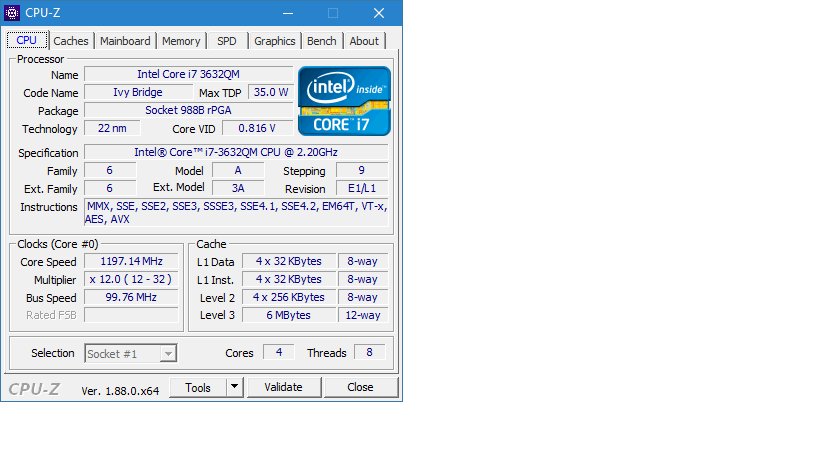

    Greetings everyone,
    I'm having trouble in bringing my Lenovo G500 laptop back to life.
    Brand: Lenovo
    Model: G500
    Main board: LA-9631P
    BIOS: 78CN25WW (Modded: advanced options and WLAN whitelist removal unlocked)
    After accidentally disabling the Intel graphics from the advanced BIOS-menu the screen stays black and the laptop is not booting whatsoever. The laptop does turn on (power light comes on) and after a minute or so the CPU fan starts spinning. The person who modded the BIOS warned me not to disconnect the Intel VGA card or not to change the size of the video memory. Unfortunately this was more than six months ago and i forgot about the warnings... In an attempt to enable the onboard AMD GPU I turned off the Intel graphics. Now my laptop is bricked
    Symptoms when power button is pushed are:
    • Power led turns on.
    • CPU fan start spinning after a short while.
    • Don't see the back-lighting turning on.
    • While on the laptop beeps when the power adapter is plugged in or unplugged (normal behavior).
    What I've already tried without success is the following:
    #1 During boot-up, if pressing Fn+F2 to access the BIOS.
    #2 Removing the AC adapter, battery and disconnecting CMOS battery, then pressing the power button for 20secs.
    Reconnecting the AC adapter without putting the battery back in and pressing the One Key recovery button.
    #3 Disconnecting all power sources and leaving the laptop overnight.
    #4 Removing AC jack, Main Battery, and disconnecting CMOS Battery. Removing HDD and all DIMMs. Waiting 10 mins. Pressing and holding power button for 30 sec. Connecting CMOS Battery and one DIMM only and inject AC jack (without Main Battery). Boot laptop.
    #5 Shorted "clear CMOS" (CLRP2) pads on main-board beneath hard-disk slot (picture attached) and cycling power on (1 minute) and off, remove short.
    None of the above changed anything...
    I've attached some images with extra info about the laptop.
    Any thoughts or advise is greatly appreciated.
