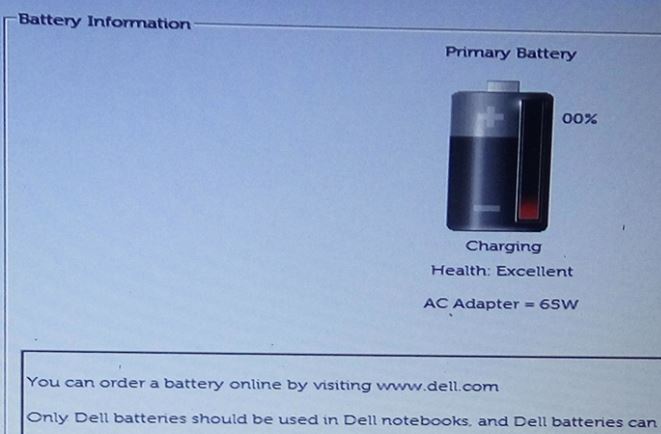

    Dell Inspiron 5567 Battery not charging (LA-D801P)
    laptop wont charge the battery. battery shows as charging in bios/system info
    here are some measurements i took.
    DC Jack
    19v
    3.3v PSID
    Battery only - Power Off
    1-3 GND 0v
    4 SYS_PRES 0v
    5 BATT_PRS 0v
    6 DAT_SMB 0v
    7 CLK_SMB 0v
    8-10 Batt+ 10.7v
    Battery only - Power On
    1-3 GND 0v
    4 SYS_PRES 0.0022v
    5 BATT_PRS 0.023v
    6 DAT_SMB 3.3v
    7 CLK_SMB 3.3v
    8-10 Batt+ 10.7v
    Adp only - Power Off
    1-3 GND 0v
    4 SYS_PRES 0v
    5 BATT_PRS 3.38v
    6 DAT_SMB 3.38v
    7 CLK_SMB 3.38v
    8-10 Batt+ 0.05v
    Adp only - Power On
    1-3 GND 0v
    4 SYS_PRES 0.0022v
    5 BATT_PRS 3.38v
    6 DAT_SMB 3.38v
    7 CLK_SMB 3.38v
    8-10 Batt+ 0.0v
    Adp and Batt - Power Off / On same voltages
    1-3 GND 0v
    4 SYS_PRES 0v
    5 BATT_PRS 0.032v
    6 DAT_SMB 3.38v
    7 CLK_SMB 3.38v
    8-10 Batt+ 11.27v

    Re: Dell Inspiron 5567 Battery not charging (LA-D801P)
    You have to try with a new battery or voltage on pin 8/9/10 must be higher than+11V in the Schematic pl700 +17V !
          Just charge the battery with a lab psu for a little bit.
          Limit the current to 1A and let it charge to a reasonable voltage.
          That way you could rule the battery out. I revived many laptop batteries in the past with this method.
              Charge it with constant current and limit the voltage to the pack's nominal voltage.
                In schematic page 51 :
                "Adapter protection:
                if battery removed, adaptor only,
                then trigger the H_PROCHOT#,
                keep @ in BOM since battery can not
                be removed by end user"
