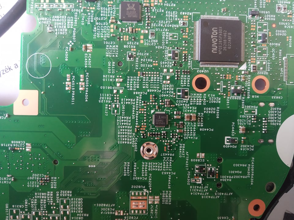

    Hi Friends,
    Laptop works fine with power supply plugged in. On Battery with 80-100% charge also. When capacity is lower than 80% backlight begins flickering. Below 40-50% backlight turns off. Problem is motherboard-related - also testet with new battery.
    Motherboard is LT41 MB 14217-1M
    Any suggestions?
    Thanks in advance.
    Best regards.

          • lordcroft
            • Apr 2012
            • 2
            • Hungary
            Re: Lenovo Yoga 500-14IBD backlight flickering
            I have sam problem, has there been a solution to the problem?
            • teknikbursa
              • Sep 2014
              • 64
              • turkey
              pls check the 10 ohm resistor on vcc line of charge ic. if the resistor is not 10 ohm change it
              • lordcroft
                • Apr 2012
                • 2
                • Hungary
                In isl95520hrz, which is the vcc pin?
                • teknikbursa
                  • Sep 2014
                  • 64
                  • turkey
                  I'm so sorry but my donor card is different than your card but anyway pls check the resistors around charger ic specially acin line
                      Hi. I have received a Lenovo Yoga 500-14IBD with a flickering problem when it is running in battery mode.
                      When in battery mode, the DCBATOUT_LCD voltage ranges from 7.5 to 7.8v. When it is at 7.5v there is a flickering of the backlight. With 7.8v the flickering disappears. If it is with the charger connected DCBATOUT_LCD is 19v. All Ok.
                      In the diagram we can see the backlight voltage in battery mode is 10v. If we only have 7.5-7.8v, problems ...
                      Who is responsible for supplying 10v in battery mode (remember, battery is only 7.4v.)? Well, a step up circuit governed by an RT8509GQW that apparently is not doing its job.
                      Yoga 500-14 IBD Scheme:
                      We technicians exist because engineers need heroes too
                      • silvake
                        • Feb 2012
                        • 3
                        • Romania
                        Well... what if all this boost regulator circuit is totally missing from the board in some versions?
                        I'm trying to fix another Yoga 500-14IBD with the exact problem as discusssed here.
                        The screen flickers like hell when you disconnect the charger... not only in Windows, but in BIOS screen as well (so drivers or other software issues are out of the question).
                        This model is also powered by a 2-cell battery pack which appears to be in pretty decent shape, measured with a professional battery tester it's still rated at about 75% of its original capacity.
                        I tested the above theory and indeed, manually feeding some 7.6 Volts or more with a lab-psu on the DCBATOUT_LCD line, instantly stops the flickering.
                        I wanted to check the boost converter as (logically) suggested here, but I noticed my board is different, it doesn't even have this LCD voltage regulator.. the PU5001 (RT8509 IC) and all related components were not even placed on the board.
                        I guess Lenovo tried to cut down the costs and hoped a voltage level of about 7.2-7.4V shoud be enough to power the LCD backlight on battery... but it seems they were wrong.
                        Is it possible that this board's model was specifically designed to work well only with a 3-cell battery?
                        I'm wondering if a higher voltage of 11.1V (or at least 9.3-9.6V when discharged), feeded on the DCBATOUT_LCD line by such a battery, might solve the issue.
                        Any thoughts or advice?

                            • REpairAT
                              • Nov 2020
                              • 142
                              • Austria
                              Replacing the battery with the 11,1V Version (L14M3P21) fixed it for me.
