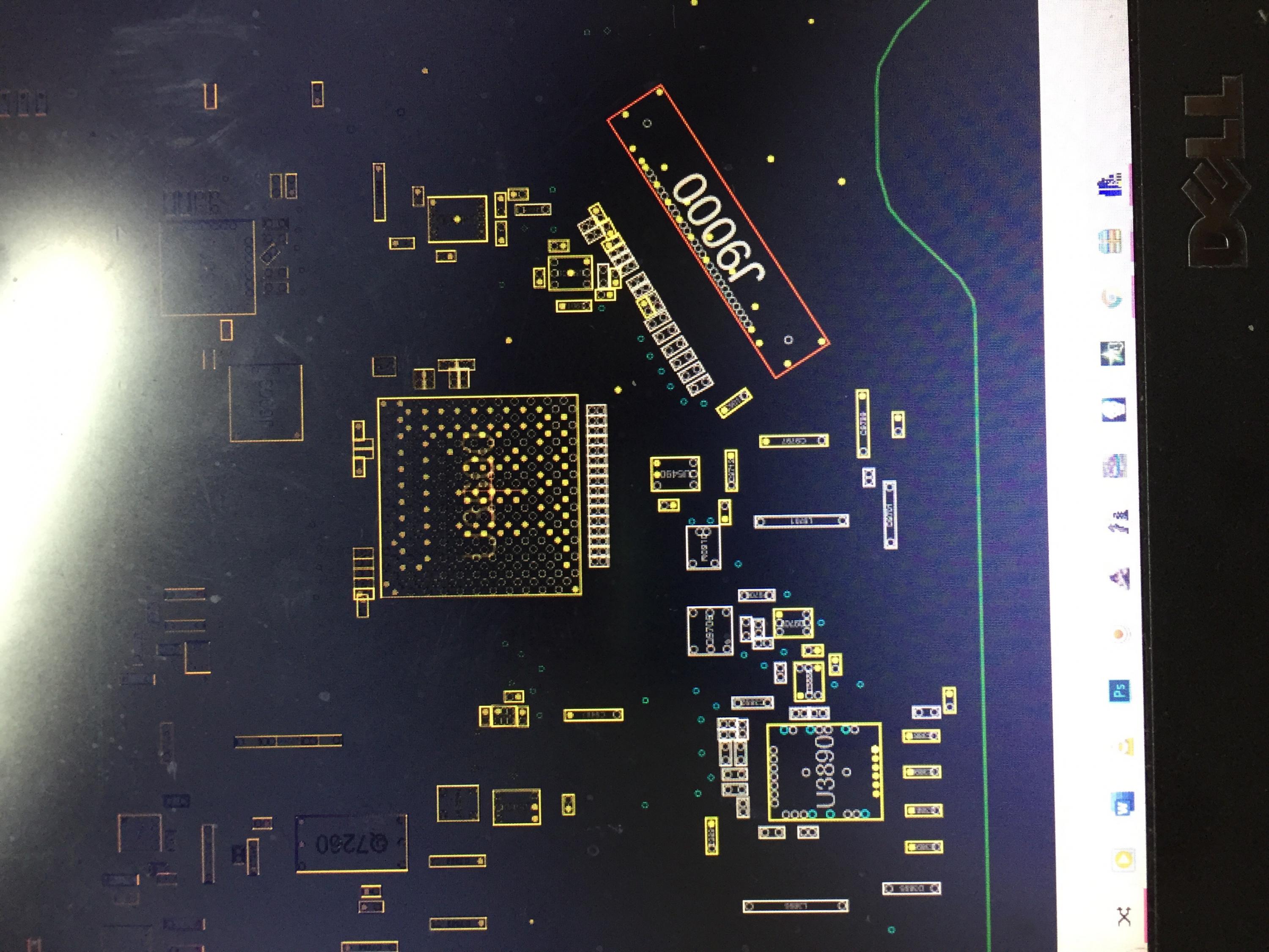

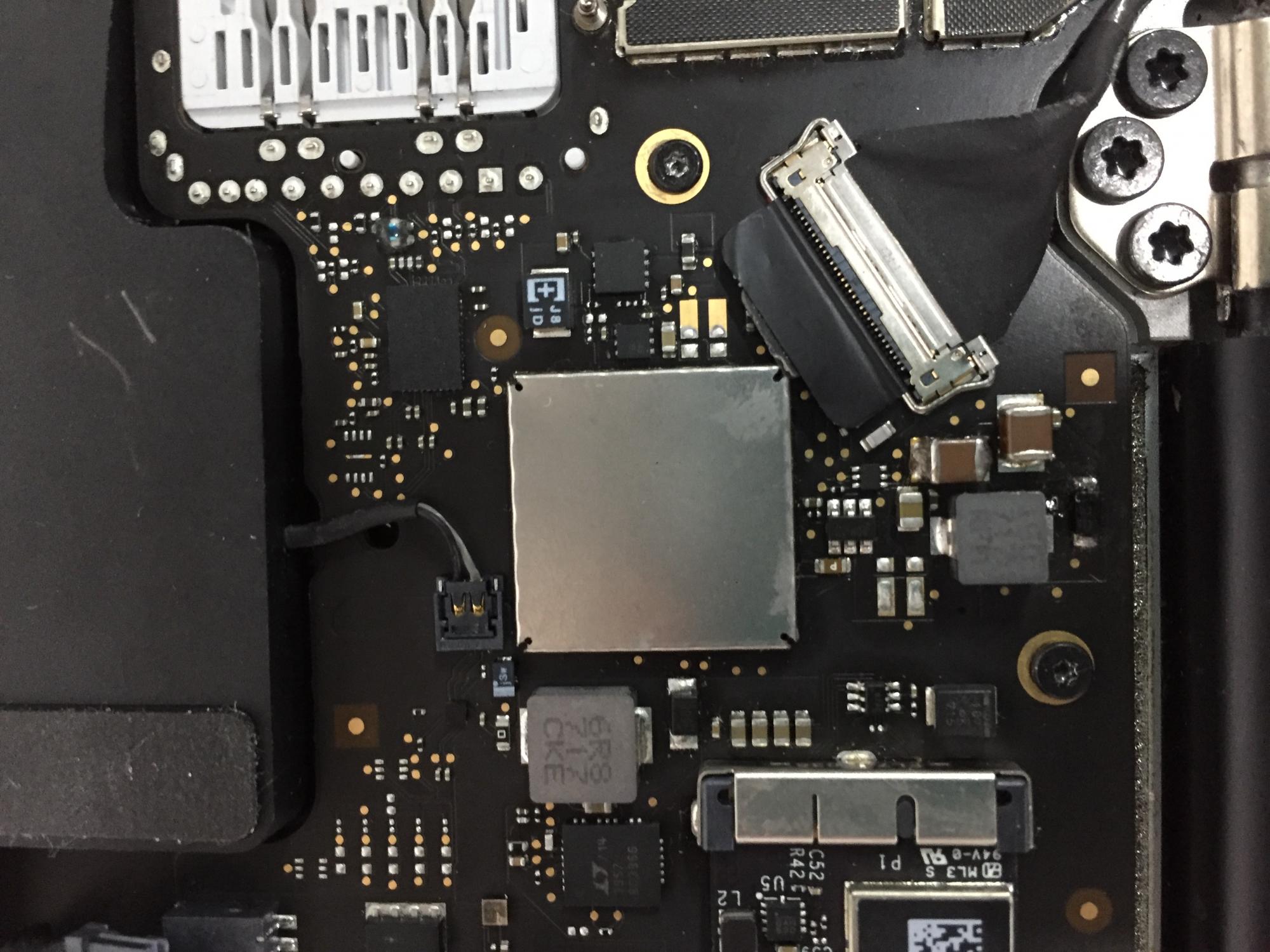

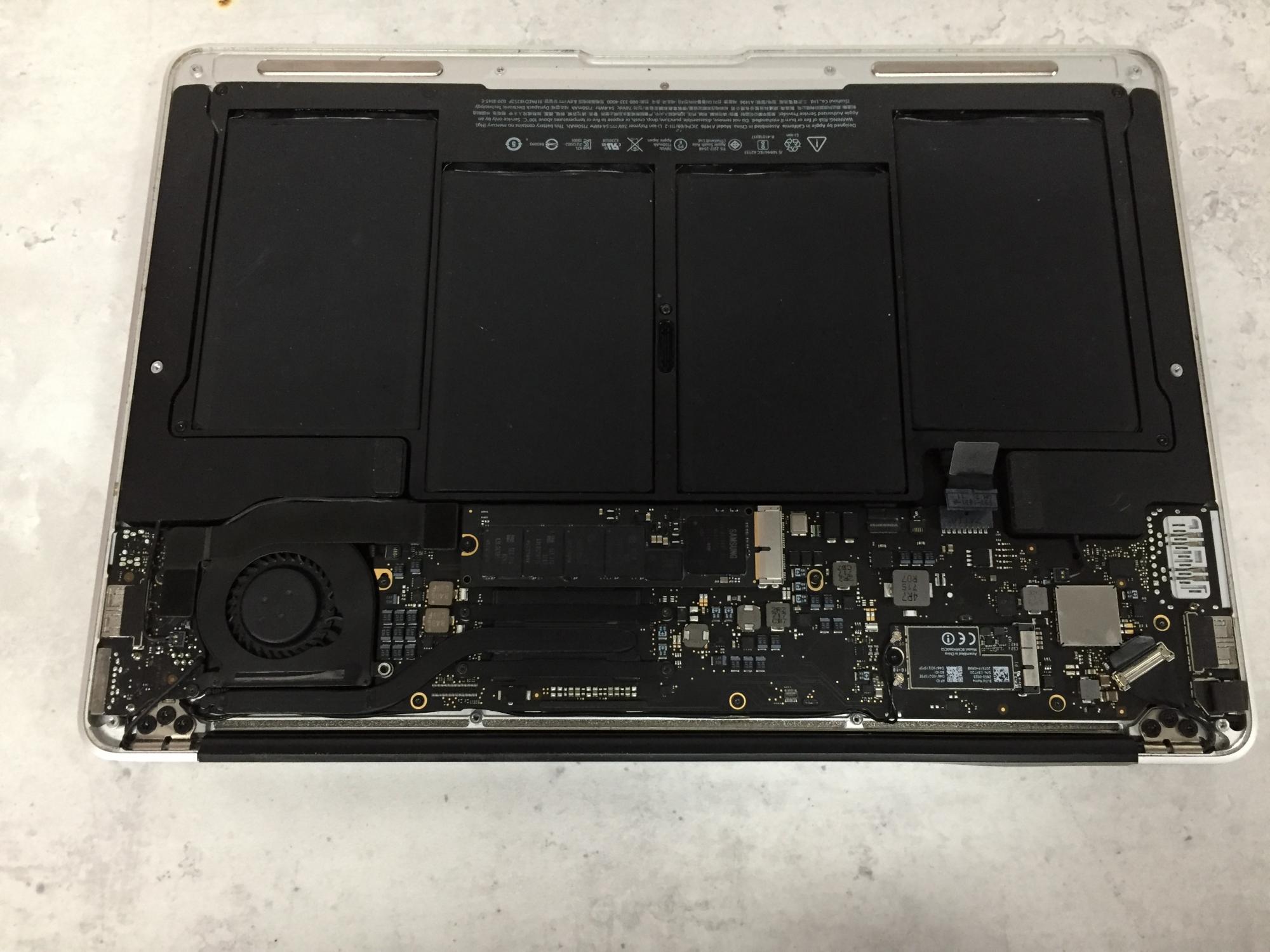

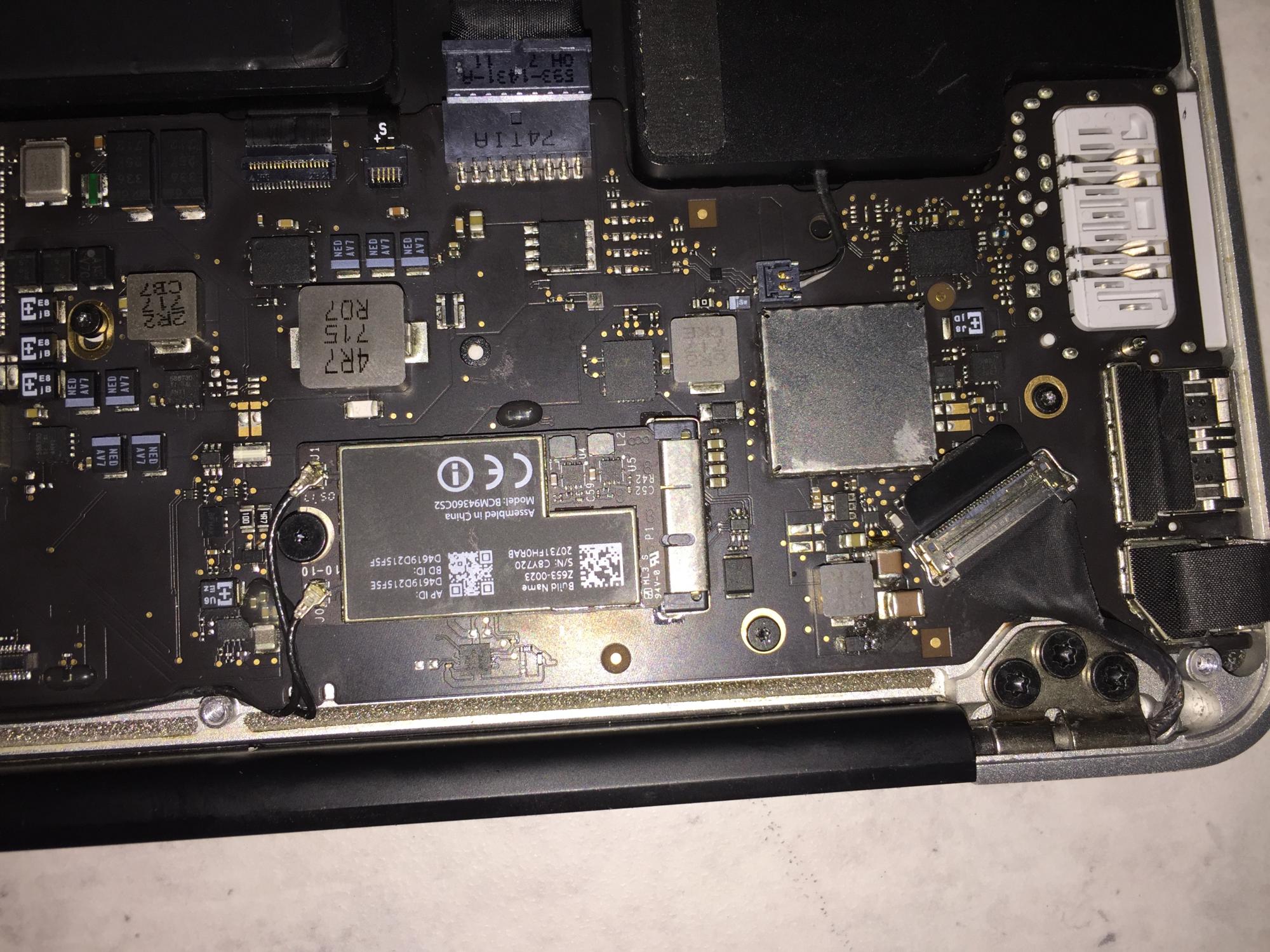

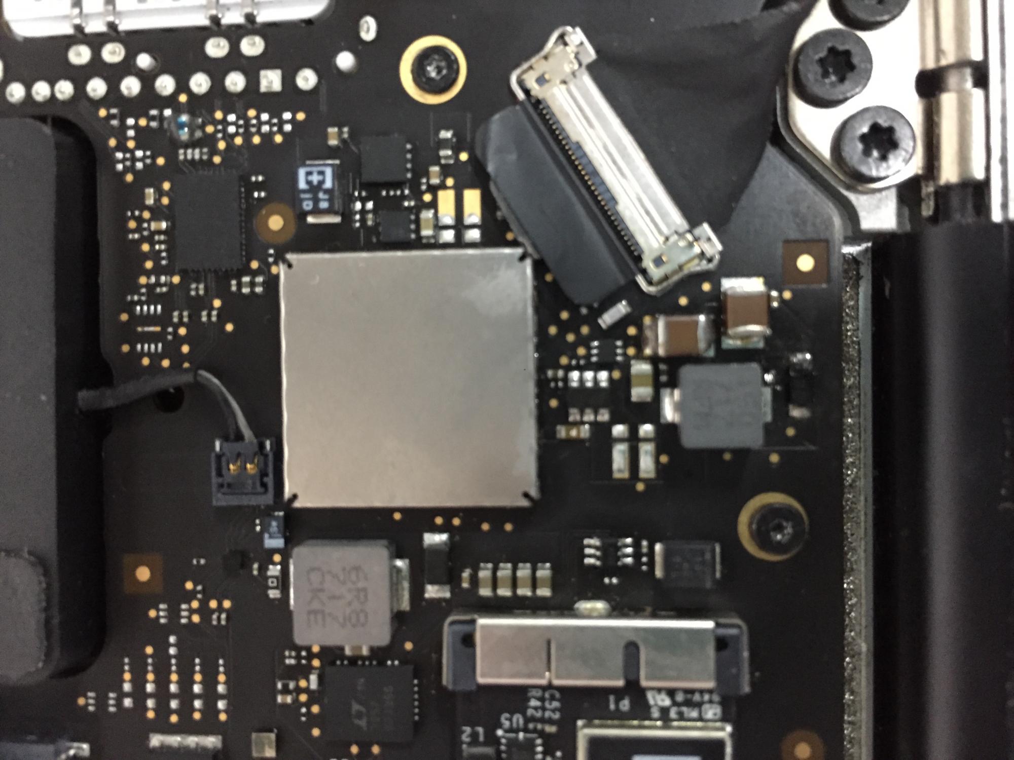

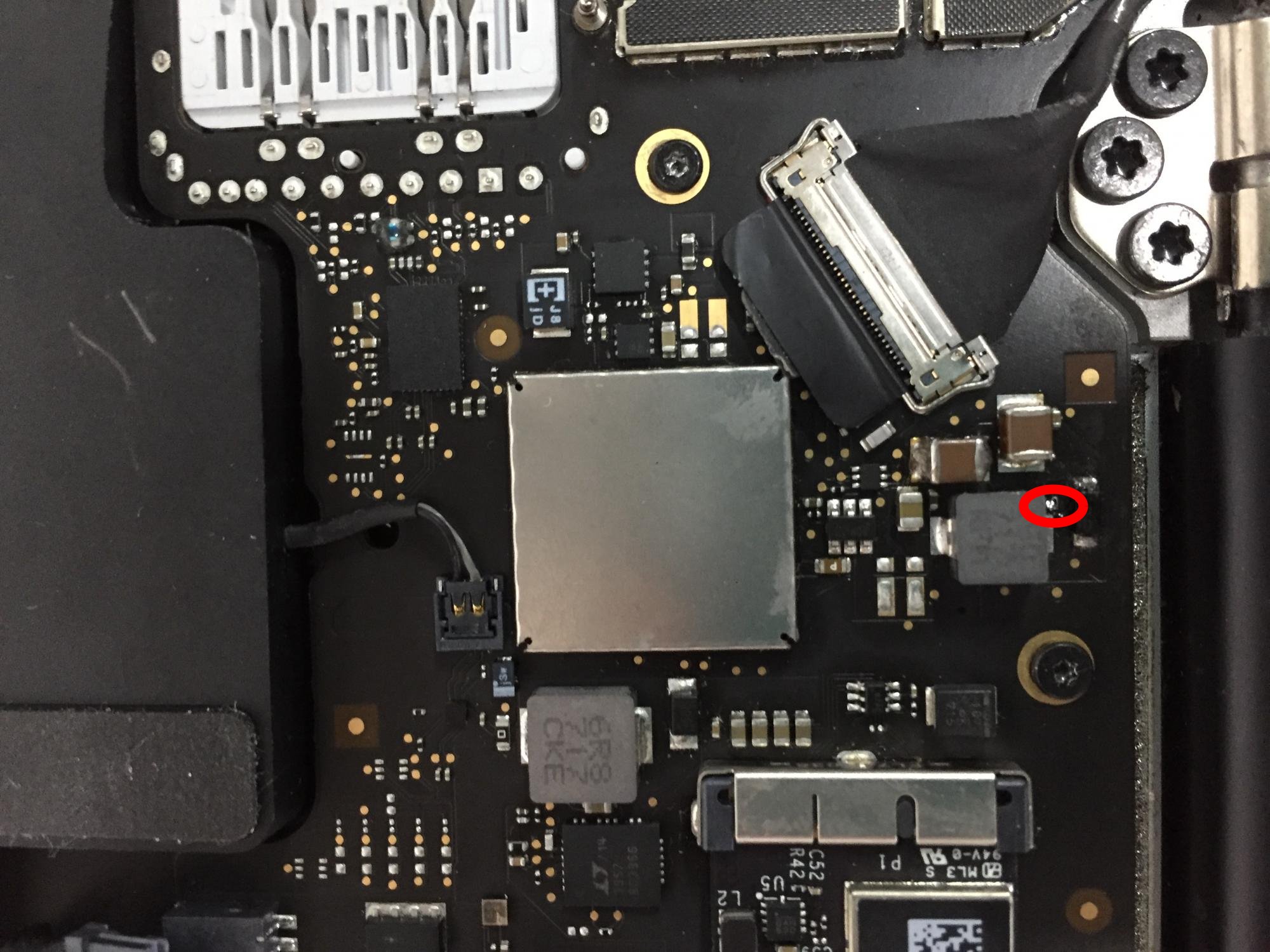

    My lovely fellows, I have MacBook A1466 with no backlight, checked the fuse it working, it got 12v on both sides, the output capacitors have 8.6v, is that okay, I have no backlight on the screen please help my, PIN number 3 and 4 on the screen connector are PPVOUT SW LCDBKLT both are connected and have 8.6v
    Please guys kindly find attached photos and boardview photos

      The feedback via typically gets eaten away after liquid damage. Cannot see much on the picture, but something is going on there.

        the feedback was not touching the other side of the board, thank you so much
