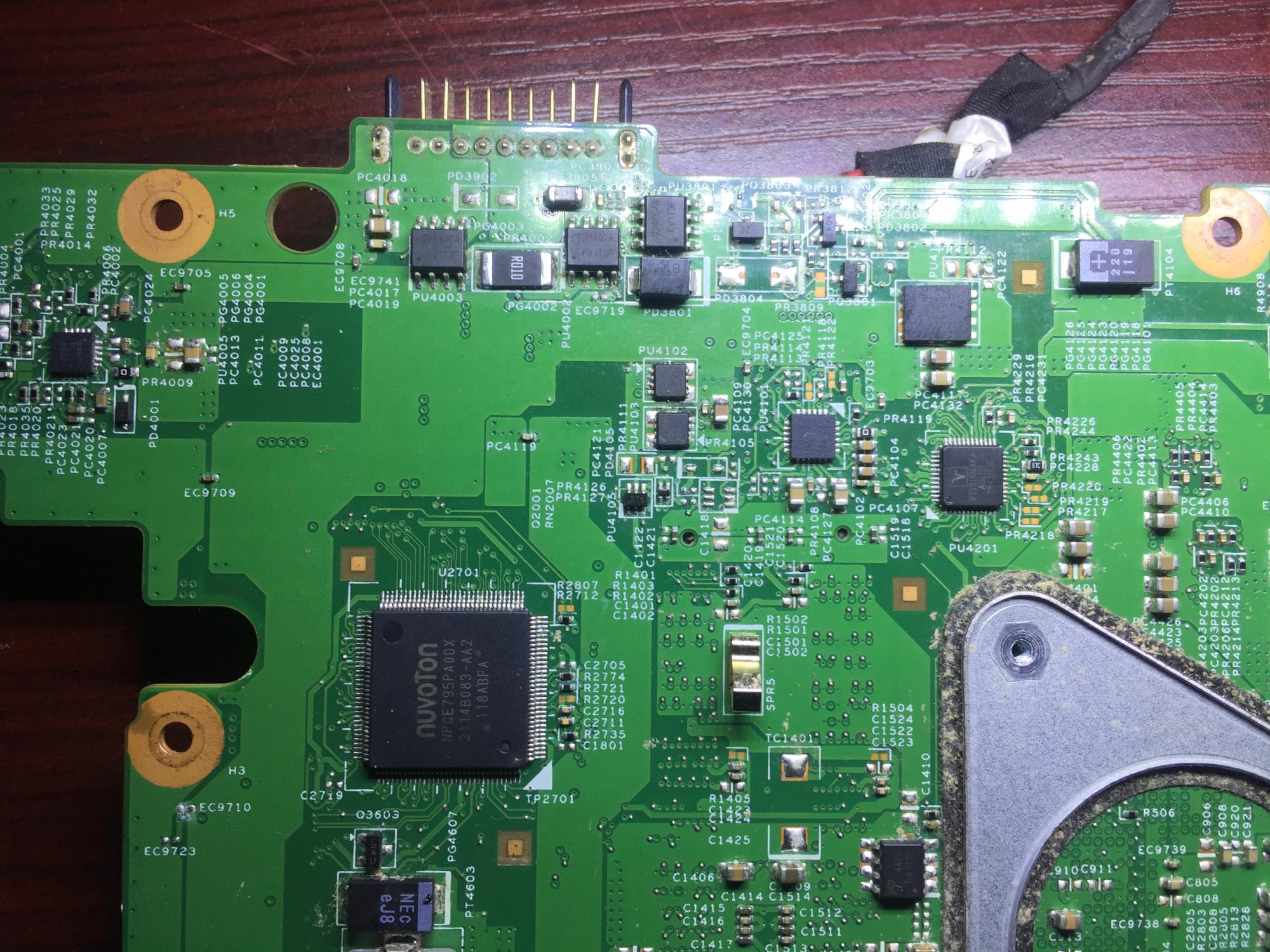

    Hello, please I need help, I have a mb that I'm working on dell n5040 part number xf5901 24p... I've checked all the coils none is short to ground.... 19v is present but on the 5v coil I get 2.4v and 3v coil I measure 0.13v ..... I tried to trace back the problem with the help of schematic but I'm stuck, no 3.3 aux volt present and having difficulty finding the origin

    Do you mean 3D3V_AUX_KBC?? If it is so then you need to check Q2703. You need to check page 27 of schematic where run power and psl logic is described. IF it is 3D3V_AUX_S5-then check tps 51125 ic. Since you are not having 5v/3v on coil , i beleive your problem lies in tps 51125 or related components.
