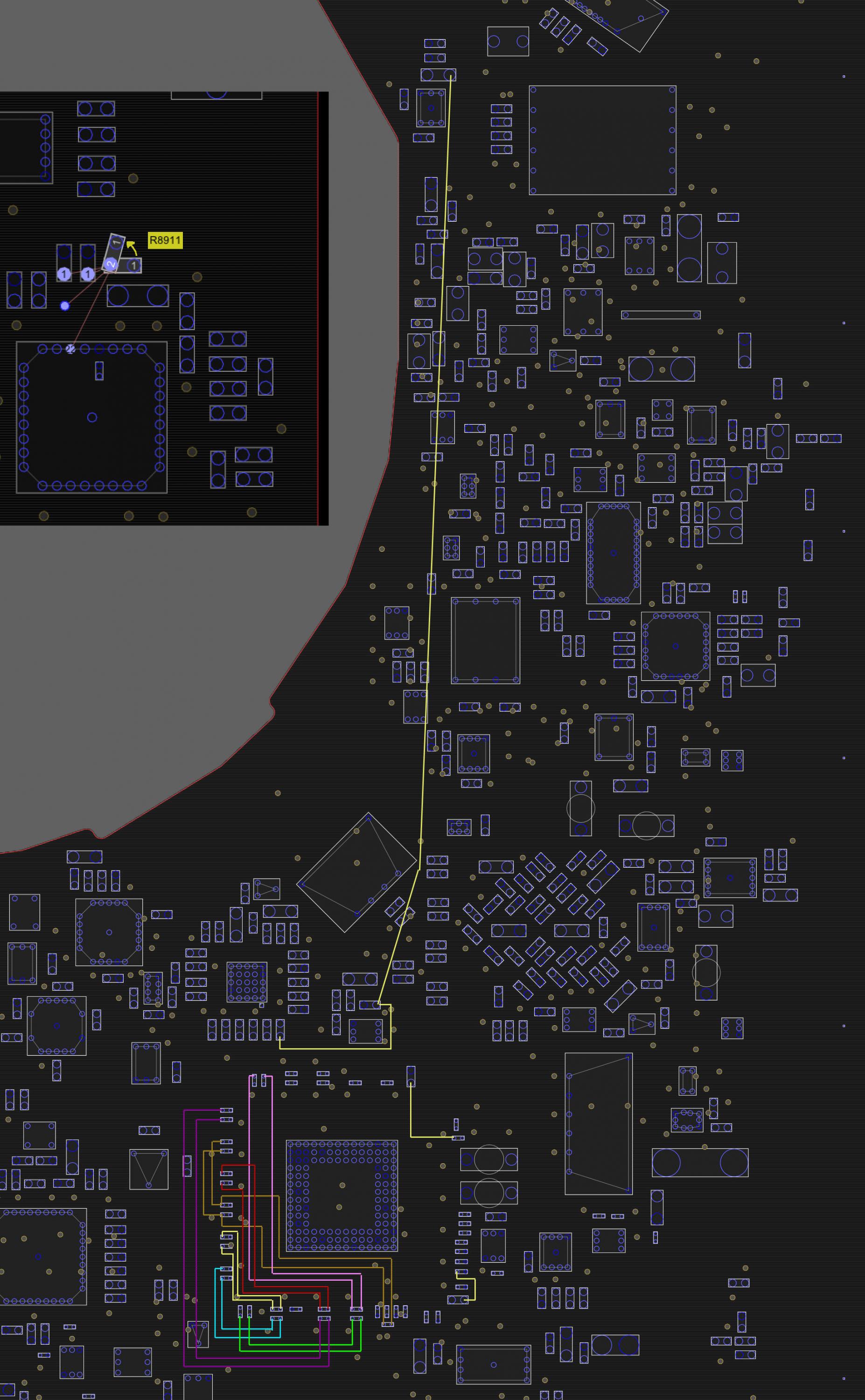

    Hello all my friend i want help about Macbook A1286 i want to disable Gpu as i know is possible now have expert macbook here can do this before this model or success any body wait for reply thank you.

      This will reprogram the gmux (graphics multiplexer) FPGA.
      The AMD GPU gets completely disabled.
      [URL="https://************************mux[/URL]
      You'll need a Lattice JTAG programmer for this. You can get them for around 20$ on Ebay.
      He wants 20$ for a license to flash one Macbook but I think it is a fair price since it works perfectly fine. There is a huge thread on MacRumors about this.
      I'm in no way affiliated with doslab/dosdude1! I don't know him and I just want to spread my information as this is the only solution that works permanently.

          Keep in mind that you lose brightness control and you can't connect external displays after that. Be really careful when soldering the JTAG connections. The pads rip of the board just by blowing at them.

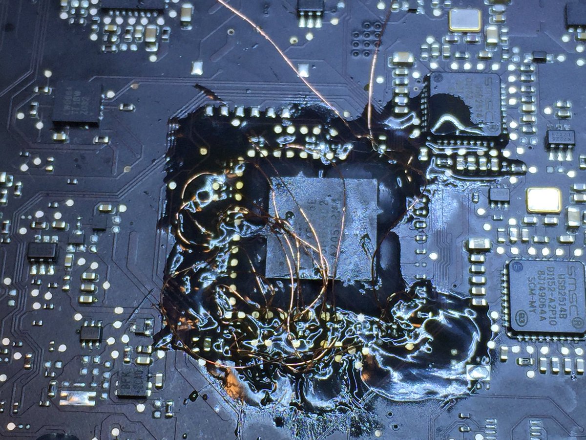

            Have 1 more methods like jumper have idea i see pics its working his methods?
            Here pics
              Re: How to Disable Macbook Gpu A1286
              Here pics
              Reprogramming the gmux does the exact same thing. Just in software form. And it looks way cleaner.

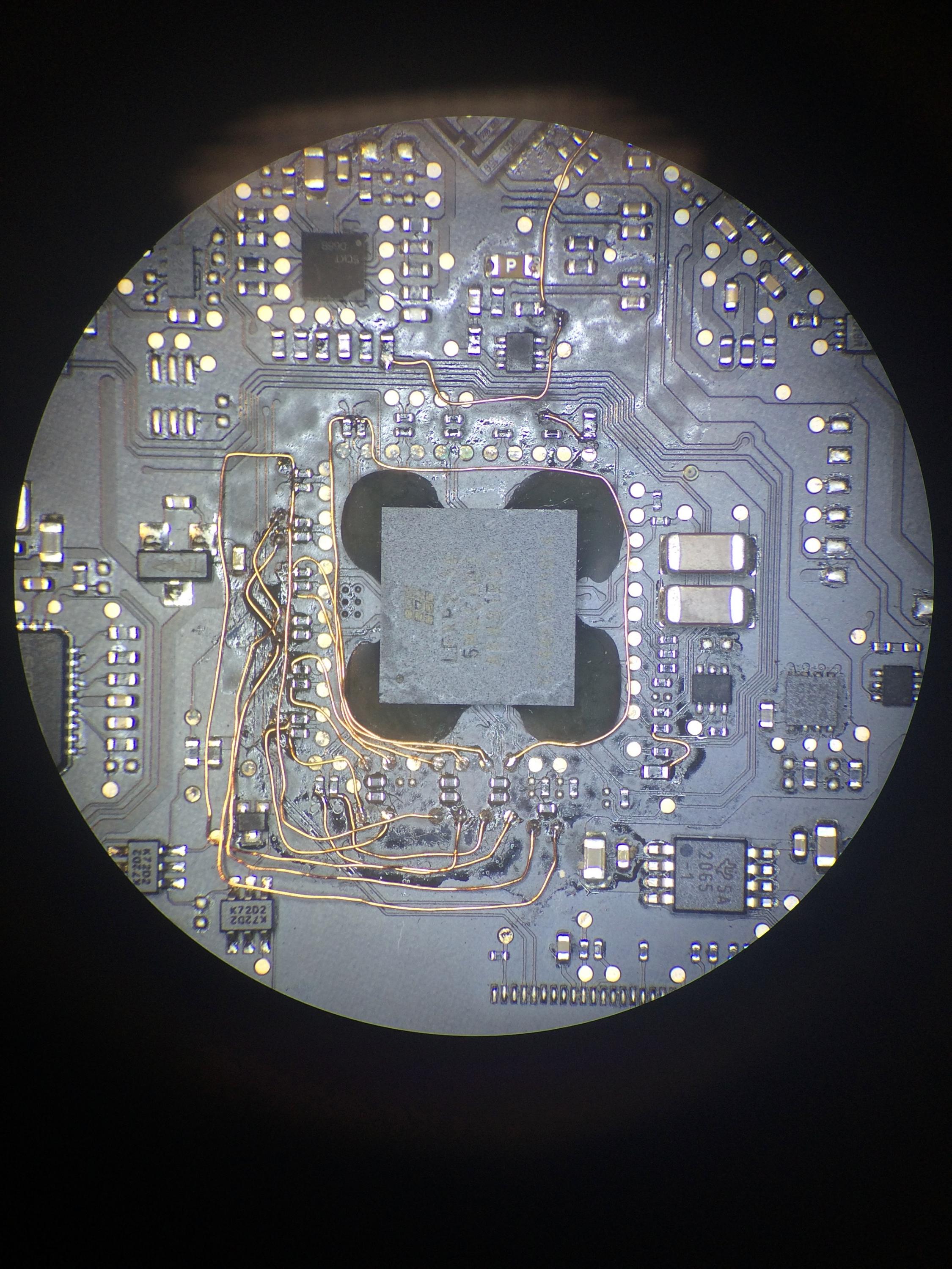

                Now we find this another
                https://forums.macrumors.com/threads...2134019/page-2
                i am good for soldering iron...

                  If you want to hassle with all those jumper wires go ahead. I'd prefer the jtag programming solution. You only have to solder 6 wires and do one click.

                    Thank you for information now i can we success use this pics
                    But brightness no clear as original little bit different..

                      Good job. Does it work?
                        100% working again thanks dear your support

                          Perfect! Glad it works.
                          How long did it take?

                            About 30 mint but have many jump cable
