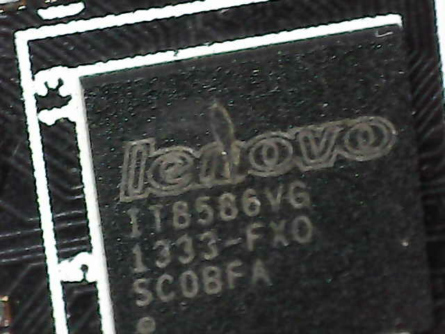

                                    I know this is an old thread but i think it could be useful for the next one which is/willbe searching for an answer.
                                    The author of this thread mentioned that the board was getting hot 🔥 but he never found the orgin of the defect .... but I think it could be the same defect like mine .... So I was searching with my microscope on the board for burned things and so I can put my multimeter perfekte on the contacts without shorting them as I saw next to the battery plug an IC CHIP which is directly from lenovo when i was about to get to the next thing so i can check it i saw a very strange mark on it i wanted to wipe it away but it was to hard so i used a very thin tweezers which was almost thin like a needle......as i was scraping of the dirt i saw it was a hole ..... so my dann ic is burned away an i can't use this laptop....
                                    So what now? As i searched for the IC i found it but also noticed that has to be programmed the i will be able to use the IC ..... which means for a guy like me it ain't possible to reprogramm it without a proper proammer.....
                                    • Tha_untouchable
                                      • Sep 2023
                                      • 3
                                      #58
                                      Re: Lenovo Yoga 2 Pro 20266 Stuck in sleep mode
                                      Here is the picture of that damn thing
                                      • Sephir0th
                                        • Oct 2020
                                        • 1289
                                        #59
                                        This is the embedded controller and normally the board can't reach that far in the power up-sequence with a defective EC. For this reason I would assume another fault in your case.
