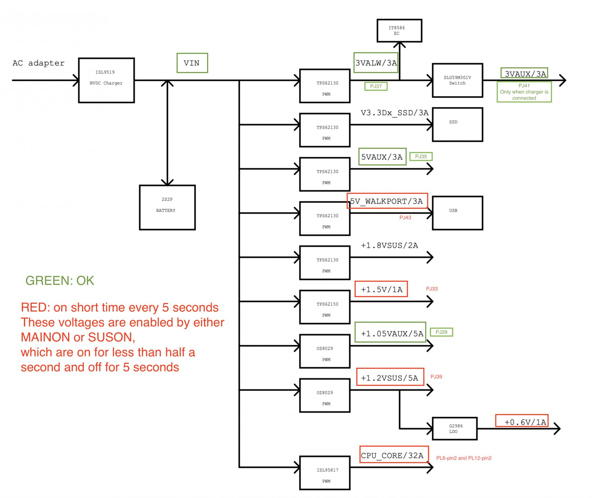

                    Attached an image from the schematic. I have marked the voltages who are ON with green, and those flickering with red.

                      Yeah it is power cycling.
                      Please measure +1.35VSUS.
                      Can be measured at PL9, PJ39 or TPF106

                        The +1.35VSUS is indeed +1.2VSUS/5A on the power diagram (from the schematic). It is misspilled.
                        Beside it I wrote in red (maybe too small) "PJ39".
                        It is recycling like all the others in red.
                        It is hard to finde TPFxxx, or any component designations on board. It is black board. Only Diodes, coils ICs - no discrete components. That is what is doing it very hard to diagnose.
                        All the green power voltages are either direct from VIN or enabled by AUXON.
                        All other red marked voltages are enabled by either SUSON or MAINON.
                        Both SUSON and MAINON are power cycling.
                        +3VAUX is present, but almost all logic are powered from +3V rail, which is power cycling.
                        If I connect all cables and duaghterboards or I separate the main board, I get same result.

                          Maybe Iam wring, but what I understand from the schematic, it is the IT8586 whom is generating the SUSON and MAINON signals?

                            OK.
                            Reflash your bios chip.
                            If all power rails are fine and have the expected voltage then it is most likely your bios. You mentioned that you can only shut it down by holding the power button for some seconds while on charger. correct? This is also a symptom of a corrupted/missing bios. Could be something else like a dead cpu but I highly doubt that.
                            MAINON and SUSON are outputs of the EC. It will power cycle the board if it can't read the bios rom or if it is corrupted.
                            Either you have a bad EC or a bad Bios. Everything else should be fine.
                              Correct. Dont try to pull them high by injecting voltage or do something else with MAINON and SUSON. Killing your EC (IT8586VG) would be bad news since it is a BGA Chip and would be a pain to replace.
                              I've already had a dead EC but it is really rare from what I experienced. Most of the time the bios flash is just corrupted. Maybe the owner did a bios flash and decided to restart it or flashed a wrong bios? Who knows... Always think of the dumbest thing people could do to it. If it doesn't have water or other physical damage it's most likely some software (bios) related thing.

                                    There is no sign of water nor physical damage.
                                    I have measured all power rails and could not find any short to GND.
                                    I was afraid of injecting power on power rails not to blow the EC, CPU and anything other. At work we have the HP Agilent power supply with current limiting as in attached picture.

                                      There is no need to inject voltage into the board at this point since all power rails seem to be ok. Could be some current sensing circuit but I doubt that. Injecting power only makes sense if a power rail is shorted and you can't find the bad component. This is not the case here.
                                      The Yoga is just power cycling. I guess a reflash of the bios will do the trick.
                                      The EC should be fine since it does do something. A dead EC would usually prevent the board from starting at all since the power button is connected to it. Do you have access to an oscilloscope? You could monitor the SPI data lines on the bios chip.
