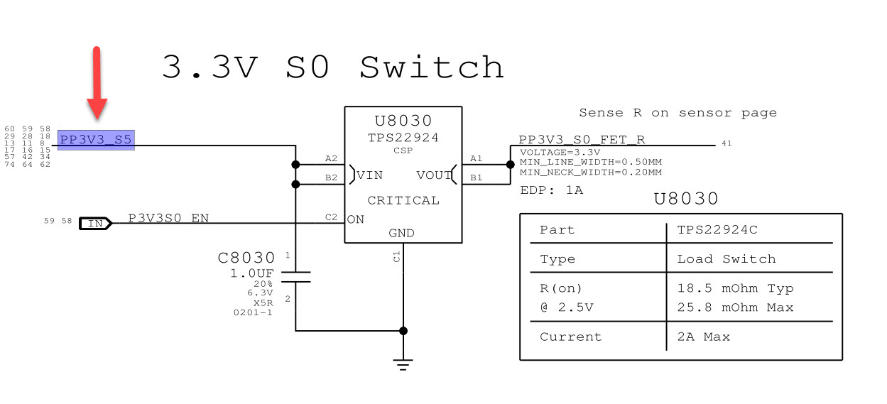

        Hello, I have the same problem, but I am not sure what is wrong, I suspect PP3V3_S0 because it has a voltage of 0.5V, but I also do not have a voltage in ALL_SYS_PWRGD
        I leave my readings in Q8150
        pin1:_0.77V
        pin2:_Unconnected
        pin3:_0.11V
        pin4:_0.10V
        pin5:_1.10V
        pin6:_3.16V
        pin7:_0.16V
        pin8:_Unconnected
        I hope you can help me.

          Re: Apple MacBook Air 820-00165 no PPVCC S0 CPU
          Remove all power. Meter in resistance mode.
          Measure the resistance to ground of PP3V3_S0.

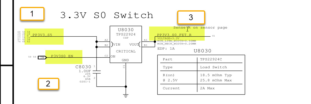

              Ok. Good. So you do not have a short on this rail.
              See attached. Confirm the voltage values of points 1, 2 and 3.

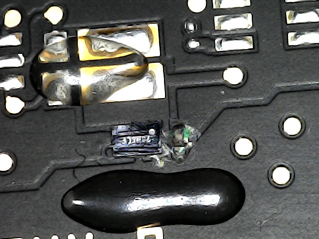

                I found rust in that area in that area
                  Pin 1 and 3: 0.51V
                  pin 2: 0V
                  I measured it without cleaning the rusty area

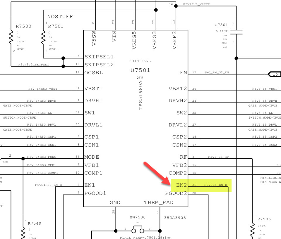

                    See attached.
                    Confirm the voltage of EN2 (P3V3S5_EN_R) pin # 21 on U7501.
                    Clean up the area with alcohol to see if this improves the readings.
                      See attached.
                      confirm the voltage on EN2 (P3V3S5_EN_R) pin # 21: 3.41V
                      I will cleanup and confirm
                        Good ENABLE voltage for U7501 yet the output is still not valid.
                        Confirm the voltage @ L7560, pin # 2 (PP3V3_S5_REG_R).
                        If this voltage is not ~3v3, check for a short on this rail as follows:
                        a) Remove all power.
                        b) Meter in resistance mode.
                        c) Check the resistance to ground of L7560, pin # 2 (PP3V3_S5_REG_R).
                                Check the voltage again for U8030. Earlier post has this at ~0 volts.
                                  I cleaned the oxidized area and the capacitor came out in pieces, now it gives me 0V, or it has no continuity
                                    Ok - you have at least a broken trace to this load switch.
                                    This part (U8030) is acting like a solid state relay. When the C2 pin (EN) is logic high (~3 volts), this switch will pass the INPUT voltage (pins A2/B2) to the OUTPUT (pins A1/B1).
                                    However, the PP3V3_S5 rail is not reaching this IC.
                                    Need to check the P3V3S0_EN at other locations on the logic board.
                                    What is the voltage ?
                                    So in summary, P3V3S0_EN = ~3v3 volts & PP3V3_S5 = ~3v3 => will turn on this switch to power downstream devices which are required.
                                      Voltage on P3V3S0_EN = 3.3V
                                      i will resold and clean U8030 and put the new capacitor (C8030)
                                      Edit: the rail on (C8030) pin#1 whit conection on U8030 pin #2-4 broken.
                                        I replaced the U8030 that was broken and now it turns on fine, thanks for the help!
