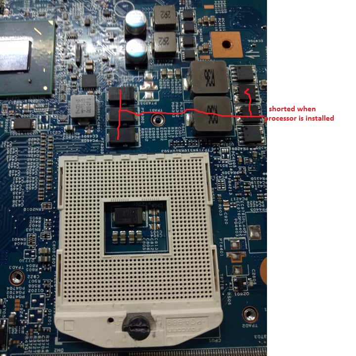

    shorted mosfet and capacitor if processor is installed common in i7 and i5 series
    i encounter it in i7 and i5 series laptop, the mosfet and caps are shorted when i installed processor.

    Re: shorted mosfet and capacitor if processor is installed common in i7 and i5 series
    CPU VCore (and a bunch of other power rails) will always have low resistance to ground with the CPU on the board.
      @piernov how to test if low resistance to grounds. ( is that the very small black resistor) should i replace them all.
        How big is the resistance?
        I think a value of about 1-2 ohms is normal
          normally in diode mode the value must not be 0000 other values could be acceptable, for example 0003 <i7-6500U <0007.
            In diode mode meter can show 0.000. I personally don't use diode mode, I always use resistance mode, and for example Ivy Bridge mobile can show 1.5 ohm and it's fine. Some high-end desktop CPU will be lower than 1 ohm, some desktop GPU too. Never assume you have a short to ground on a high-power low-voltage rail.
              so guys it more than one resistor? it doesnt need to take off the resistor to know the resistance? right? i'm repairing laptop and i always failed to fix that kind of problem. thank you guys for guiding me.
                in this case we are checking if the cpu is not shorted and more precisely we are checking the power of the cpu (+ vcore) we are not interested in the exact value of the resistance and this does not give us any indication that it is definitely working.
                as regards the single resistor it depends on how it is positioned in the circuit.
