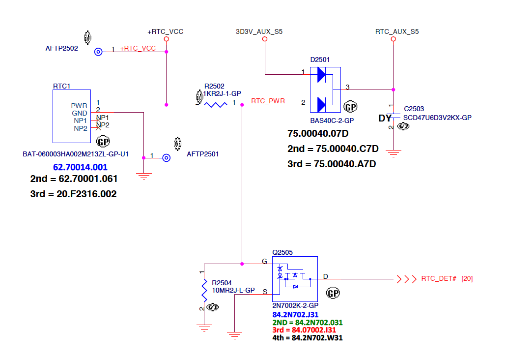

    the laptop is dead:
    no power:
    5v and 3.3v are present
    3v on power switch is present
    volts on charging battery are present
    volts on bios are present:
    when i press the power button, the volt on it will be 0
    i reflashed bios but the same error
    no evidence of life
    any help please

                Check RTC_RST# at G1901 located near cpu.Check D2501. Moreoften then not, this mb doesnt switches on coz of RTC circuit failure while evrything seems ok. That may not be the case here but do check them. RSM_RST present on SIO??

                      Re: dell inspiron 15 3542
                      q1901 has 3.118v on drain and 0v on S and G.
                      d2501 is good
                            i am facing exact proble No voltages at D2501 s-d-g 0v only

                              I have a dead one , too .
                              I have 3V at D2501 .

                                1) Voltage on pin # 1, 2 and 3 of D2501 ?
                                2) Voltage on R2502 - both pins ?
                                3) Remove all power and check the resistance to ground on each and every coil. Searching for very low resistance on the respective power rail. Some CPU / GPU rails will be low resistance and that is normal.
