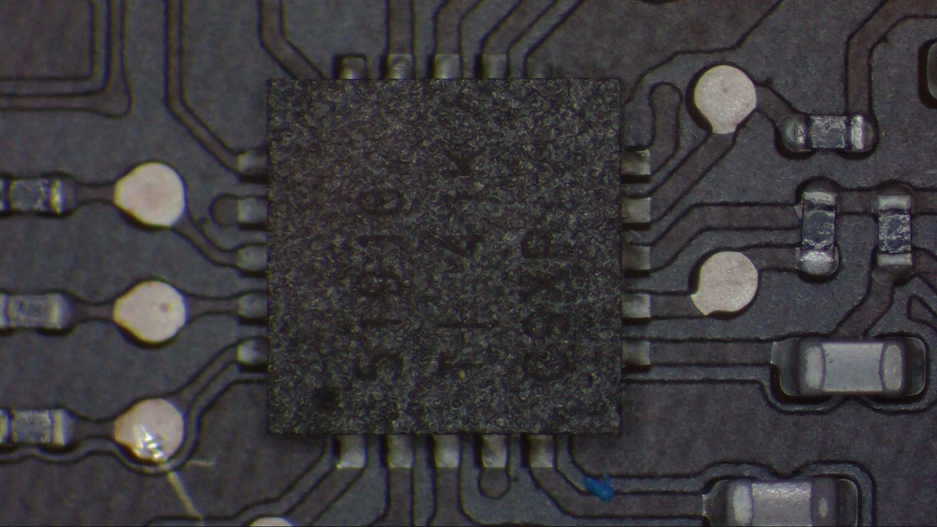

          • FrozenHaxor
            • Jun 2015
            • 260
            • Poland
            Re: Macbook Air A1466, 820-3437 S0 present but doesn't turn on
            I think U7400 has a hole in it, doesn't seem right. Will investigate more.
            • piernov
              • Jan 2016
              • 4437
              • France
              If you're missing PP1V2_S3, that's indeed an issue. Measure resistance to ground on that line.
              I don't see anything wrong with this chip, although it could still be the culprit if there's no short to ground.
                  Ok, so on U7400, you get 5V on pin 12, 3.3V on pin 16, but nothing on pin 13? And no short to ground?
                  Looks like U7400 itself is bad then. There are a few passive components around it, but it seems like there is no damage around the IC so it's unlikely that they are bad.
                  • FrozenHaxor
                    • Jun 2015
                    • 260
                    • Poland
                    That is correct. Just replaced U7400 with brand new one, and it behaves in exactly the same way as the old one did. Perhaps the inductor driver is bad? I do not detect a short to upper rail nor to ground on those integrated mosfets, gates do not appear to be shorted either. This is very odd. Sadly I cannot swap CSD58873Q3D with another one on this board since the other two appear to produce 5V and 3.3V rails which are needed for the 1.2V rail to work. It could prove though that the 1.2V rail one is operational if I swap it in place of the 3.3V one. I also seem unable to buy that part in my country.
                    Swapped Q7430 with Q7520 - the result is that 5V rail is still good and the 1.2V rail still doesn't work, so the CSD58873Q3D from 1.2V circuit is good.
                    Measured all passives around U7400 - all checks out according to schematic.

                          • FrozenHaxor
                            • Jun 2015
                            • 260
                            • Poland
                            It is really odd indeed, like everything is okay but the IC does not start. I will put the board through ultrasonics. It has been in another shop afterall and they had a go at it giving up in the end - who knows what they did, no soldering signs only probing marks. When taking the shields off I noticed slight staining like dried water, perhaps it had some liquid damage before and they did not take shields off for cleaning leaving some residue - or its factory like that. I genuinely do not see any damage or etching myself. Will see after the ultrasonic cycle, tank is heating up.
                            Still no change after thorough cleaning. Board is spotless.
                            R7450 is 0.01Ohm
