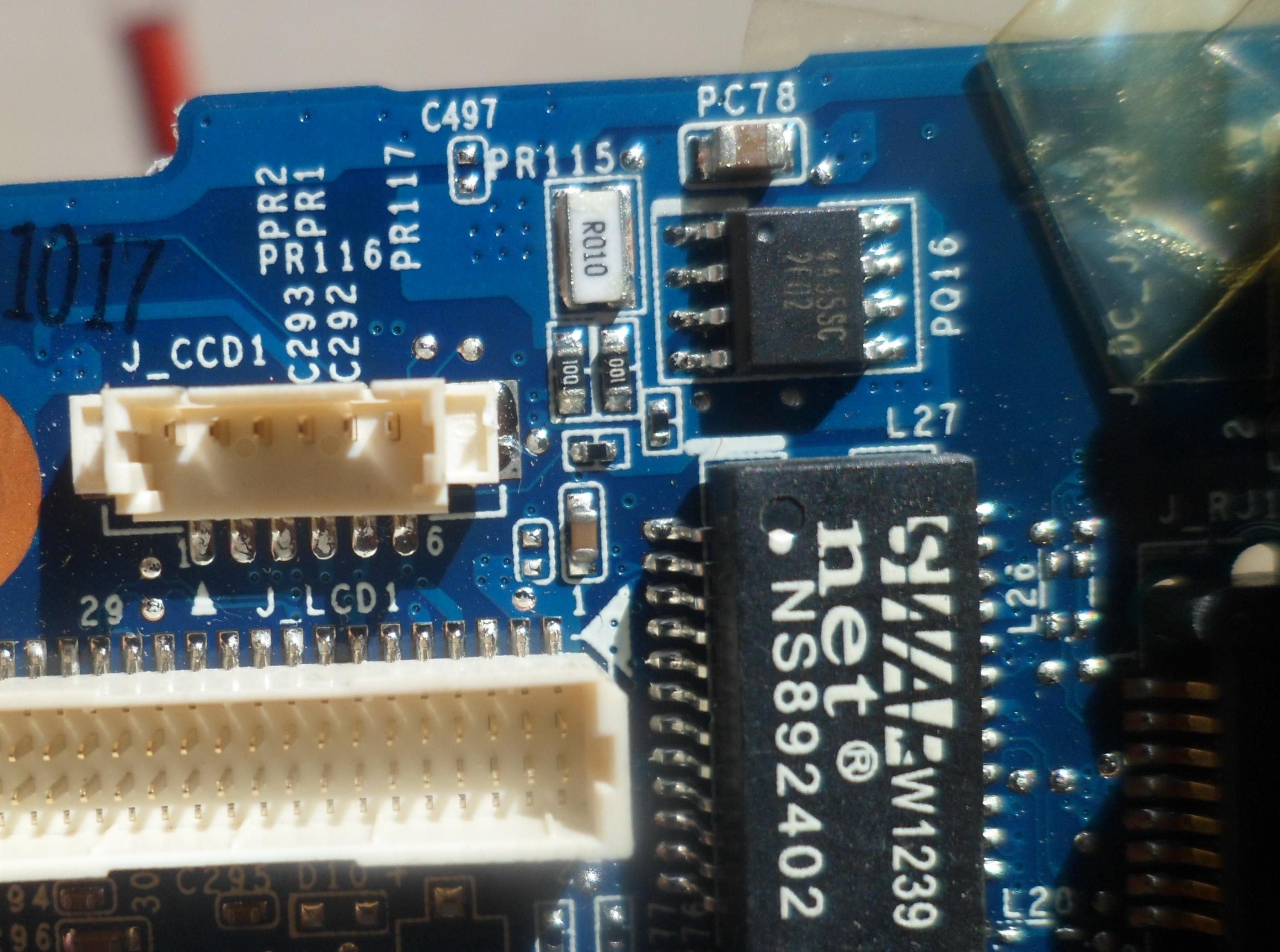

    need Compatible ic 4435SC
    Hi
    i need a equivalent ic for 4435SC
    thanks
  • anshad
    • Nov 2010
    • 249
    Re: need Compatible ic 4435SC
    That is not IC but ''P-Channel MOSFET''.
    https://cdn.badcaps-static.com/pdfs/...4a1d1827fc.pdf
    You can use other P-Channel MOSFETs like 4407 or 4409 instead. Usually easily available from spare/scrap motherboards.
      thanks anshad
