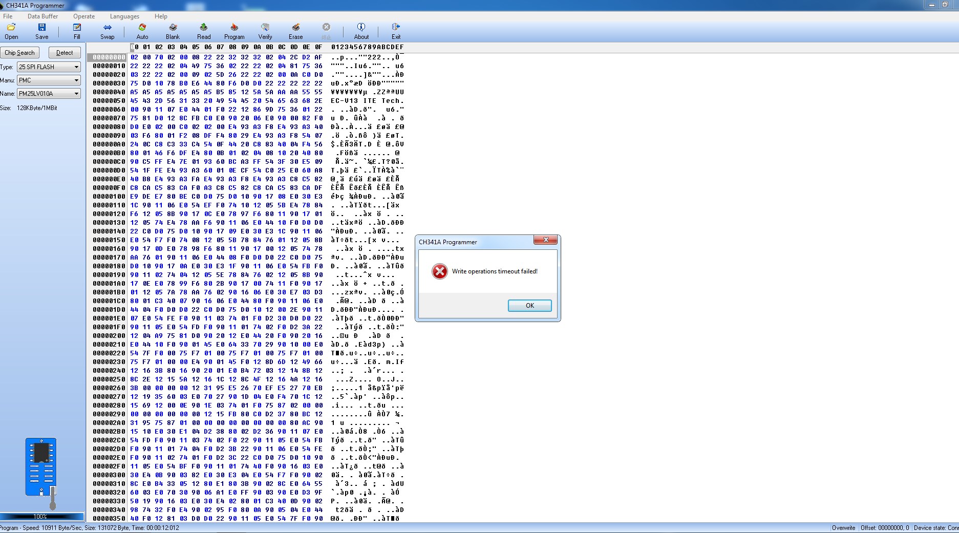

    I got a serious problem i try to flash ec bios from a Acer Travelmate 5744
    model bic50
    I did everything they way it should be but with writing to the chip i get message Write operations timeout failed ( look at picture)
    i write with a CH341A pro programmer .
    he also not accept the backup bin i made i got the same error
    I hope somebody has a solution big thanks infront

    You chose the wrong bios chip. The 5744 has a 4MB bios.

      He's trying to flash the EC SPI ROM, which is a 1Mb chip.

        Yes thats right i already did the 4 mb chip that went okay but the ec chip doesnt want to be writen i did a read and back up but when i wanne write it it give the error
        i dont think it wil work with a blank ec chip
        if somebody knows the solution i wil be thankfull

          Yes my mistake ,"flash ec bios" . It seems the chip faulty and needs replacing with a new one.

            Yeh agree with smdflea. If 4mb bios writes perfectly then nothing is wrong-so has to be ec bios chip itself

              thanks for the help i first did an install of another version of the software but it gives now the message acces violation at adres 0097ea42 read of adres 0099ea42 so this time he try to read the chip
              better try a new chip

                im getting the same error check the image if any one got resolution please let me know

                  mostly it is badly soldered contact on ic or chip is 1.8V

                    Thats right.If the chip pins are not soldered properly onto the programmer you will be getting this error.

                      Hi use
                      Neoprogrammer or colibri much better support more chips .

                        Thanks a lot, its working..

                          you are amazing
                          worked like a charm
