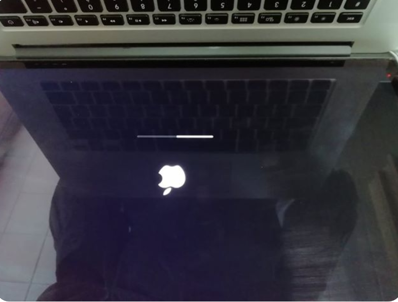

    MacBook Pro A1398 (Retina, 15-inch, Mid 2015) 820-00163-A crashes at half boot screen
    No graphical? picture?
    System starts but reboot/crashes about half the booting process, see picture.
    Laptop was very hot. (closed lid?) when it broke.
    It has a lot of dust in it and it has a protection case on it.
    Battery was expanded too, and must be replaced.
    I do this testing with power cable and without battery connected.
    PM_ALL_GPU_PGOOD is 3,3
    What can be the reason?

    Re: MacBook Pro A1398 (Retina, 15-inch, Mid 2015) 820-00163-A crashes at half boot sc
    Try known good battery first. This model may need a good battery to boot. (820-00426 needs one for sure)
      indeed the 2015 ones dont boot without a good a battery. had one that was completely dead with the power adapter and after checking the battery was shorted. With a new battery it worked like a charm!
        With new battery, the laptops boot, with picture. However the dedicated VGA BGA is not in use. The PM_ALL_GPU_PGOOD = 3V3 while startup, but when he uses the VGA driver? the PM_ALL_GPU_PGOOD comes to nul.
