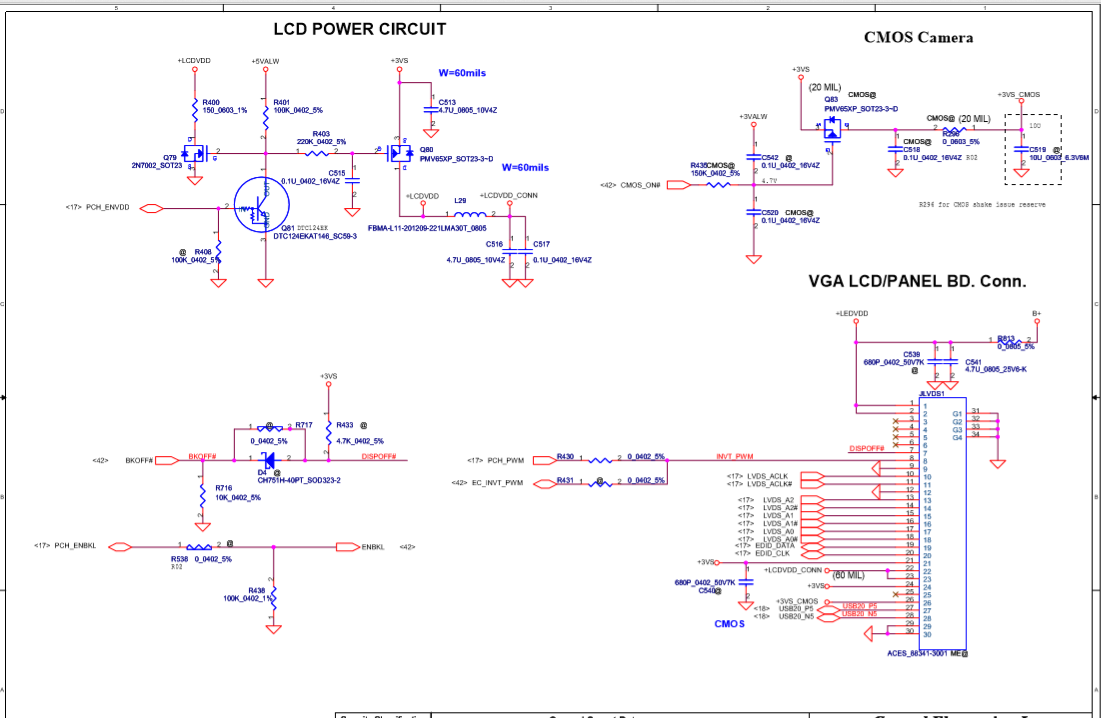

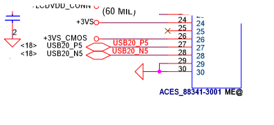

    I am currently repairing a motherboard LA-7981P in a Lenovo G580. The problem i have is there is no graphics on the screen, there is light, just the normal light, not bright light like when the connectors isnt in properly. I get external graphics and laptop works normally on HDMI monitor. I have a schematic for this model and have checked the pins on LDVS connector. I have attached the page from the schematic i believe is relevant to this and a clip of the diagram where i believe i have the problem. I have voltages where they should be present apart from pin 26, this is dead, not sure what other readings i should be getting or how to check. Hoping someone will be able to help with this.

    so you get +19V on pin 1 2 , pin 21 +3VS pin 24 +3VS pin 26 +3VS , PIN 8 ?

      Thank you for your quick reply. Checked all above, all OK. Pin 8 =0V

        now check EDID_DATA/CLK pin 19 20 , this model needs lcd inverter if so try with another one, for the pin 8 of LVDS test R430 R431 both sides for voltage , what was the voltage on pin 22 23?

          Pins 19 & 20 have 3.3v Pins 22 & 23 0v
          This model doesnt have an inverter (A long Board under screen) or is it something on motherboard im looking for.

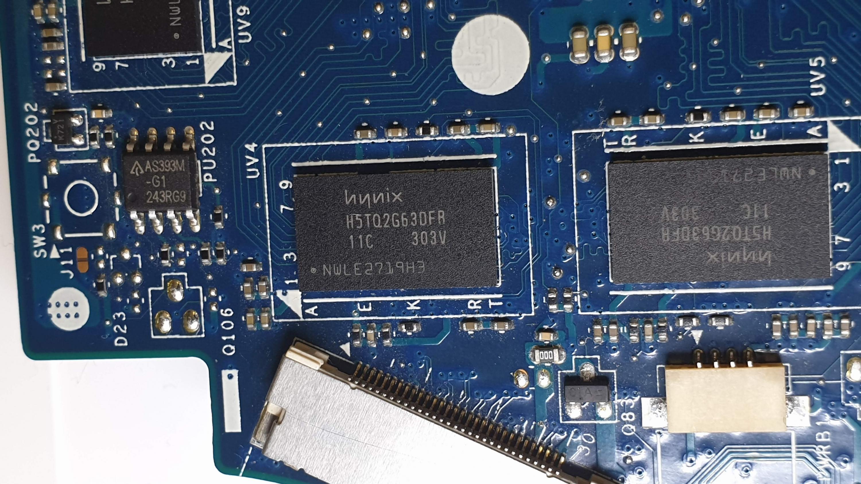

          I do have a microscope, how do i locate R430 & R431 cant see them.
          Are they visable on this photo

            Re: Lenovo G580 LA-7981P
            did the measurement on pin 8 22 23 was done without the screen attached ?
