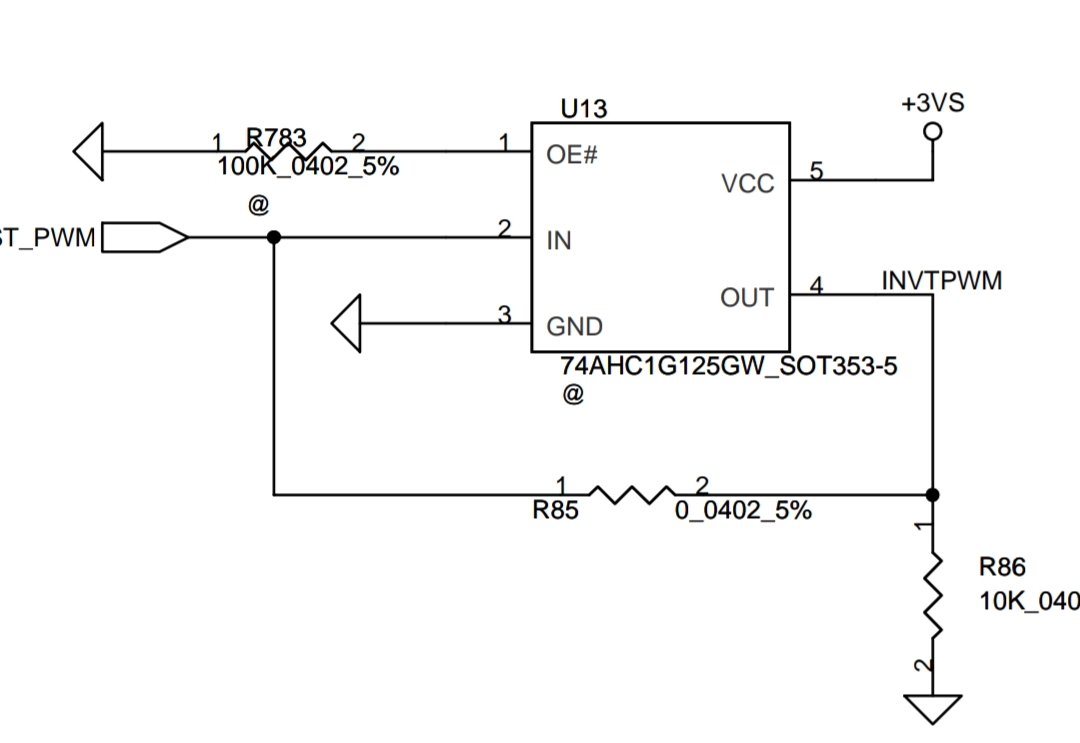

    HI
    i have a labtop acer e1-531 with no display issue
    but if i connect it with vga to the monitor externe hi display on the external monitor ?????? what is the problemme
    thx

    If you Mob is (Compal LA-7912P) test LVDS connector
    pin1 19V+
    pin 5
    pin 7
    pin37 Voltage did you try with a another screen ?

      Re: acer E1-531
      yes i try screen and the Flex Video LVDS Cable of another acer
      same problemme
      pin 1 19 v
      pin 5 3.3 v
      pin 5 3.3 v
      pin 37 3.3v
      thx

        Re: acer E1-531
        same problemme
        pin 1 19 v
        pin 5 3.3 v
        pin 5 3.3 v
        pin 37 3.3v
        thx
        pin 7 3.3V?
        pin 8?
        pin 10 & 11?

          Re: acer E1-531
          yes
          pin 7 3.33 v
          pin 8 0.38 mv
          pin 10 3.33 v
          pin 11 3.33 v

                  Re: acer E1-531
                  The problemme is on pin 8 must be 3.33 because when i short pin 8 and 7 the light comme but no img

                    Re: acer E1-531
                    Hmmm... i think INVTPWM is fault

                      Re: acer E1-531
                      Ok ty i will replace it and replay
