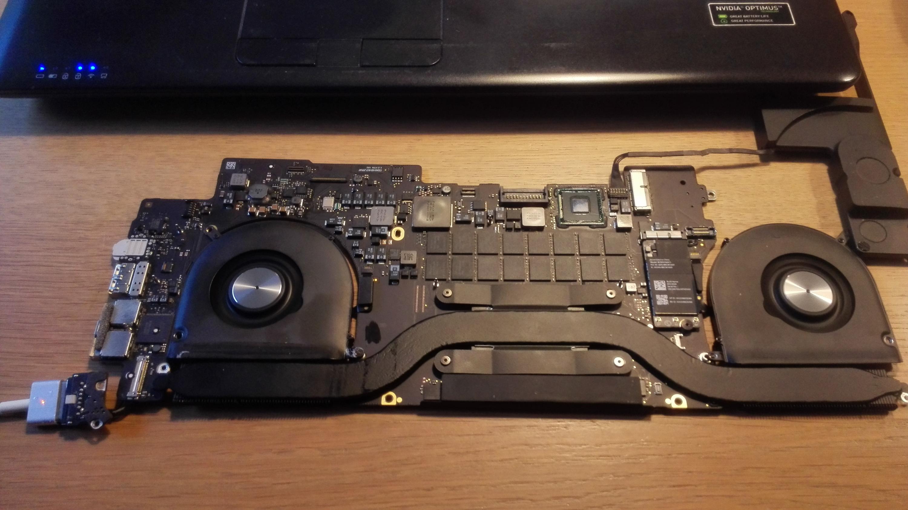

    Hi everyone,
    I have the following problem, see photo how i test the motherboard.
    Adapter start with green light and goes to orange and the fans are running directly and goes to high speed.
    I have measure a lot of points but , i don't know where the problem is. No chime and no display. Backlight is well on the screen .
    I think it is an heating problem but which components and where to look?
    I bought this macbook pro and it was with a cracked screen. I replaced the lcd but no screen only backlight.
    Can somebody help me or give some hints to look further

    Plug in mouse check if there it lights up.
    Vcore voltage?
    Check bios area
