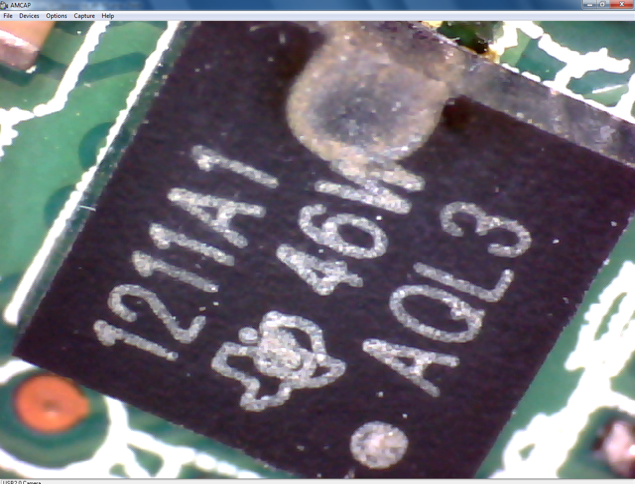

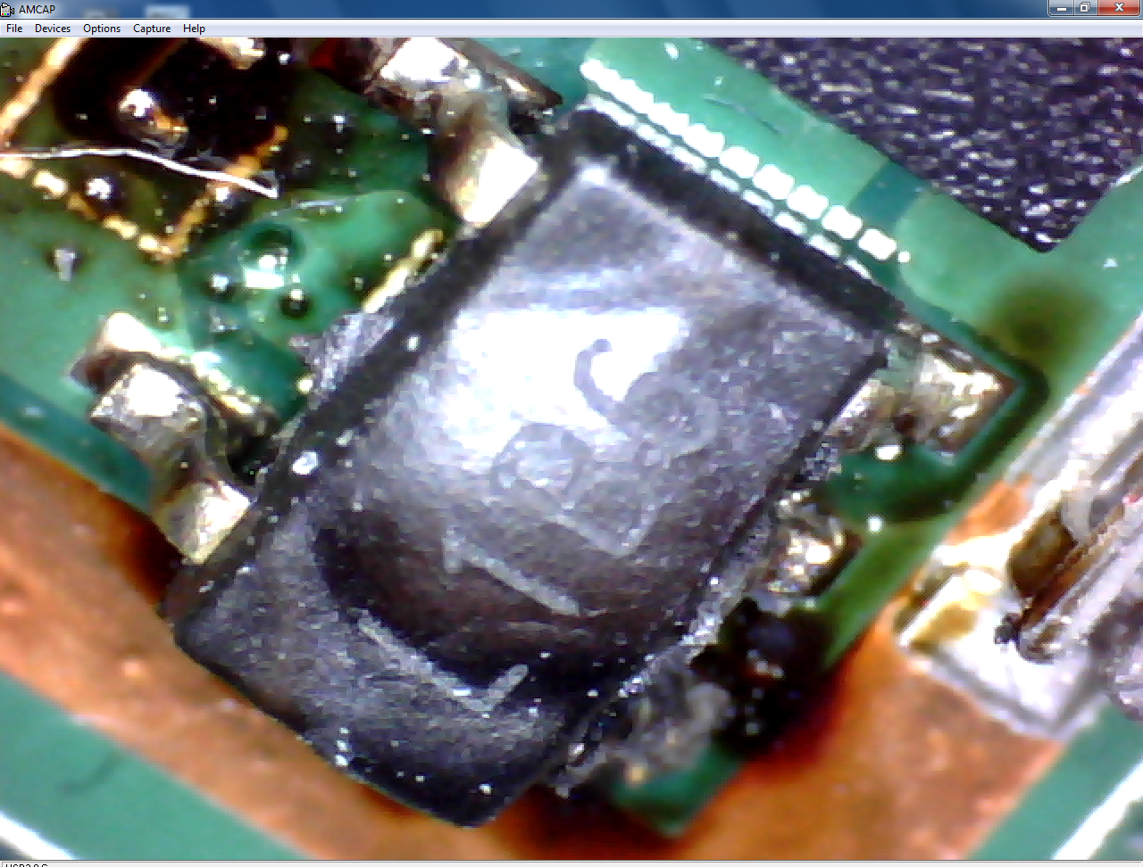

    lenovo tab s80-50L help identify burned chips
    guys help me to identify lenovo tab s80-50L burned chips

    Re: lenovo tab s80-50L help identify burned chips
    L1B6 is an Anpec APL3511B ,the other part has the TI texas instruments marking,not sure what it is .

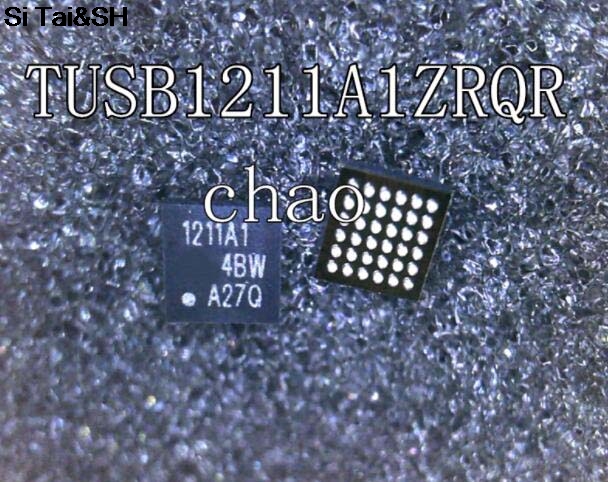

      Tusb1211a1
        so looks like a connected shorted device
