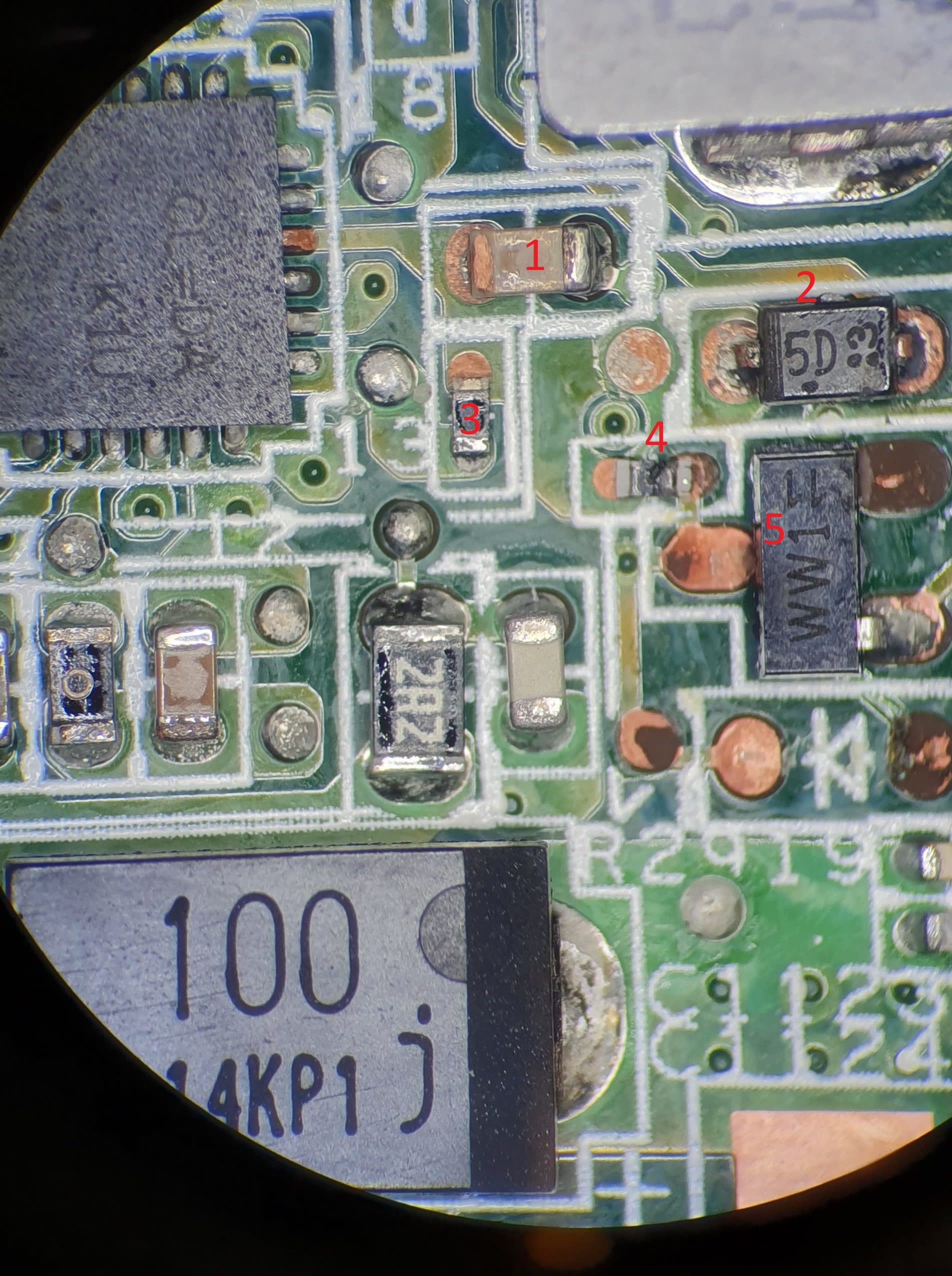

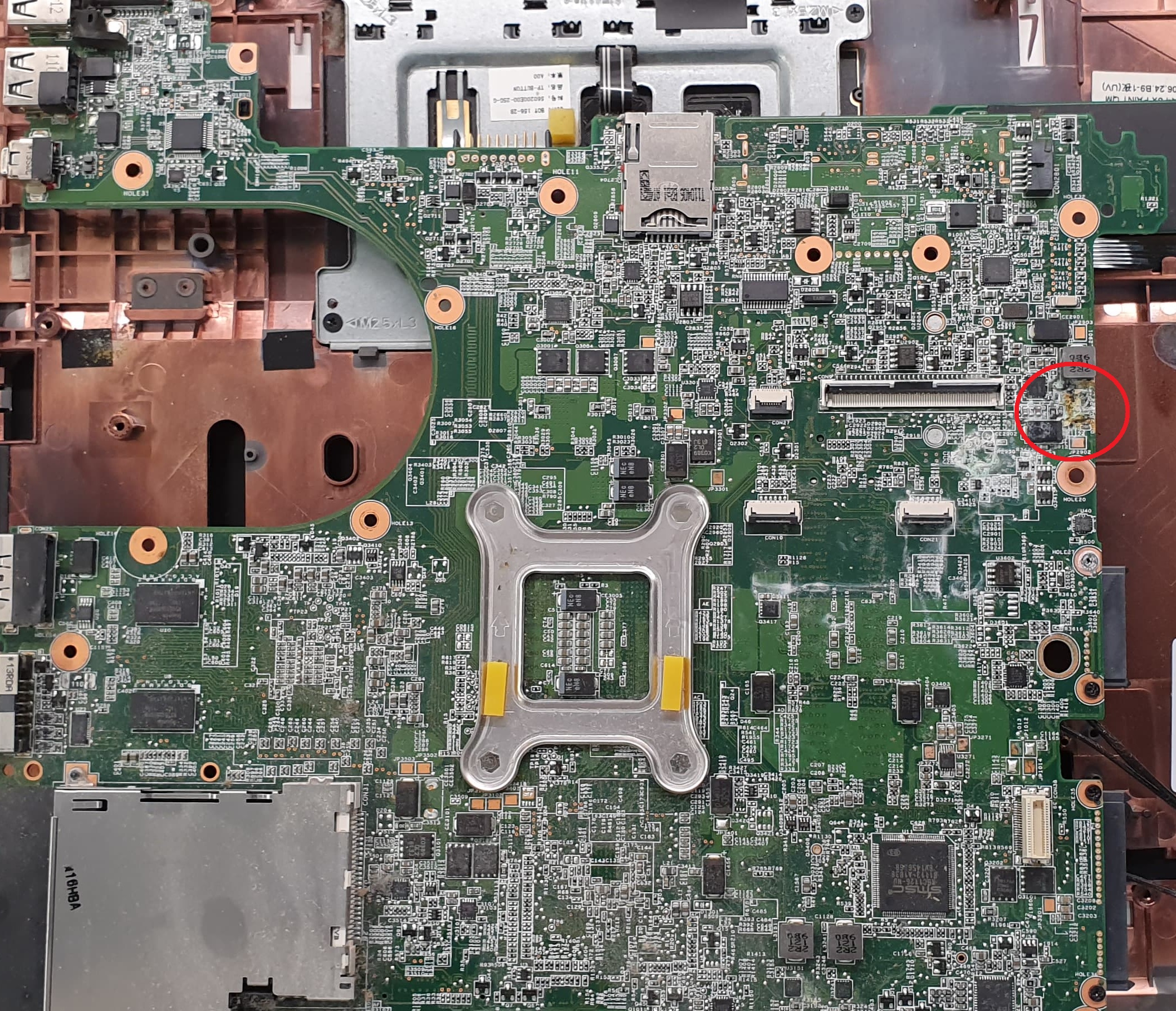

    I have HP 6560b motherboard (CURE_DIS_HR_HPB). Motherboard is liquid damaged. After ultrasonic cleaning there is few components, that I need to change.
    I put numbers on damaged components (photo attached). Can anybody help me to identify them?
    1- capacitor on 19V rail, so I can put something like 0.1uF (by RT8205C datasheet);
    2- I think, this is MMSD914 diode (googled by marking);
    3- resistor, measured 100K ohm (can't be sure);
    4- resistor, can't measure;
    5- schottky diode BAT54C (googled by marking).
