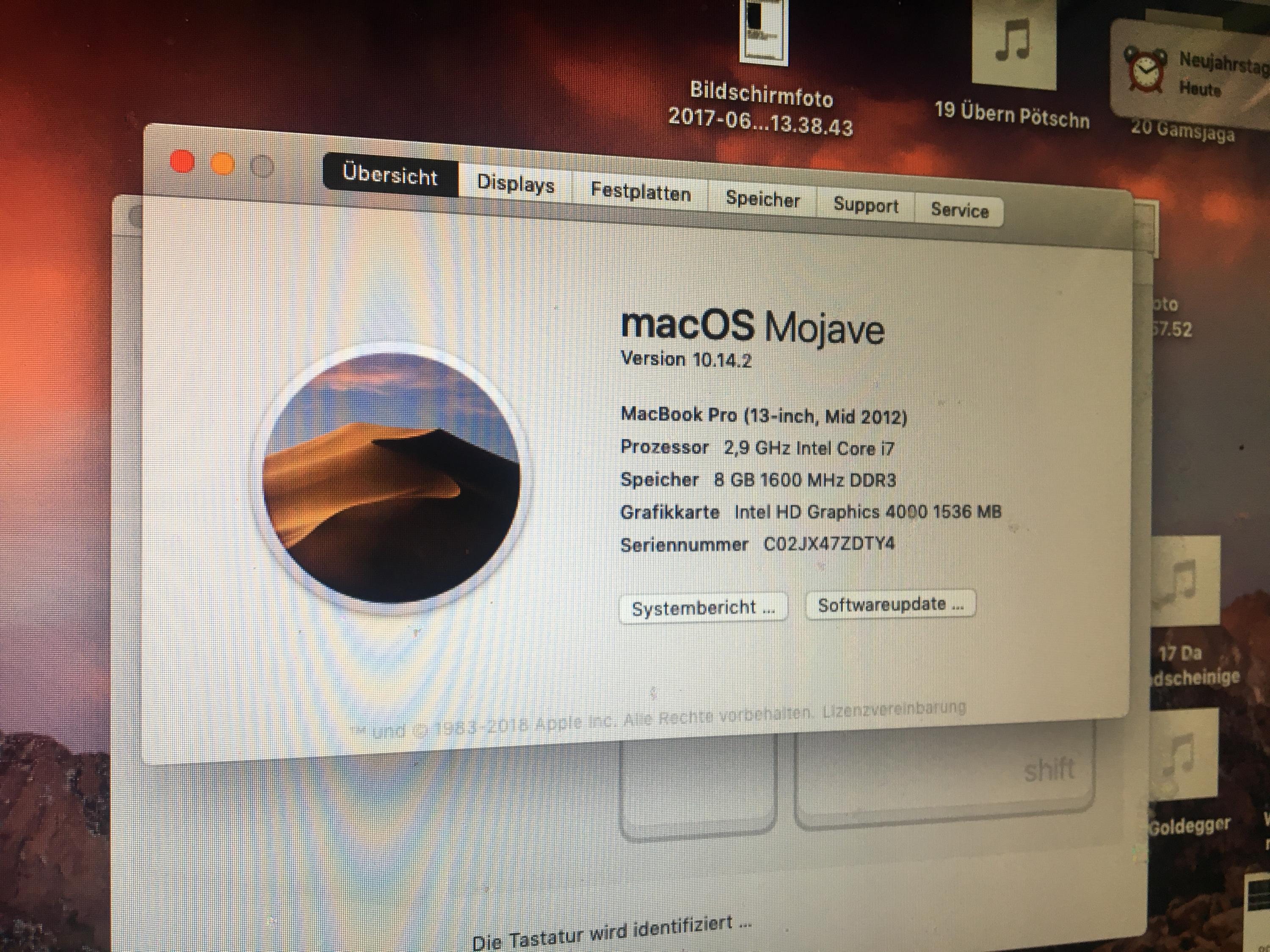

    somebody know what could happen ?
    After Change the GPU with Rework station (BD82HM77 - SLJ8C) on pcb the keyboard + Trackpad + 1 of the usb ports are no more working.
    (the second usb directly beside is working)
    The device starting fine and all other functions are ok(wlan,ect.)
    By soldering process the BD82HM77 make a little bubble on the top (i think the ic wasnt dehumidified enoght). is it possible that is the reason`?
    thnx for help

    Re: Macbook Mid 2012 NO Keyboard + Trackpad after GPU Change
    its called popcorn and yes its a bad thing
      Obviously with a popcorned PCH it's not gonna work well…
