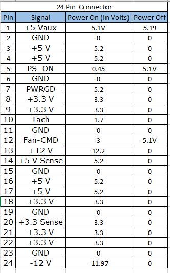

    Hi All,
    I have an HP DC7700 motherboard with no POST and no display. I have swapped the CPU, reset the BIOS, and swapped the power supply ( i have 4 identical units) and still nothing.
    Below is the measure voltages from the 24pin connector and the 6 pin connector when the power on switch was on and off.
    I hope somebody can guide me on the next step to isolate what could have caused the problem. Thanks

          Re: HP DC7700 No POST, No Display
          anybody have a diagram for this? if I want to check if north bridge or southbridge is ok, is there a signal I could measure?
              i did swap the BIOS IC from the other good motherboard. the bad motherboard still did not POST and the good motherboard POST and there is a display. Is swapping BIOS IC equivalent to flashing?
                Yes swapping BIOS IC is ok.
                Did you check the capacitors?
                What's the voltage on CPU Vcore? (can be measured between the coils next to the CPU and ground, or across the capacitors next to the CPU)
                • debugtimog
                  • Jul 2018
                  • 30
                  • Malaysia
                  the capacitors are OK both on capacitance value and ESR(below 1 ohm). The Vcore, I think around 1volts something, not really sure, but I did compare with the other good motherboard and it is the same, thats why I dont remember exactly the value.
