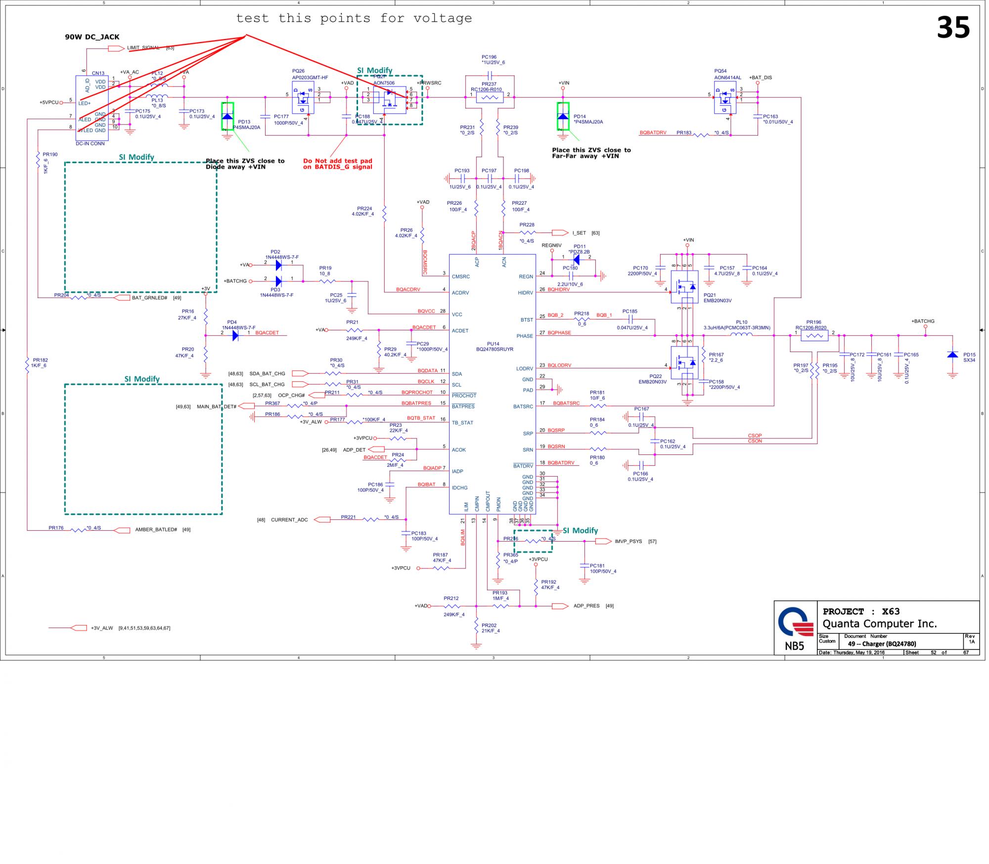

    hello everybody
    i'm having an issue with hp probook 450 g3
    DA0X63MB6H1 REV : H
    1- When pluging the charger in nothing, even the led indicating that the charger is plug doesn't come. nothing happen when pressing the power botton.
    2- when charging the battery in another working laptop and bring it back. the laptop work fine but did not still recognize the AC.
    I need your help
    thank you

    did u check charger_?

      Yes ,charger work fine. I've even tried three different charger

        test this points is your charger 90W ?
