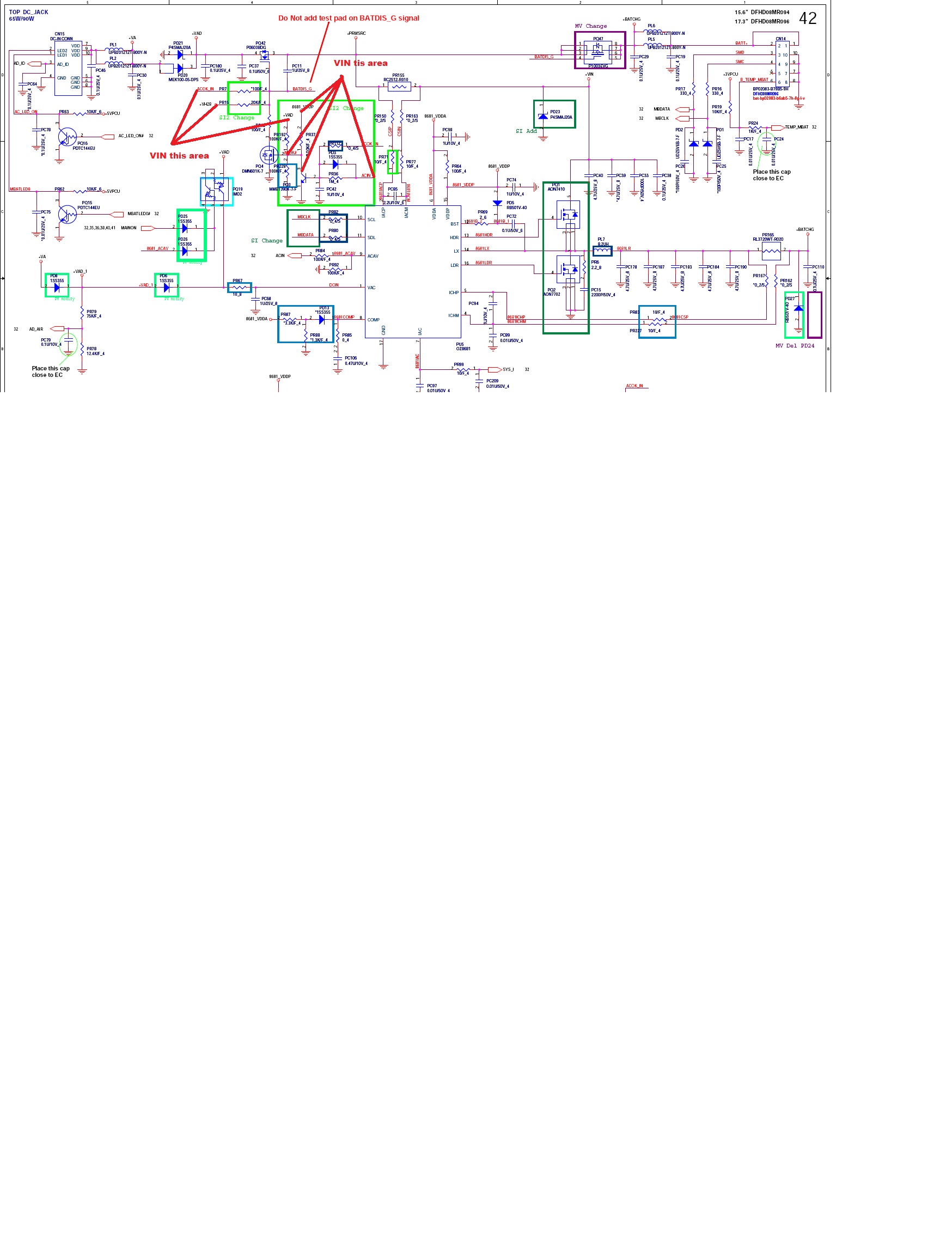

              Re: pls help help hp dv6-3357sf no light no power .
              Normally this motherboard requires (page 42 CN15) the AD_ID signal so you only use original or compatible adapters for this model. We should check if there is a short circuit + VA or + VAD or + VIN, check the ohms on those points with the multimeter.
              Report the results

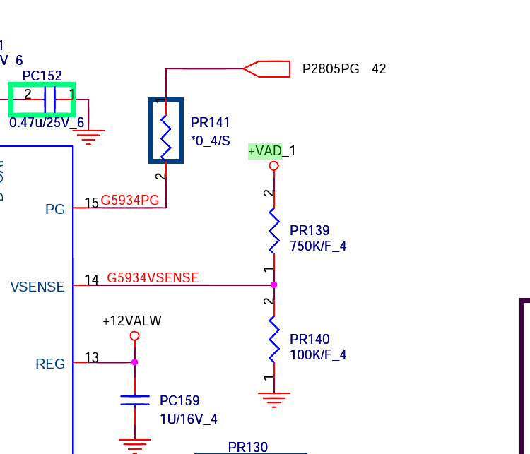

                i test the resistance both sides but no short circuit ; side gives 18.5v and other sides gives me a high ohms value because it's connected with capacitos .
                i can't find pr139 for test VAD_1
                but the pin 14 gives me 2.15v
                and here

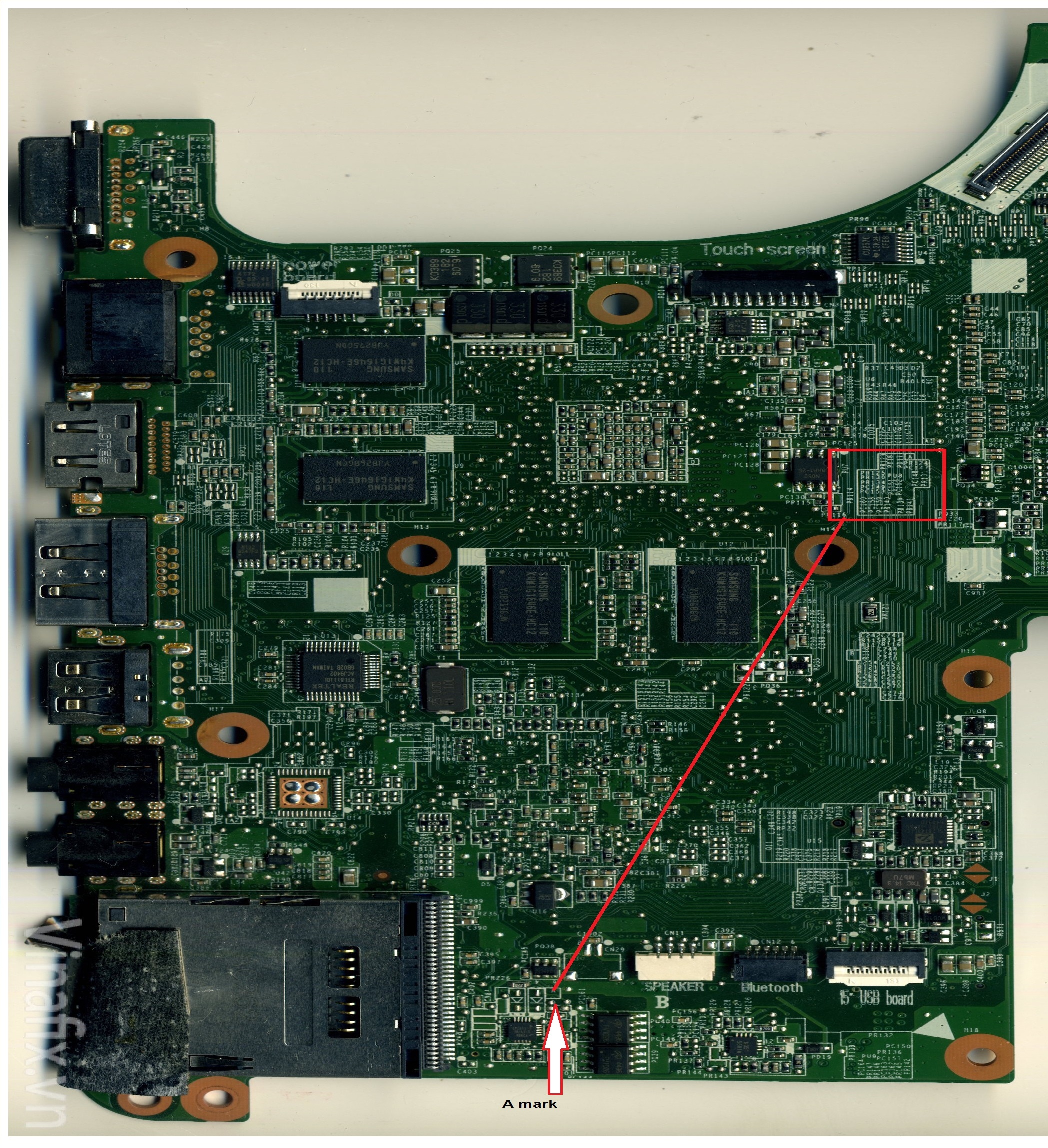

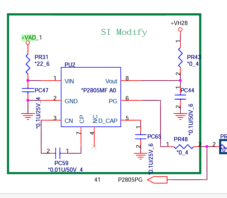

                  the motherboard and schematic are different
                  this is PU8
                  and this in blue circle suppose to be PU8
                  but a lot of components are missing like PD17 and pr124 pr141 ...
                      this is PU8
                      Seem All matched
                      Hope this helps
                        this is PU8
                        yes this Schematic is Different mesure Voltage in this area , did you resistor PR226 ?

                          • VH28 is output voltage from PU8 as voltage pump to activate PQ42 (need gate higher than source or drain).
                          • if PR226 blown then there is something in circuits, maybe PU8 (maybe other IC too) was broken.
                          • Need to check many net those point as per post7#
                          • Also make sure the charger known as good original adapter ( i think client charger has modify).

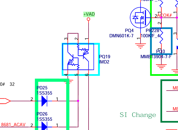

                                PU8
                                • PU8 should work and there aren't pinout have shorted (except pin21)
                                • input present and have output VH28.
                                • P2805PG present (3.3V), VSENSE( approx 2.2V) REG (12V)
                                PU5
                                • PU5 have input (pin1 VAC generated from +VA via PD8>PD6>PR67).
                                • Voltage on both VDDA/VDDP approx 5V
                                • ACAV present 3.3V and generate as ACIN signal via PR84.
                                • Also ACIN signal require for generate PQ19 (PNP-NPN on SC-74 package) so when pin 5 be ON, pin 2 be OFF, then +VAD cross to pin 6 PQ19.
                                • When +VAD present, PQ4 be ON via resistor divider PR192-PR228, Though VH28 present if this fet ON make PQ42 be OFF.
                                • ACIN signal require to make PQ3 be ON and PQ4 be OFF, then PQ42 be ON and generate +PRWSRC/+VIN
