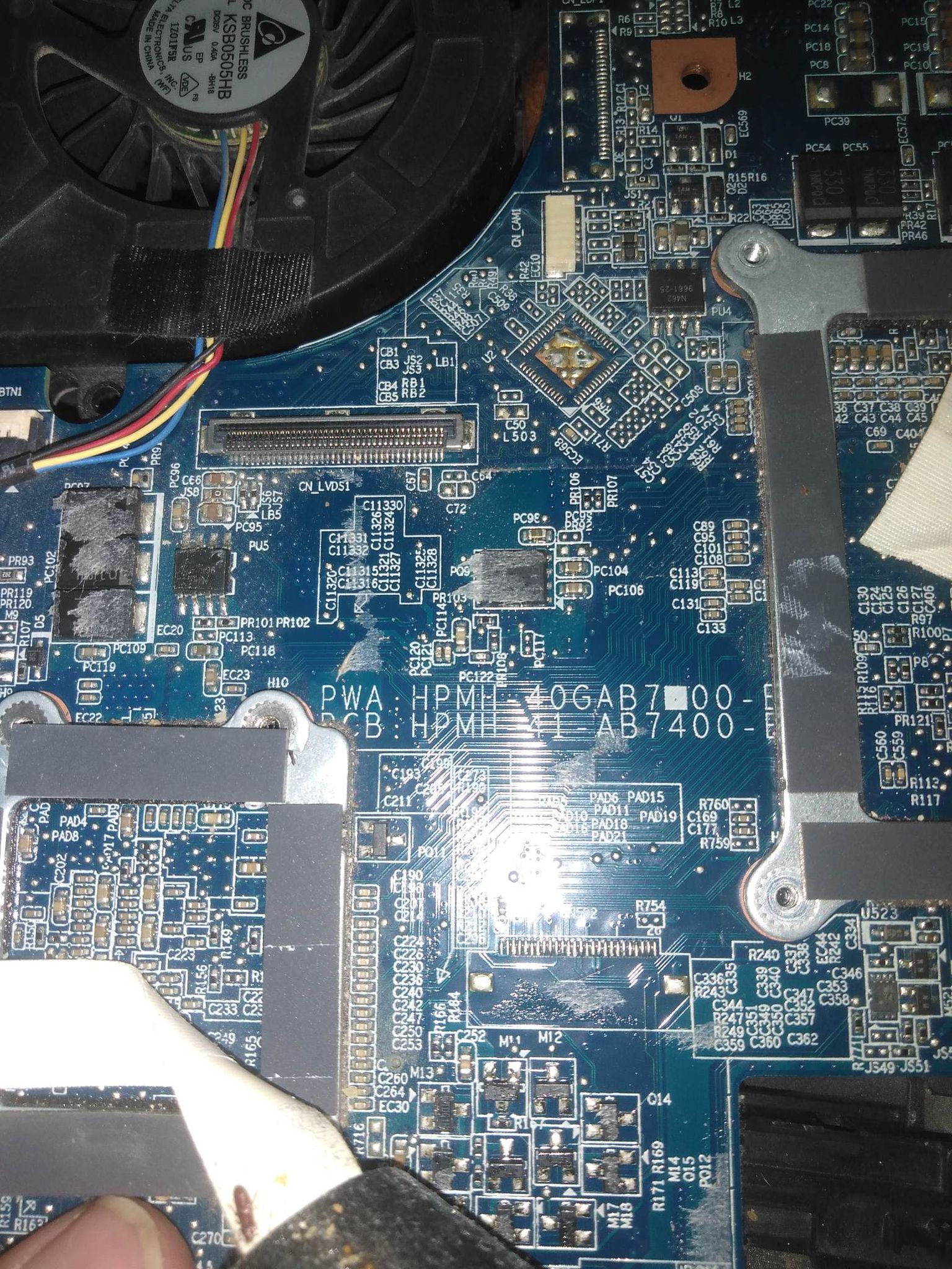

    hello all,
    is there anybody got a schematics for dis to uma conversion, for dv6 with daut1amb6e0 revE motherboard ??
    thank you

    it seems no schematics is available for this laptop. So the conversion will be difficult. check which one these schematics matches your mainboard:
    https://www.badcaps.net/forum/showpo...5&postcount=10
      Re: HP DV6, DAUT1AMB6e0, need dis to uma
      afaik, conversion not possible on this platform.

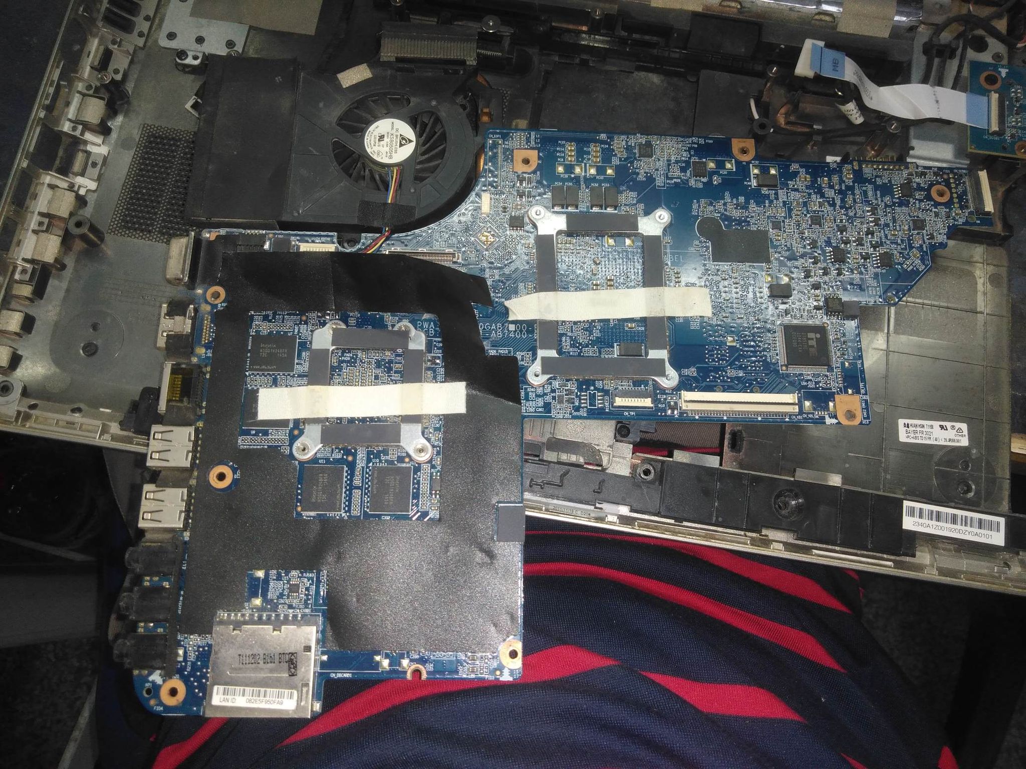

                  assalam alaikom can anyone help me to disable the graphic card for this dv6
                    Here you go
                    PCB HPMH-41-AB6200-D00G
                    PWA: HPMH-40GAB 00-D
                    TO CREAT INTEL BOARD
                    JUT REMOVE GFX COIL
                    PUT JUMPER IN M50 TRANSITOR IN LEG 2 TO LEG 3
                    THEN JUST SHIFT RJ8 RESISTOR PLACE 10K
                      Originally posted by mcplslg123 View Post
                      Here you go
                      JUT REMOVE GFX COIL
                      can you give me datasheet please
