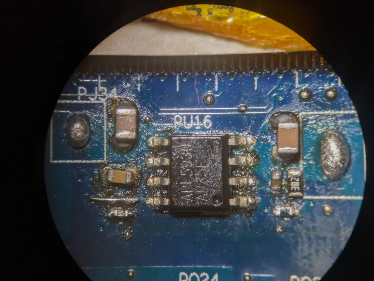

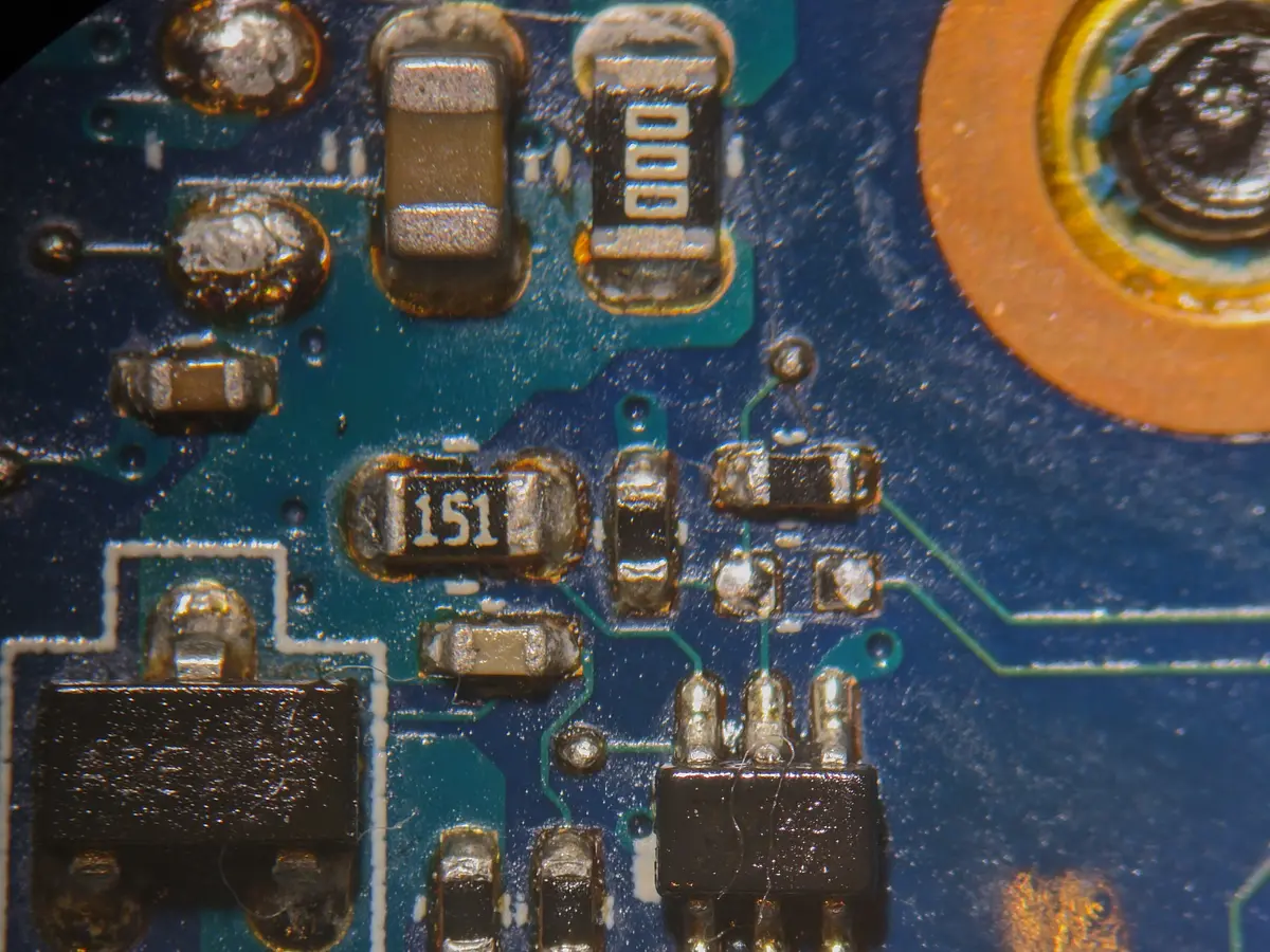

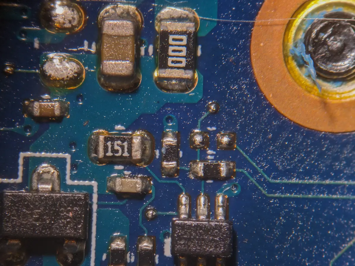

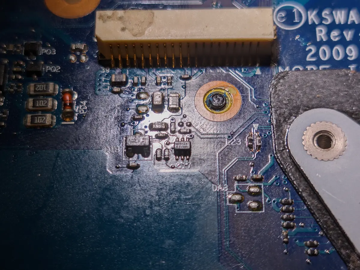

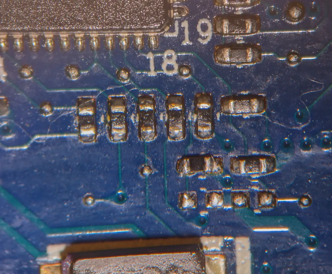

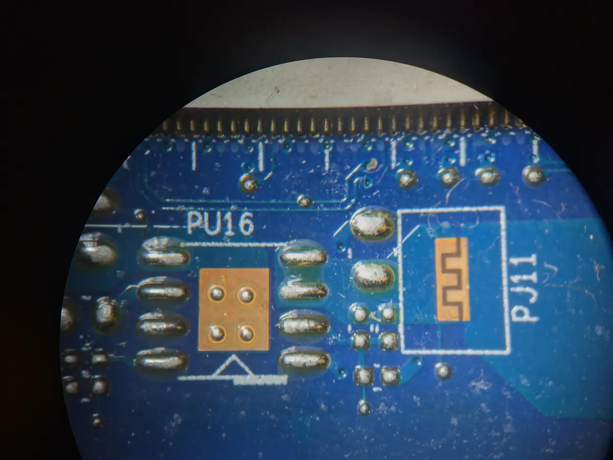

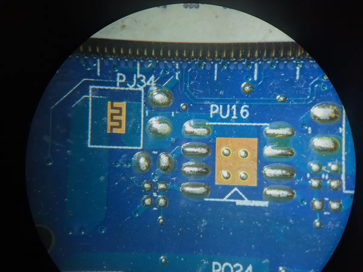

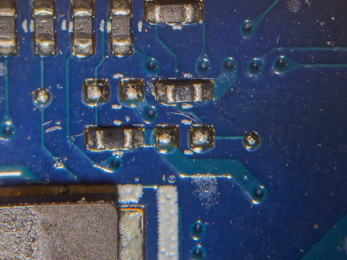

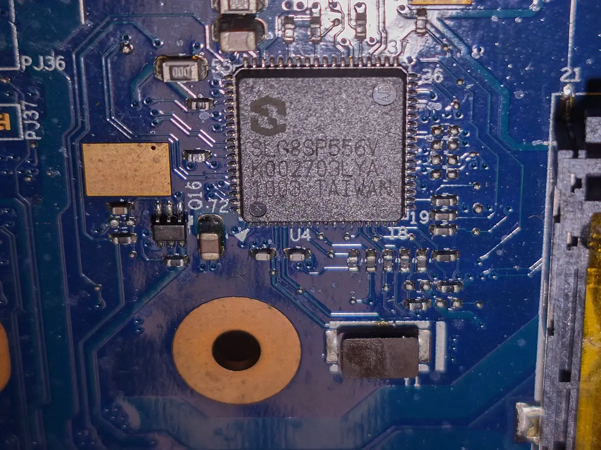

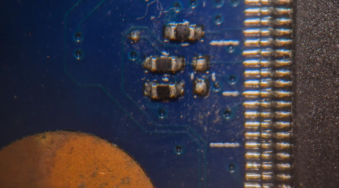

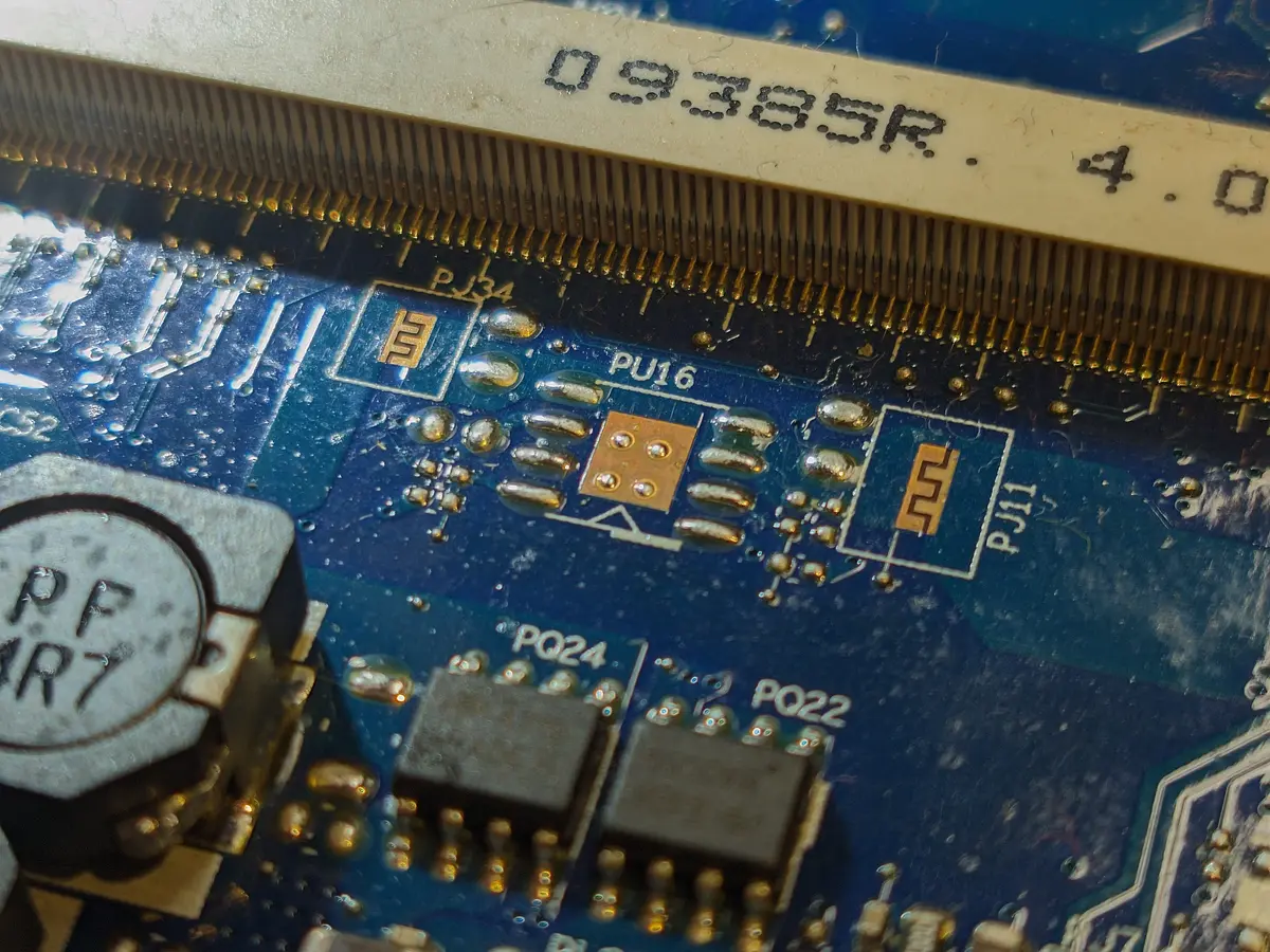

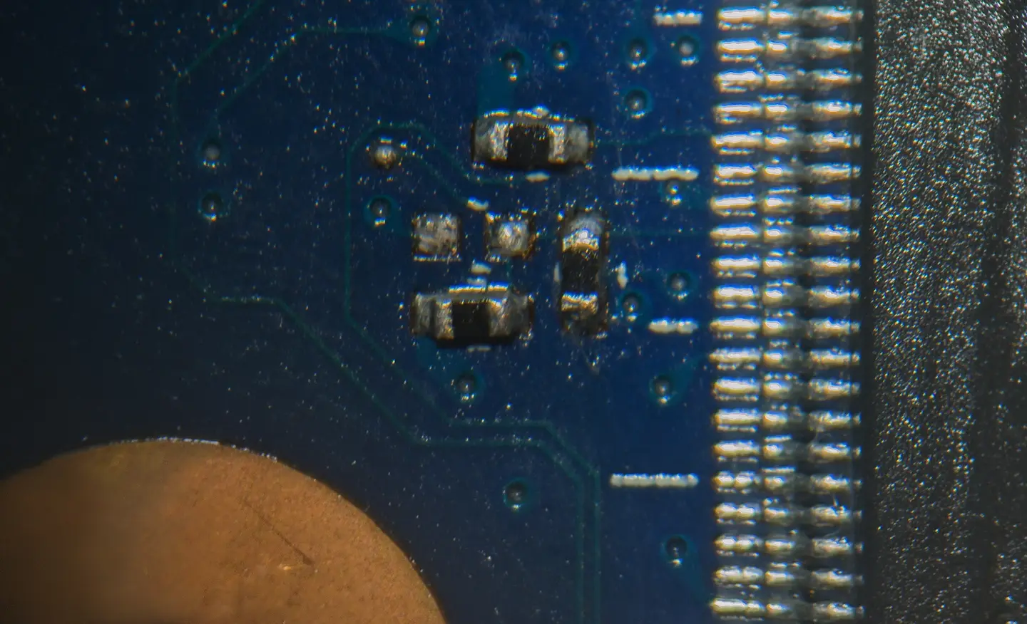

    I have two almost identical computers, unfortunately both with a faulty MXM graphics card. More specifically:
    - One doesn't enable the backlight and exhibits artifacts in the form of colored stripes, with the drivers crashing immediately with a BSoD upon loading.
    - One was exhibiting very similar if not identical artifacts and then the GPU became fully shorted, right after a reflow attempt.

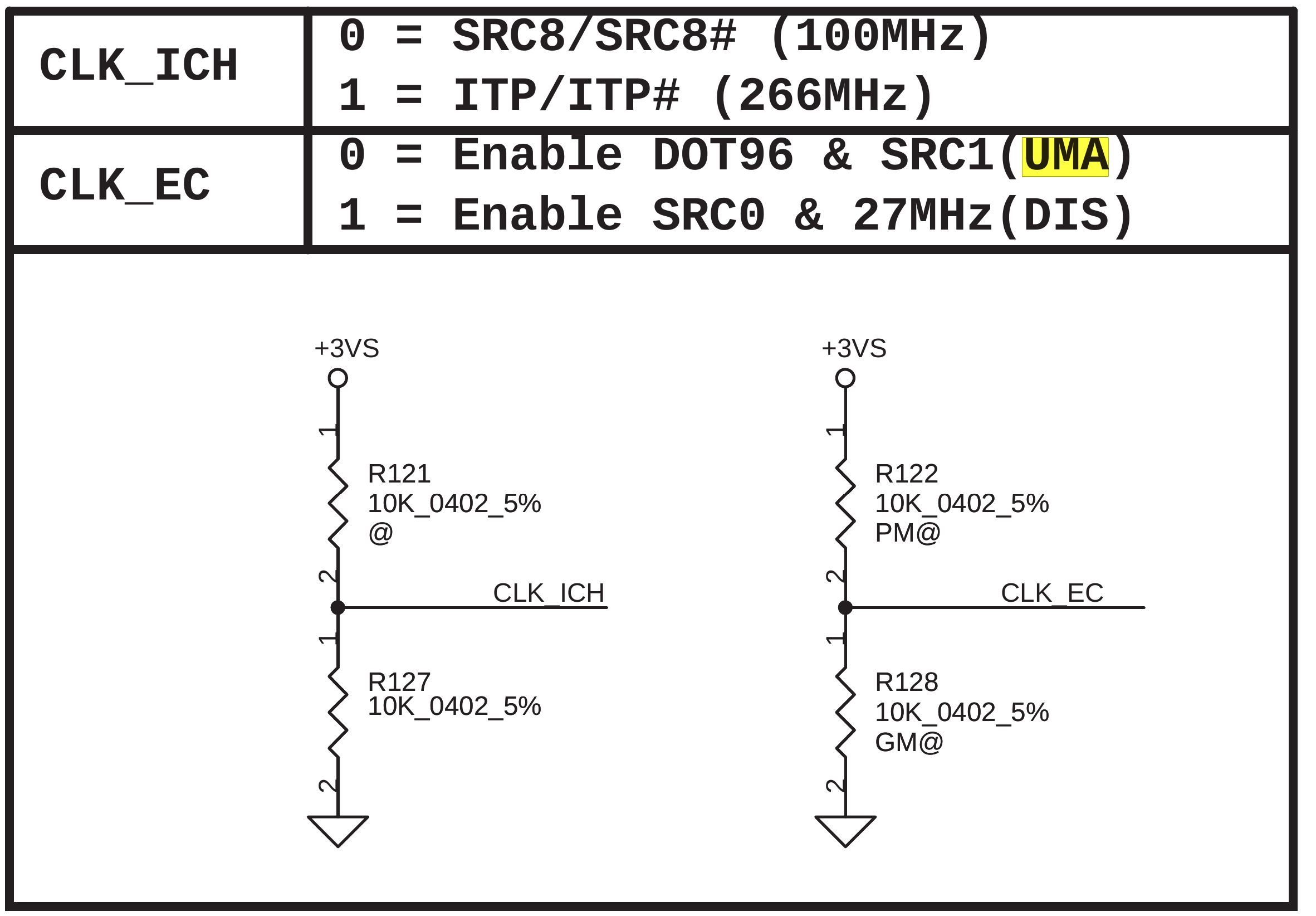

    Since the LA-4982P was also manufactured without the MXM slot (pads unpopulated), I immediately thought about performing a UMA conversion. Unfortunately there appear to be no guides whatsoever and I'm pretty sure it's because:
    1. A few components must be added.
    2. There is no boardview available.
    3. The silkscreen is almost non-existent, making it quite hard to understand the references in the schematics.

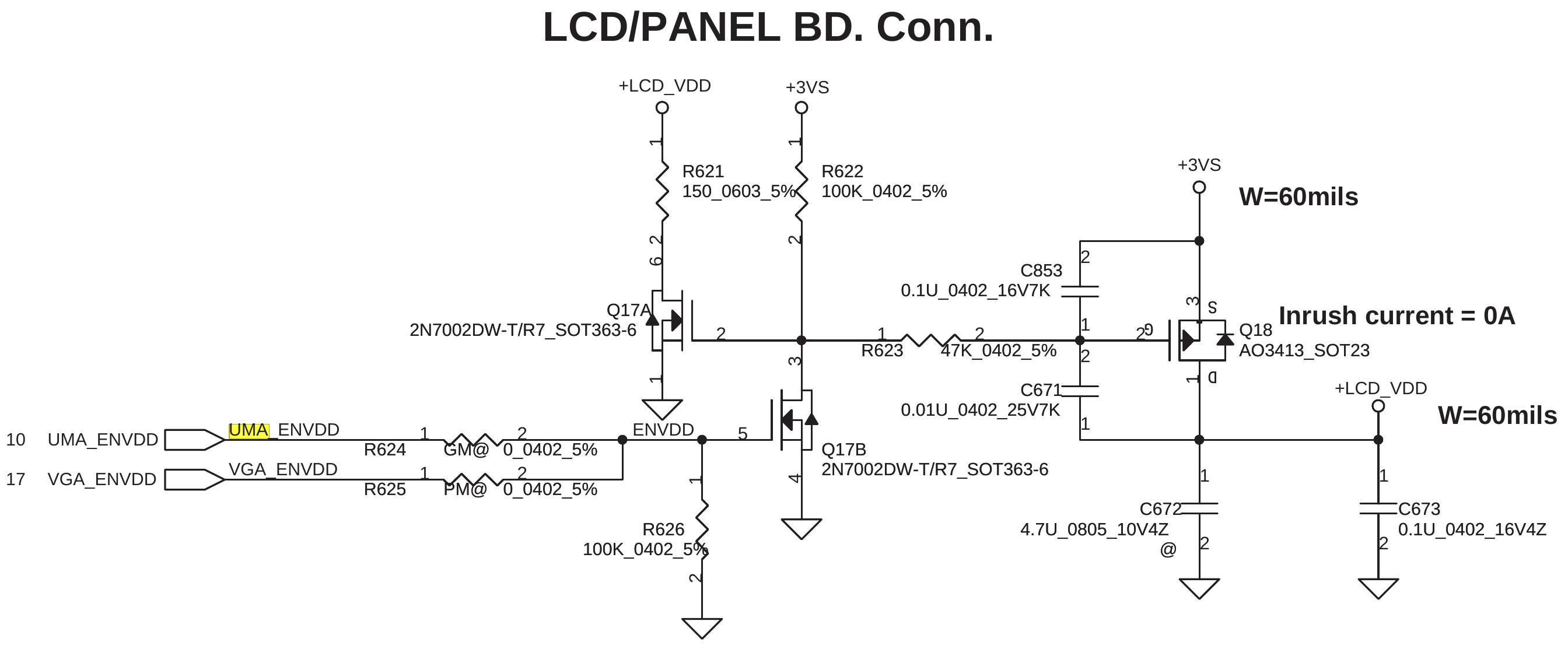

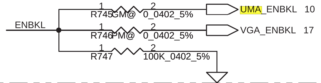

    I decided to do it myself, double-checking with photos of the non-MXM variant and ignoring external display (VGA, HDMI) stuff for now:
ID:	3655299 Click image for larger version
ID:	3655301 Click image for larger version
ID:	3655302 Click image for larger version
ID:	3655303 Click image for larger version
ID:	3655306 Click image for larger version
ID:	3655304 Click image for larger version
ID:	3655307 Click image for larger version
ID:	3655309 Click image for larger version
ID:	3655310 Click image for larger version
ID:	3655311 Click image for larger version
ID:	3655313 Click image for larger version
ID:	3655314 Click image for larger version
ID:	3655315 Click image for larger version

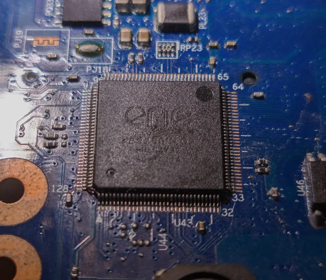

    The "For UMA" circuit seems to be working fine as it outputs 1.88V and I'm pretty sure the other 3 modifications are correct.
    Unfortunately the motherboard doesn't appear to be POSTing, despite a steady consumption of 0.90A. The orange (Wi-Fi) LED on the front never comes on and there is no picture nor backlight.
    Interestingly, the fan turns on and off just fine while in that state, meaning that temperature monitoring and control is okay.
    Does anyone have a clue? Thanks in advance!

    I compared 2 boards LA-4982P, UMA and MXM version, too many things to change.
    Even without boardview, you need to check every element, including the jumpers.
    The MXM version does not have an HDMI chip for UMA.
    If you look at the diagram, you need to put everything marked GM@ and IHDMI@, remove/replace everything marked PM@ and NIHDMI@. Short-circuit the jumpers PJ27, PJ28, PJ29, PJ30, PJ31, PJ32.
    And who knows what else...
