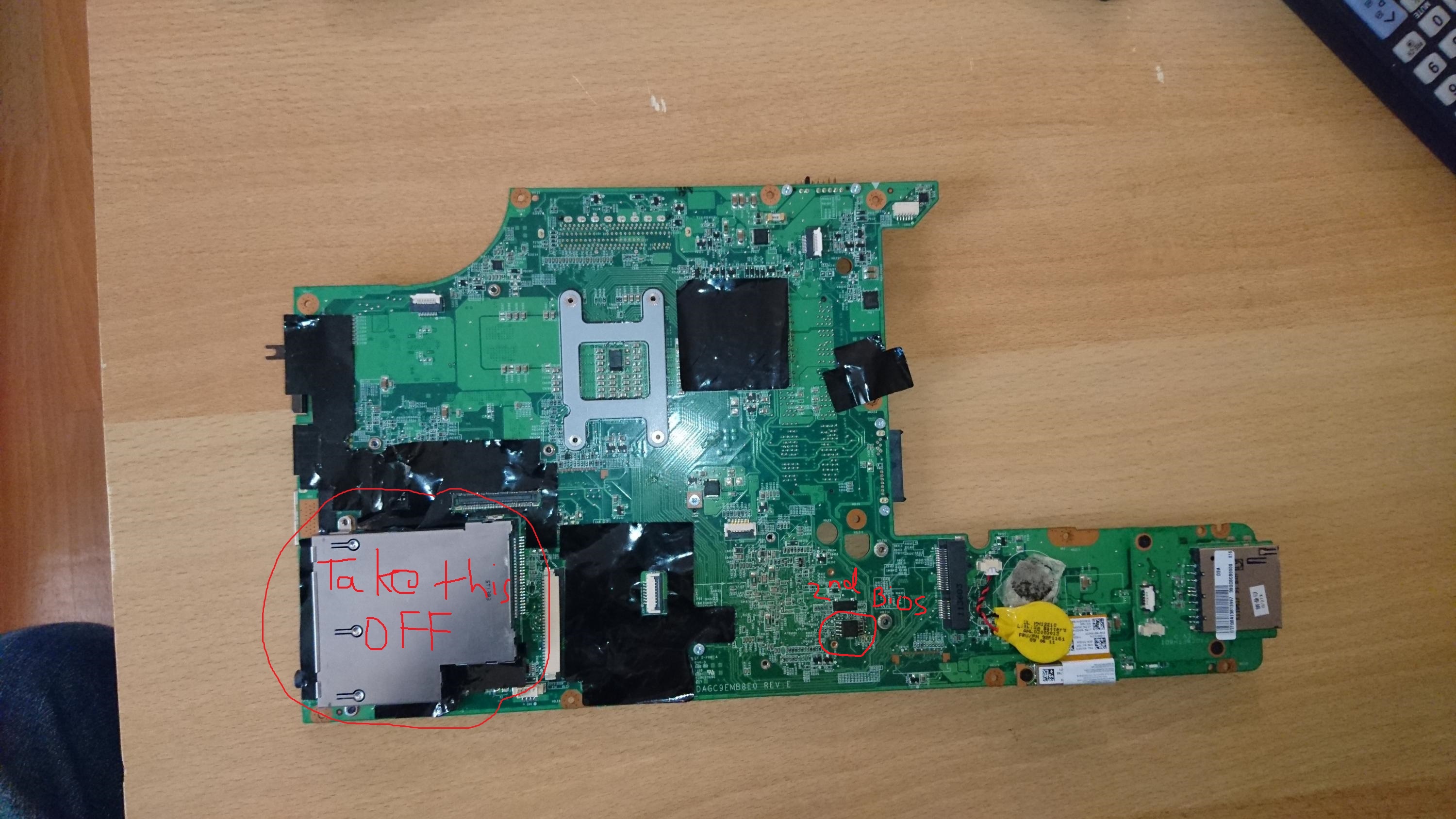

    I ve 2 Lenovo L420 with no power only led battery blink 3 times when plug charger
    I check voltage on motherboard.
    I found 3VPCU and 5VPCU
    I found 5V_S5 (few second after press power button) , 3VSUS (always),3V_S5(always)
    BIOS IC i found 3,3V only after press button few second.
    I tried flash bios
    Didnt find voltage of CPU, of DDR, ...
    thx

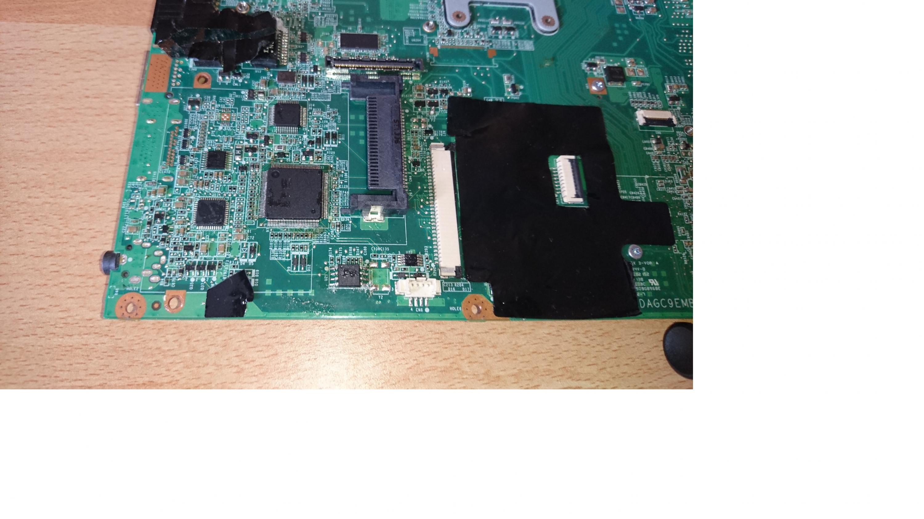

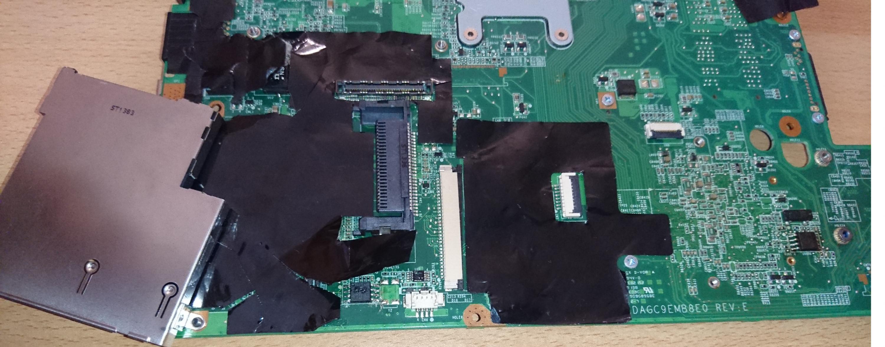

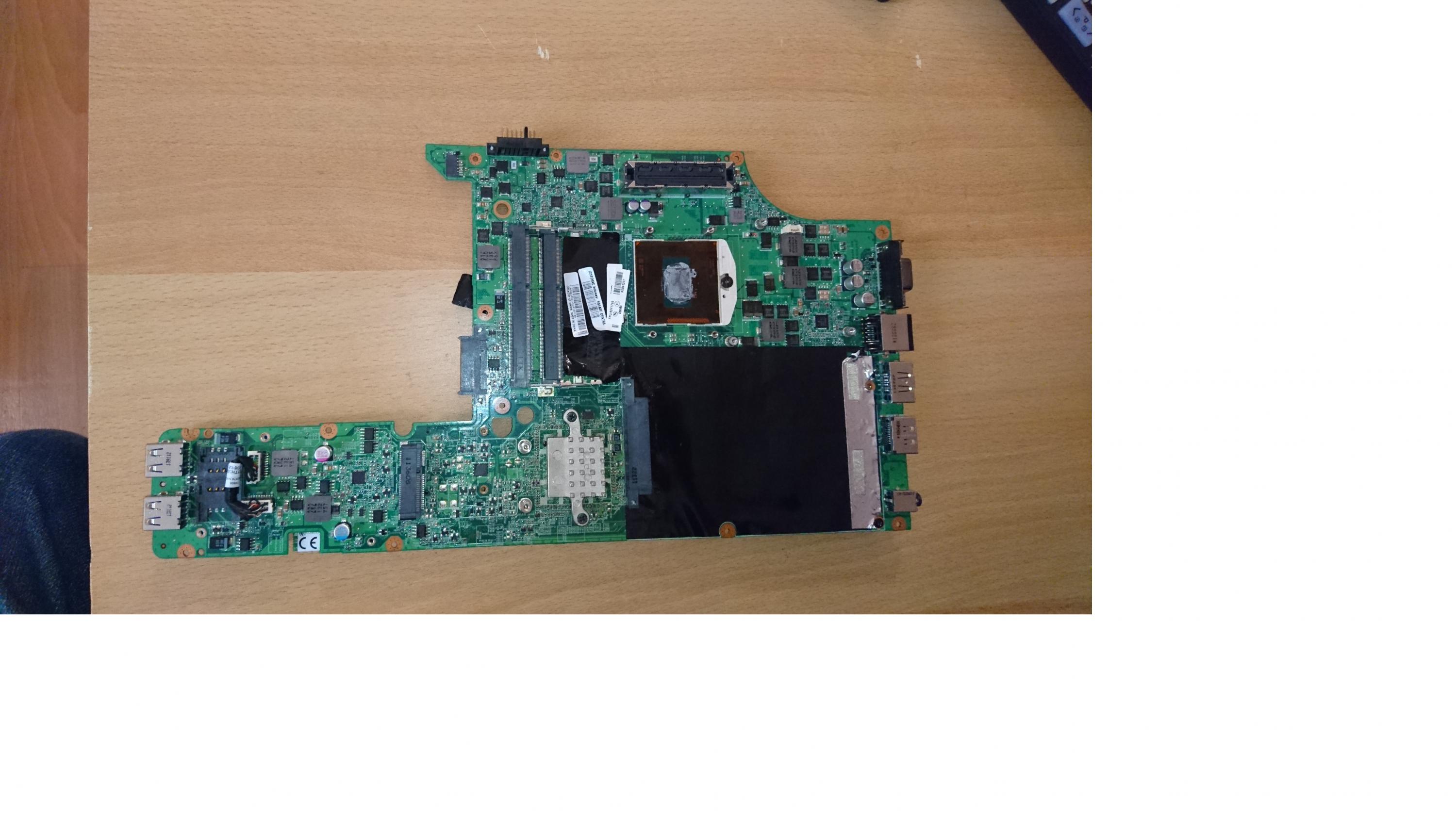

            ok Schematic you have upload is for L412 not for L420 near the PCH you have another bios chip send close up snaps of the MOB both sides
            test you power button when you press it goes to 0V

                Re: Lenovo L420 no power only led battery blink 3 times
                remove that part
                  I checked voltage of KBC IC but i didn't find the 3V at C134
                  • Techtiger
                    • Oct 2014
                    • 1602
                    • france
                    since i don't have the Schematic i cannot tell you exact KBC number if it's IT8502E you have to test pin 26 50 92 114 121 any of the pin have 3.3V KBC power ok but in KBC a lot of test point's to check. You have programmer U21 512ko? Tell me the number 2en BIOS chip
                              rtc section is short. In my case C8364 is shorted.
