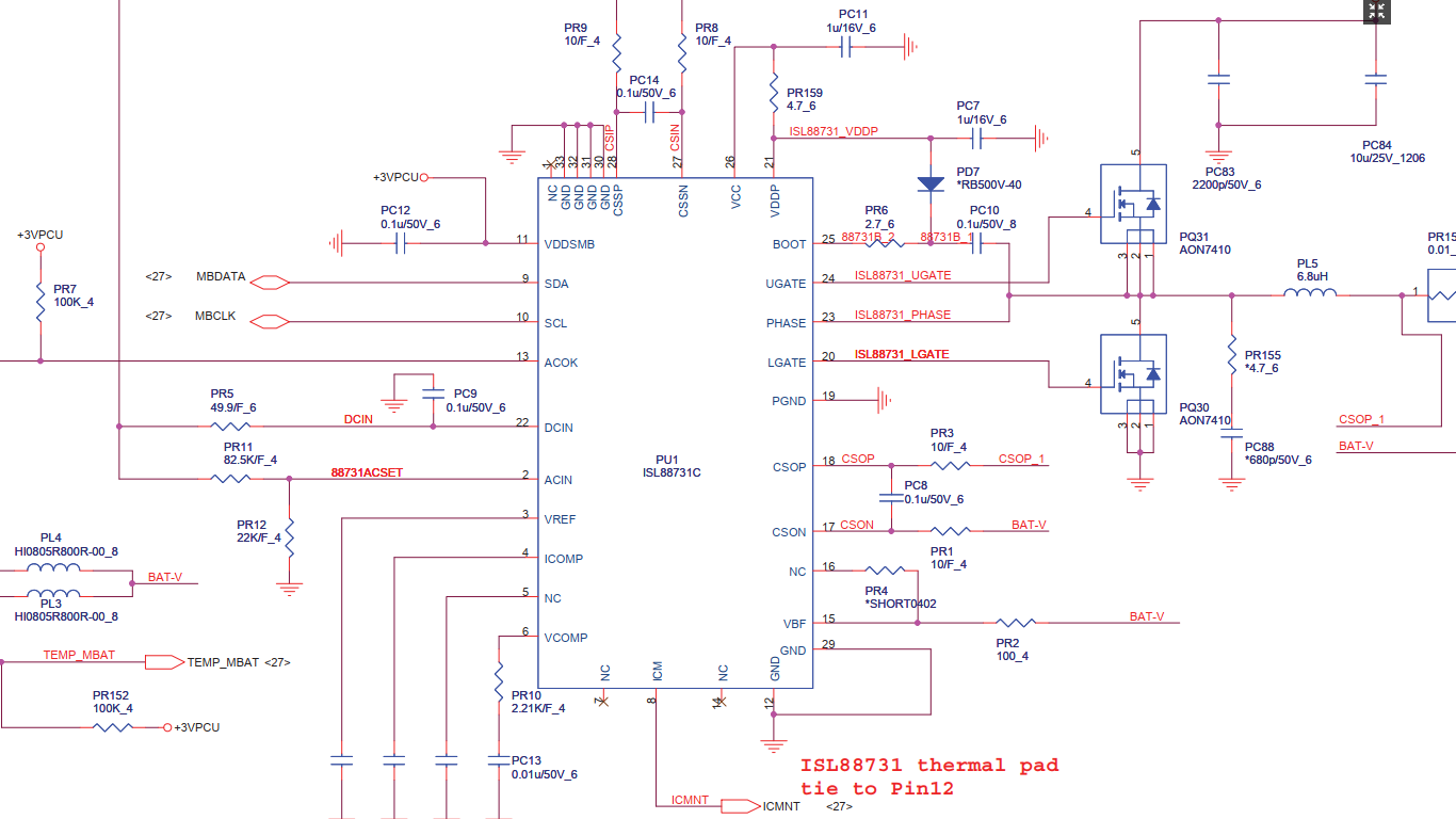

    Re: da0zqhmb6c0 acer 4739 not turning on with battery
    Battery only, Check all VIN voltages that connect to any part especially resistor. e.g PR225, PR239.
    Make sure all have right value resistance.
    But I suspect PR225 or SYS_SHDN# signal was leakage.
      you checked discharge fet?? Might be open. Your measurements are with AC Adapter only or what??
            remove PQ32 ang try running with batterai only. if it's ok replace PQ32 than PQ28
                On my LOG of SERVISE only had 2 cases:
                1. That's related with tonsel on block regulator of DDR. PR225 was change value, on input side correct voltage battery, but on next side no voltage, actually found on ZE7 board. (PR120)
                2. SYS_SHDN# issue.
                This possibly far from what i expected, found on ZQZ board which have different ic of charger.
                Keep watch your thread, maybe someone will help you.
                if your customer not in rush...
