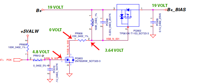

    SO I have a dead dell laptop that does not turn on. I also do not see any shorting when using DC power supply.
    The board does have 3 /5 ALways voltage . there is not voltage on PIN 8 of the Bios Chip though.
    Also I am attaching a pic and would like to know why I am getting 0 voltage on the other end of the resistor

      for me it's normal PQ903 N Channel Mosfet gate Voltage 5V S & D GND
      +B 19V with Voltage Dividers 20K &100K 3.64V OK to PQ903 Gate pass to conduct 19V to B+BIAS
      send the Schmatic to find out adsent of 3.3V in bios leg 8

        Thanks. After giving some heat on the SIO Chip now the laptop starts but has no display and no post.( Schematic attached )
        Even after removing the Ram , there is no beep . The fan spins and two LEDS glow. The PCH also slightly warm.
        Where should I start now ? Any checkpoints please..

          Check voltages on Vcore coils and Ram. Might be bios issue

            test all gray coils for voltage
            PL700 +VCCGFXCORE
            PL701 VCCCORE
            PL900+VGA CORE
            PL600
            PJP300 JUMBER +0.75VS
            PJP303 JUMPER +1.5
            ect save your old bios and try to flash bios you have 2bios chips i think you have to flash PCH one

              PL700 +VCCGFXCORE - No Volts
              PL701 VCCCORE - No volts
              PL900+VGA CORE - 0.14 Volts
              PL600 - 0 volts
              PJP300 JUMBER +0.75VS - 0.74 Volts
              PJP303 JUMPER +1.5 - 1.48 Volts

                  test voltage pin 22 ISL95833 +5VS
                  PQ700 +B
                  PQ701 +B
                  test 5 mosfets for any short
                  PU600 PIN 12 +VALW
                  MOST PROB BIOS ISSU TRY TO FLASH BIOS
