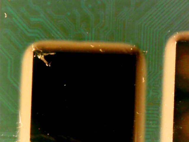

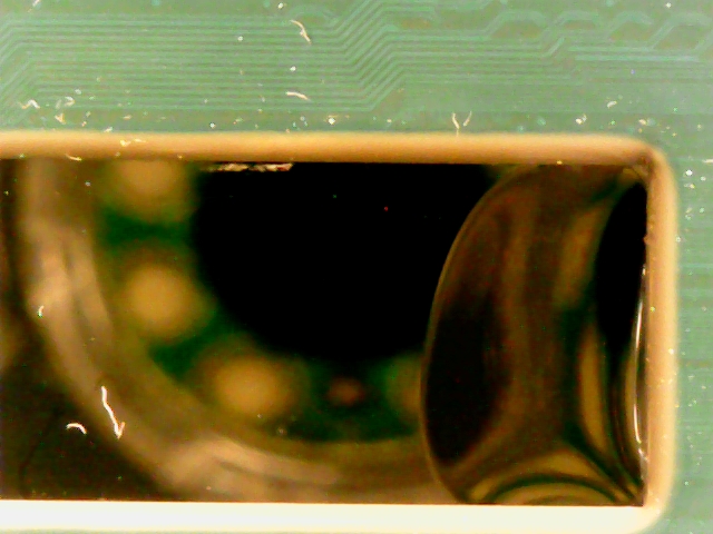

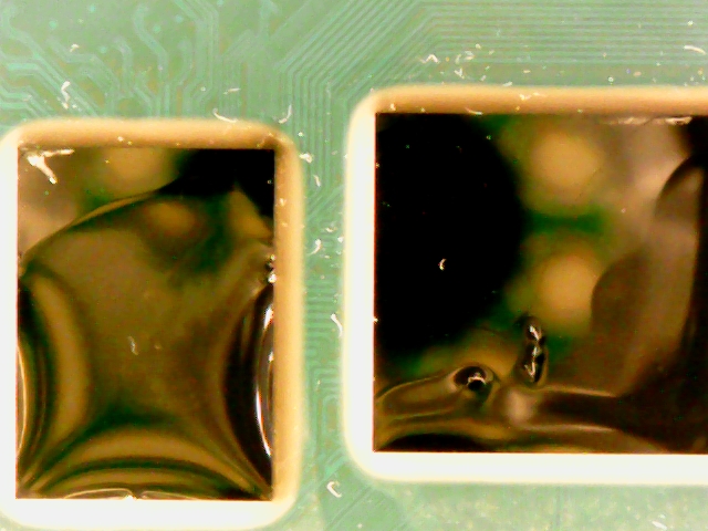

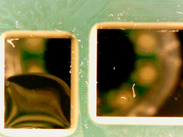

        While the board was running in loop (30 seconds) the CPU/PCH got warm.
        I removed the cooler (while running) and observed that the Fan started
        spinning (while the temperature was rising), so some kind of logic seems to work here.
        I tested the chips with alkohol and BOTH get warm. (not like hot)
        CPU get's only warm on one side, as I can tell and the PCH only the upper half. (s. pictures)
        After removing the cooler I found this:
        Does anybody confirm that this COULD cause the issues? If the PCH is broken, can other stuff work (fanspin), all power rails present and so on?
