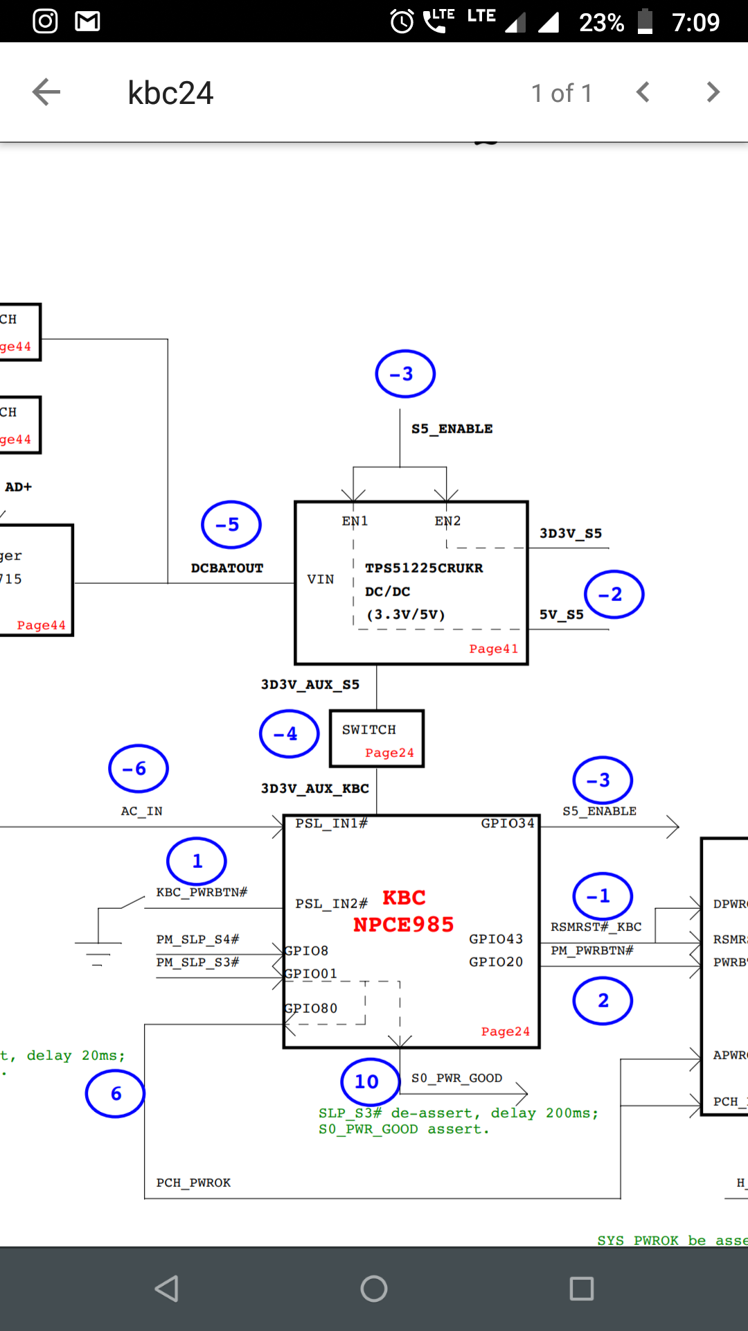

13269-1 Fx3mc rev:A00 not getting On

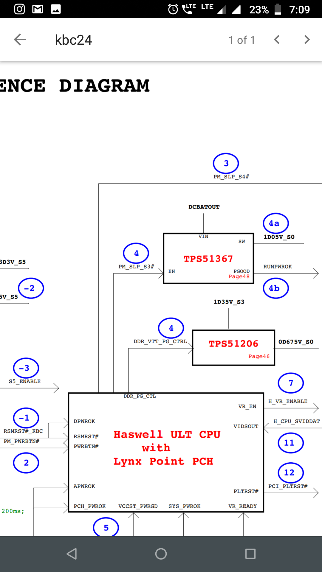

    not getting Rsm_rst#_KBC (pin no.15 KBC24)
    nd SUSCLK_KBC(pin no.77 KBC24)
    followed schematic all other pre required signals are present
    And I got a paid video on youtube where he challenged that in This case no prob. of CPU or KBC24 io..
    Plz help..
    Re: 13269-1 Fx3mc rev:A00 not getting On
    Followd power sequence...
    Not getting pm_slp_s4 and pm_slp_s3.
    pm_pwrbtn signal present.

        I was not able to solve this problem on this very model with the exact same problem RSMRST# missing. As far as i know, Without RSMRST# signal pc will not power on as SUS signals will not be generated by inbuilt cpu+pch . I too tried digging very hard but unfortunately gave up.
        Btw, I tried putting 3.3V on RSMRST# pin15 of KBC NPCE285 and the mb switched on with all voltage on all coils but still no display. On further digging i found that DRAMRST signal was missing on PIN30 Of ram slot. I tried to jumper that too with 1.35V but it didnt worked. I still suspect it's some sort of malfunction in inbuilt CPU+PCH die.
          RSMRST# is sent out by EC. SLP_S4# will come after RSMRST#.
          Follow steps -7, -6, -5, -4, -3, -2.
          RSMRST# is step -1, the one you're missing.
          Check if you have SLP_SUS#.
          Also schematics is a bit confusing and it seems like there are different variants. Look at Q1701 circuit and try to find the parts that are present or not present on the board.
