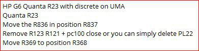

    i need conversion process for hp g6 from DISCETE TO UMA b:i DA0AX2MB6E0 REV:E. pls anyone giv solution

      [QUOTE=caspian;860563]search the web and you will find lots of instructions for conversion of this mainboard.[/thanks for response, all i could see is not the same board with my

            @Mahmoodjavan, its not quanta R13 Mb. He is seeking conversion for quanta AX2 mb.

              THANK but those r123 r121 and co are not found on my board is quanta ax2
