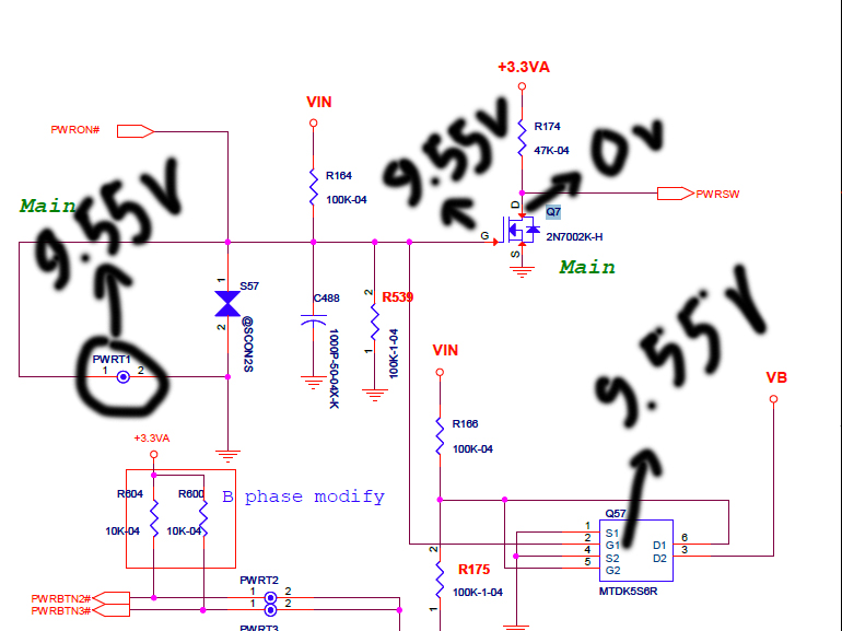

    ACER Z1402 on around 10 second and off
    Checked 19v, 3v, 5v, 10.5v, etc seem ok. i found one problem on switch button has 9.55v.
    Try change Q7 and Q57 ic. but problem still exist, any suggestion? does the problem come from EC controller ic?

            ok did you check the on of switch? if the switch is open you get 3.3v if its close you get 0v

              Did you solve the problem. I got mine same problem 9v on power switch

                Re: ACER Z1402 on around 10 second and off
                https://www.badcaps.net/forum/attach...3&d=1537151559
                check all the mosfets.. switch must be 3.3v when open and 0v when closed..
                  9V sounds ok there.
                    9V is ok like piernov say : resistor divider .
                    Check Q7 , R174

                          post your voltage readings(VIN, 3/5VALW, powerswitch)
                            Thanks reply. My problem same like this...
                              What is the problm if PWM_IN 3.3v is drop going to 0vdin the picture of screen is problm also.?

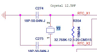

                                      Did you gays check the y2 (32.7khz)? Not done but not any improvement from change y2. So any further movement.
