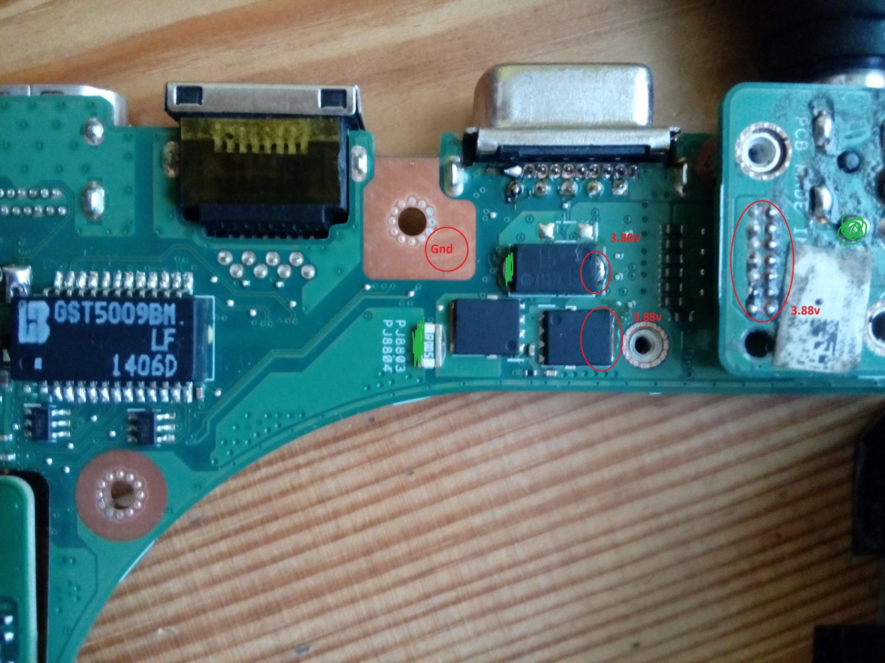

      Re: Asus ROG G750JZ
      Ah sorry i by pins i meant pins on DCIN board whitch is separate small piece.
      I didnt read any ics yet i tryed to search for +5V and +19 but they reads 0.5-0.7v

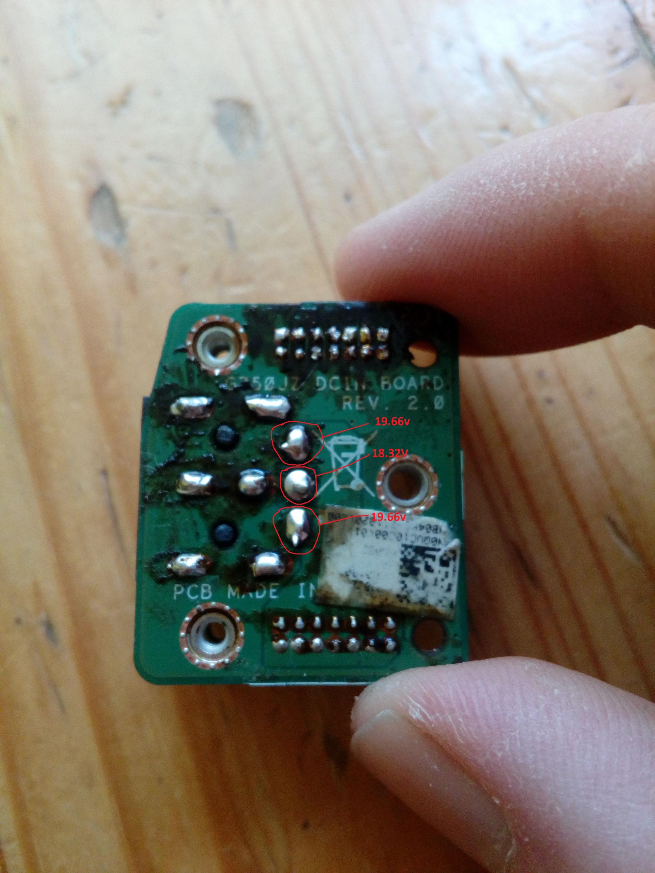

                Re: Asus ROG G750JZ
                I tryed to desolder the conector and pins and solder them back.
                I can read voltages on it so the connector works ? also excuse my poor soldering skills but the notebok still dead

                  Re: Asus ROG G750JZ
                  disconnect the DC-in board from the mainboard. then, check voltage on the DC-in board.
                    Values on the picture above your post shows the values with dcin board disconected.

                      Re: Asus ROG G750JZ
                      If the 19.6v is stable, the DC-in board is fine.

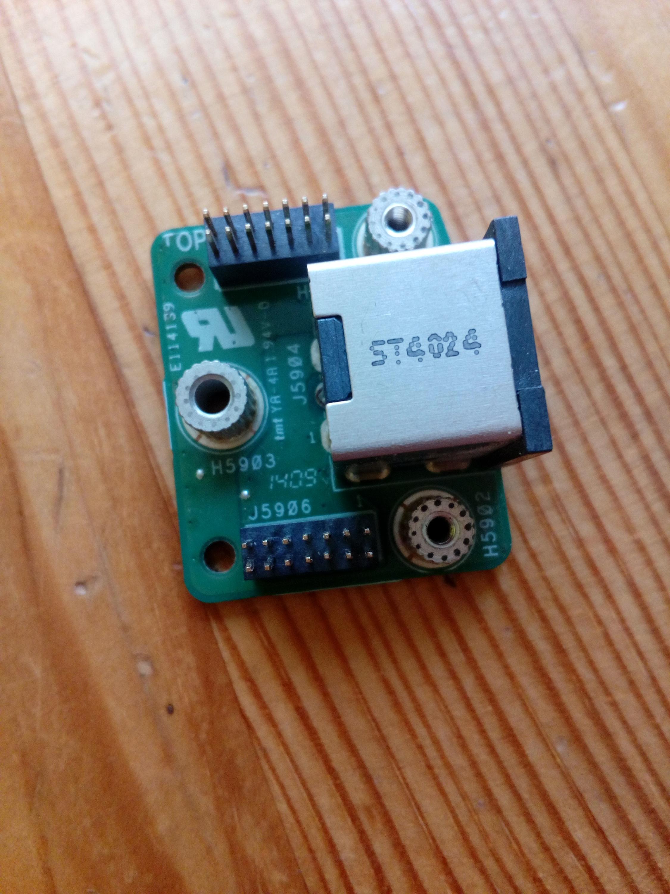

                            Re: Asus ROG G750JZ
                            a photo of the other side of the DC-in board will help.

                              Re: Asus ROG G750JZ
                              Heres the other side but u cant see much there.

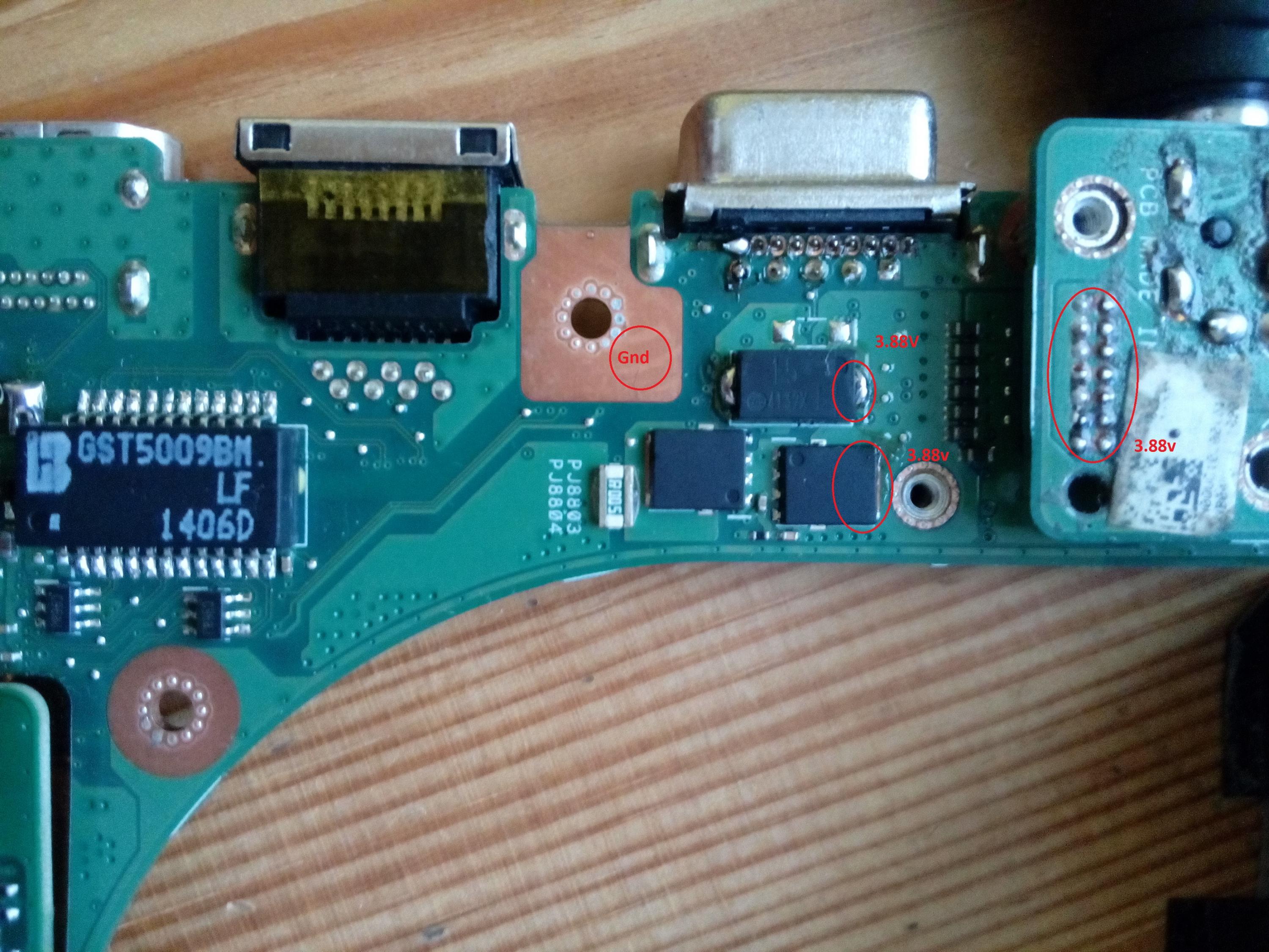

                                if notebook is disassembled, before try dc board, easy step is check if 19volts are present in the charger circuit. there is a big resistor (dunno if its really a resistor) that is connected to 4 mosfet; 2 for vin side and 2 for B+ side. if 19volts present here dc and psu are ok. if not then dc board problem, but as i see u have 19volt on solder it means it should be ok. center pin is probably of wattage indicator, but dunno how it works.

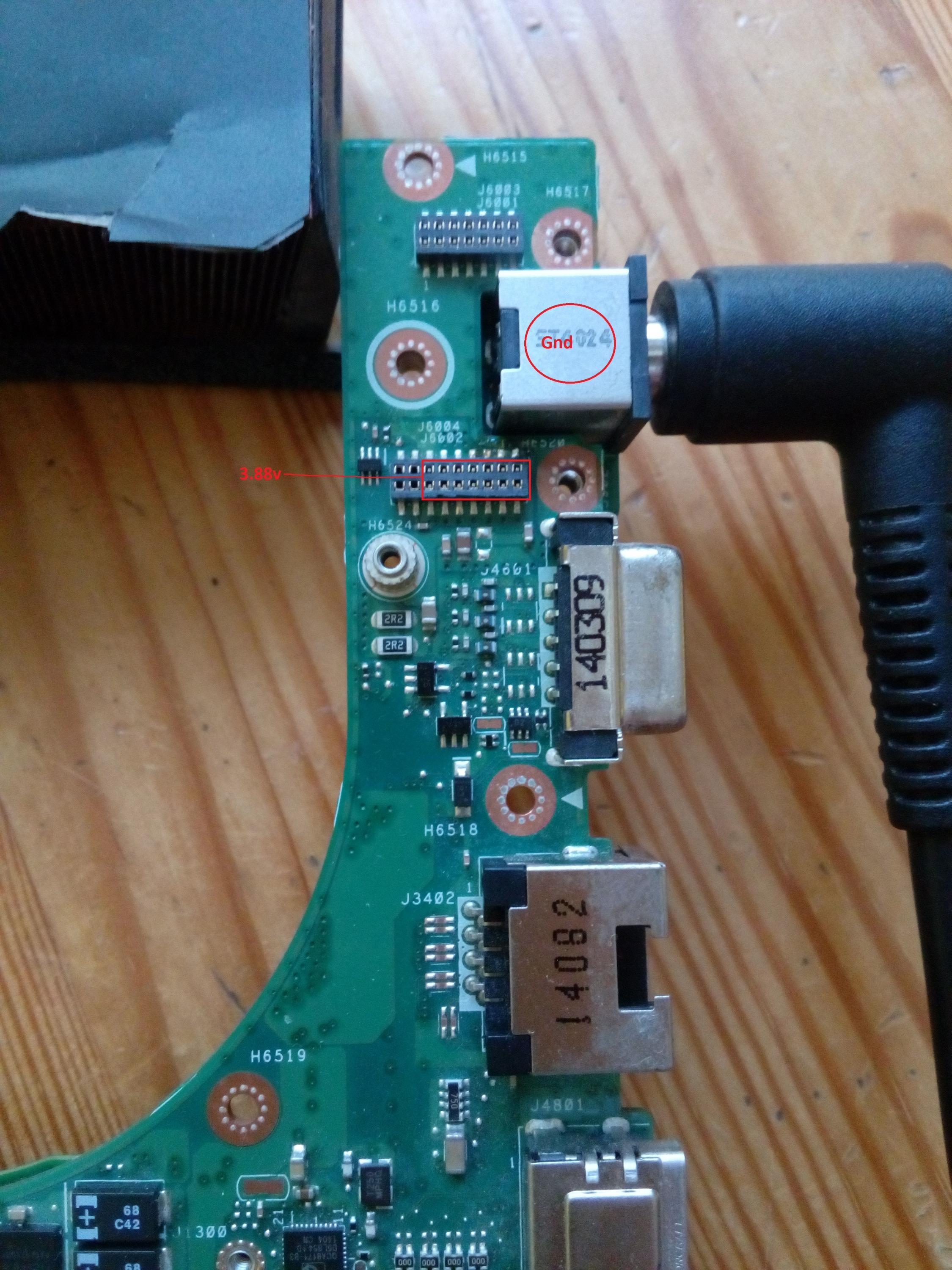

                                  Well if i plug the dcin board to the motherboard and then take ground from dcin board shield or ground on motherboard it shows only 3.88v and on some places only 0.5v. So it might be dcin board?

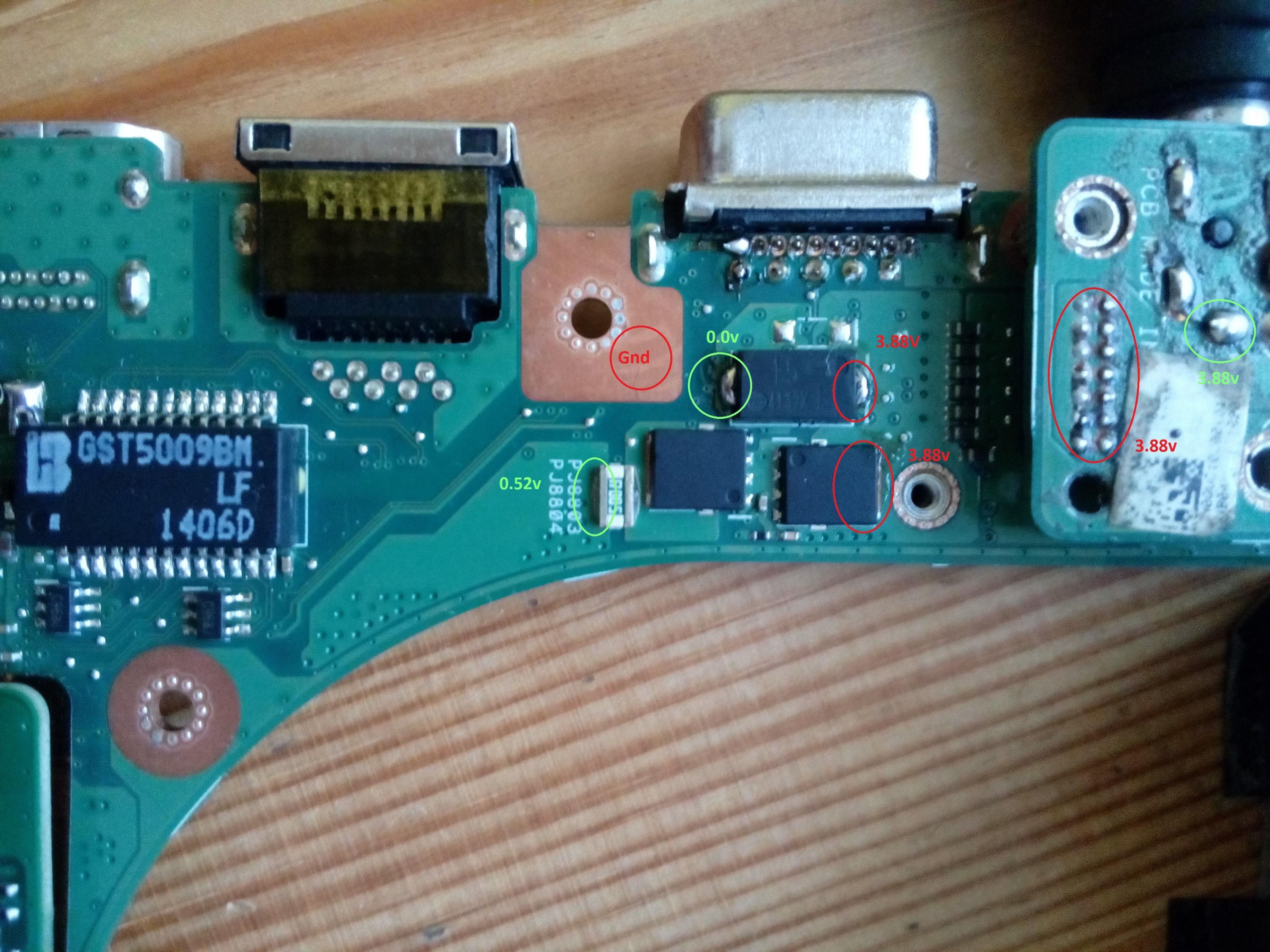

                                    Re: Asus ROG G750JZ
                                    measure voltage on 3 green marked zone

                                      Re: Asus ROG G750JZ
                                      Ok here and thank you for trying to help

                                        Re: Asus ROG G750JZ
                                        read volts on pin 1-2-3 and 4 of first mosfet where u have 3.88 volts incoming.
                                        then remove dc from mainboard and see if it still 0.388 volt or go up to 19 volt on that green pin on dc board.
