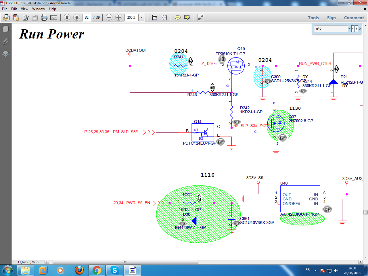

    hi eveybody i need hekp with mu Dv2000 Not worck not turn at all
    when i plug dc cable bleu led worck on power jacket
    3.3 in power buton but not turn the fan
    ic power maxim8725e make 3.3 and 5 is Good
    need help please diagram
    Akita Mb
    48.4F501.051
    052331-5

      Sorry This scematicsDont match with my matherboard

          thnx Friend this is my shematici will reserche for the problme if you have time help me please
          • moateez
            • Jun 2014
            • 119
            • algeria
            Re: no power With Hp Dv 2000
            Ithink the probleme is in Thsi Ic U40 Idont find it in mather oard it was removed befor the clinet brig the laptop to me
            he is in party of Run Power
            AAT4280IGU
            what is his equivalent

                  Heres the datasheet
                  After a quick google search for a "sot23-6 Slew Rate Controlled Load Switch"
                  https://cdn.badcaps-static.com/pdfs/...7479e797a1.pdf
                  Compare the 2 parts, voltage,rds, slew rate. This looks like a good alternative SiP4280-1-T1-E3 .There`ll be more alternatives,you just have to search through datasheets.
