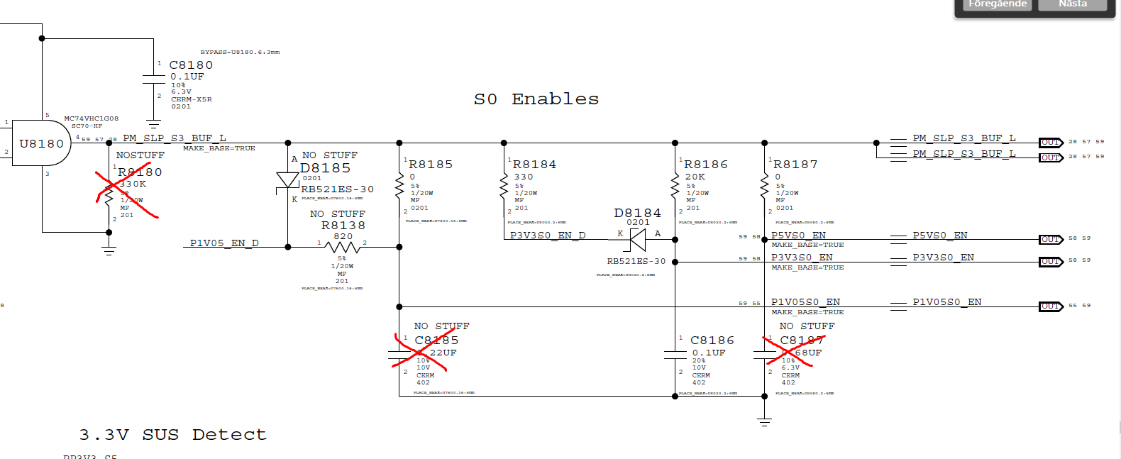

            Unfortunately i don' t have this tools for that at the moment. However I just noticed that U7600 and U8080 gets really hot to the touch when i plug in charger, but i cant see how this could impact the 1.05 V rails as they come from the PP3v3_S4SW_SNS rail right?
              • 20952
              Re: 820-00165-02 missing PP3V3_S4SW_SNS rail
              Why are U8080 and U7600 getting hot,and what do those IC`s have in common ? U8080 pin 2 P5VS0_EN .U7600 pin 16 P1V05S0_EN .
              Look at the S0 Enables rail ,page 59 on the schematic.Test voltage,ohms on U8180,R8180,C8185,C8186,C8187.
              • cj_002
                • Jul 2018
                • 8
                • Sweden

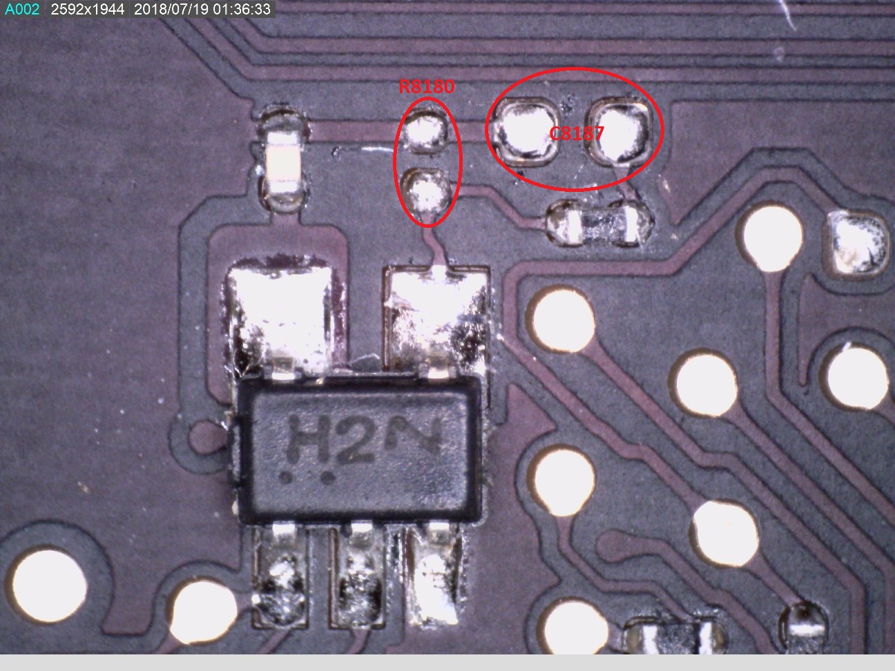

                Thanks for your input! On U8180 i have:
                Pin 1&2: 3 V
                Pin 5: 3.3 V
                Pin 4: 5 V (is this to high?)
                I also checked the resistors and caps you asked for: C8186= 4.98 V however I'm missing R8180, C8185 and C8187, it seems as if they were never placed on the board ill attach image:
                  • 20952
                  My bad,those parts are "no stuff" ,i must have been tired.... . What else does U8080 and U7600 have in common, U8080 pin 1 PP5V_S4RS3 ,U7600 pin 12 PP5V_S4RS3 . Check PP5V_S4RS3 voltage,check if its stable .
                  • cj_002
                    • Jul 2018
                    • 8
                    • Sweden
                    U8080 and U7600 both have enables from U8180. Since U8180´s output is 5V on both P5V_S0_EN (U8080) and P1VP5S0_EN (U7600) this might be why they get hot? U8180 being a logic gate should just output the 3,3 V from PP3V3_S5 right? However the board seems to be in S0 state since all S0 rails are present and stable except PPVCC_S0_CPU. Not sure how to proceed.
