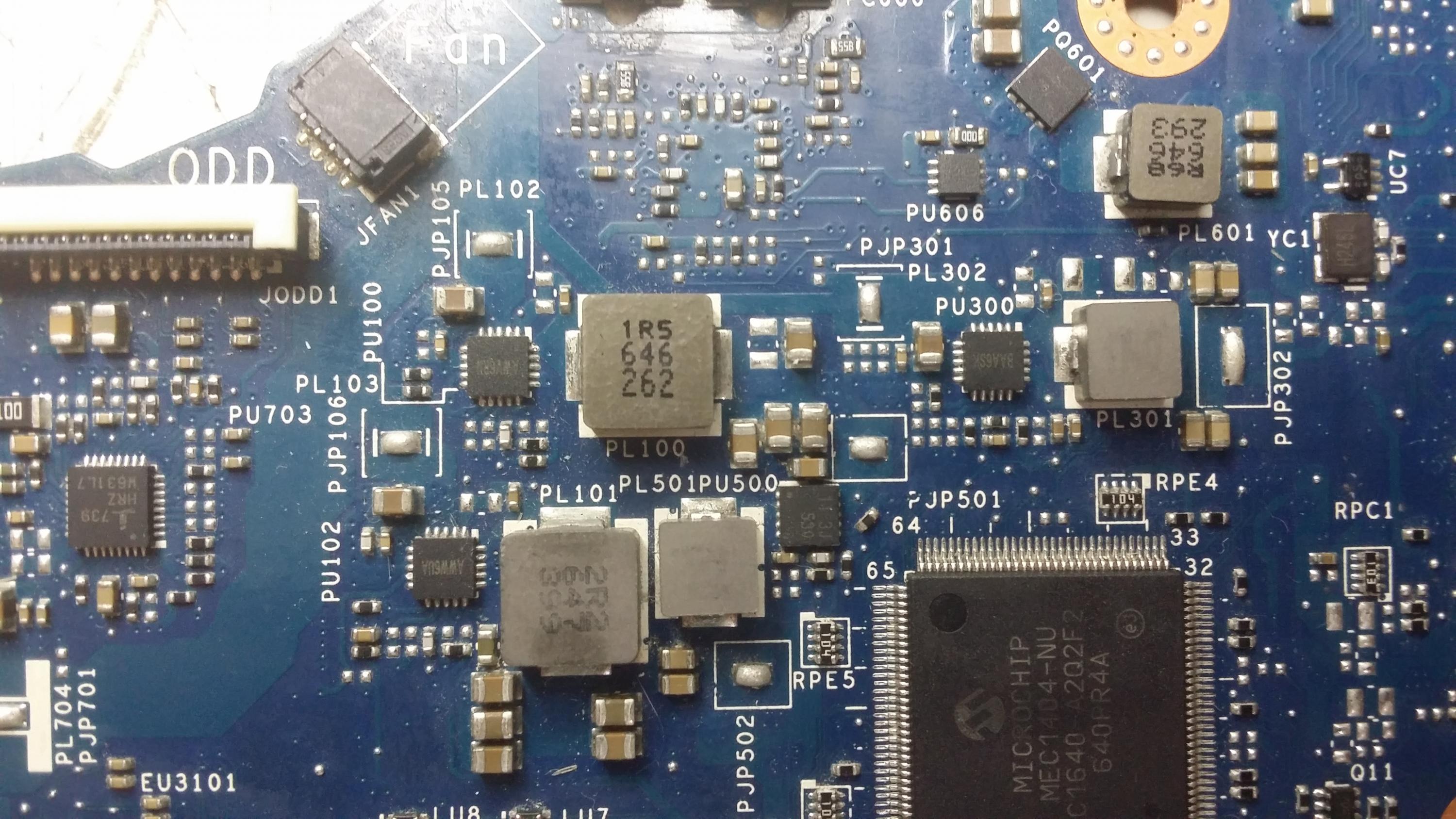

    Hello.
    Today i received a Dell Inspiron with LA-D801P motherboard.
    Customer's son spill some orange juice on it from the bottom ventilation holes and laptop completely died.
    I clean up everything with Isopropelene Alcohol but still completely dead, no power, no leds.
    I receive voltage at the adaptor input in board and that's all.
    Any help appreciated, schematic attached. LINK to schematic - https://www.badcaps.net/forum/troubl...74#post1242174
    Thank you in advance!!!

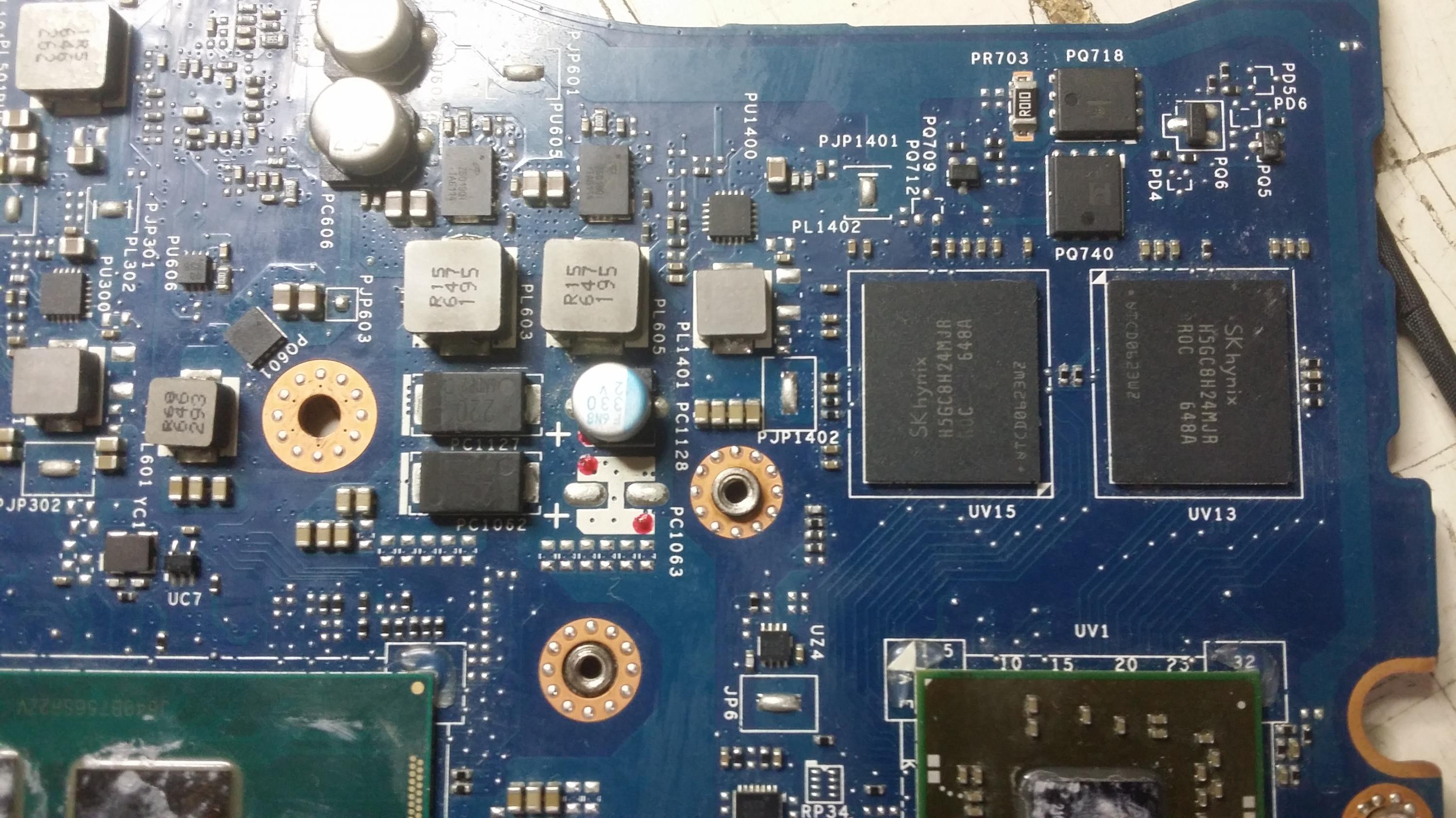

            Re: Dell Inspiron LA-D801P Motherboard completely dead
            PL1 has 19v in both pins, PL2 no voltage at all.
            PU102 is 0v at pin9 and 5v at pin 19
            PR703 is not present (check picture top right)
            PQ740 is 19v in pin1, pin4 24.7v, pin5 19v.

              Ok, next test voltage on PU100 pins 2,11,12,17,19
              • Andreasbest
                • Aug 2014
                • 1153
                • Hellas ( Greece )
                PU100 :
                pin2 19.6v
                pin11 4.5v
                pin12 2.3v
                pin17 3.3v
                pin19 0v
                  • 20695
                  Ok, so you`re missing +3VALWP , next,with no power to the board test PR121 if its on the board, it should be 0ohms and/or check for short to gnd pin 19 of PU100
                    Didn't manage to find PR121 but pin19 has a shortcircuit (0.004Ω) with ground
                      • 20695
                      Ok , so it might be PU100 that needs replacing, or some other part on the +3VALWP rail. Take off 1 at a time PC106 ,PC107 ,PC108 , and PC109 .check for short after removing each ,and put back on if the short is still there. If its still short after checking those remove PU100 and check short on pin 19 again, if its gone replace PU100 .
                        Since i don't have boardview i'm not sure what smd are pc106,pc107,pc108,pc109.
                        Do you think they are these 4 smd bottom right of the PL100?
                          • 20695
                          In this case, yes it will be those 4 big caps to the right of PL100.I can see some crap in between the caps.Put some liquid flux around those caps and heat that area up and clean it up with a brush. Test if the short has gone, if not you have a choice, take off PU100 first or the 4 caps,the caps are all the same value so can`t mix them up.
                            remove pjp102 solder with desolder wick and see if 3.3 volt comes to pl100
                              Removed all capacitors and PU100 but shortcircuit is still there.
                              Removed PJP102 (with ic and 4 caps off) and shortcircuit gone.
                                put ic and caps back in plase and see if on pl100 u have 3.3 volts (all with pjp102 still desoldered)
                                  • 20695
                                  Ah i missed out pjp102,so the short is on +3VALW ,its going to be a difficult repair, unless you can find any obvious damage to any of the parts on that rail.
                                    Put back everything in place.
                                    As i said without jumper the shortcircuit is gone but still no voltage at PIN19.
                                      page 4 of schematic, followind 3.3 volt line , check following pjp point to track where the short is.
                                      try remove pjp501... still short on pjp102 +3VALW side ?
                                      remove pjp801, then jp5, then jp9.
                                      wich one remove the short ?
                                        • 20695
                                        @Dellxps15 ,do you think pin 12 of PU100 is low 2.3v
