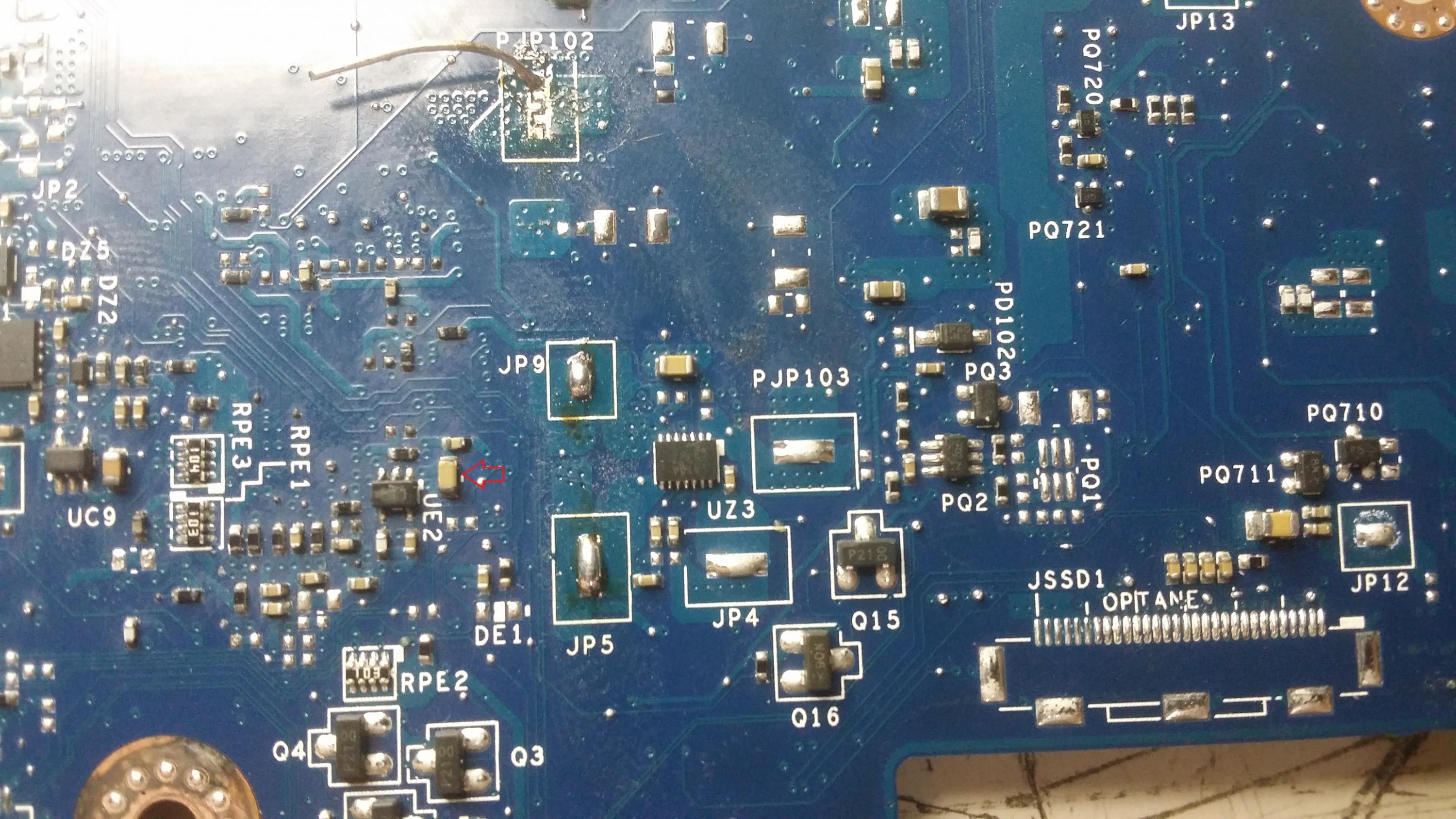

      Re: Dell Inspiron LA-D801P Motherboard completely dead
      @dellxps15 removed pjp501,pjp801,jp5 and jp9 but shortcircuit is still there.
      @SMDFlea no the one side is still with shortcircuit.
        Remove UZ3 next, check if the short is gone .
            After you removed all the jumpers the only thing i can see thats left to check is UZ3 . If you want to wait to get a second opinion from @Dellxps15 or another member thats ok ,it is quite hard to solder,you need lots of flux and put new 60/40 solder on the pins.With such small pads its easy to damage the pads,don`t have the iron too hot,use lots of flux,run the iron across all the pads at once or with a fine tip and solder do one pin at a time.

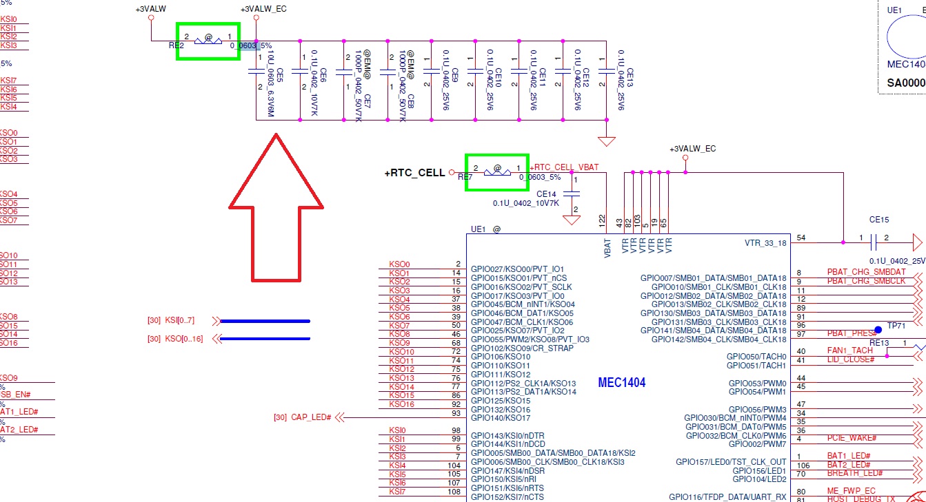

                        #31
                        Hello again.
                        Got a little problem with my connection but now it's back again.
                        Yes i got a lab psu, i set 3.3v at 3A and found that a small SMD is getting really hot, it looks like a capacitor and i remove it, it's shortcircuited indeed.
                        Problem is that i don't know what capacitor is to replace it.
                        Check attached picture please.

                          • piernov
                            • Jan 2016
                            • 4439
                            • France
                            #33
                            Not sure what value it is, maybe 10uF. The board may work without it, but try to take a capacitor from a 3V line of a donor board that's of the same size to replace it.
                            This section looks like to have been badly damaged by the liquid. You should take note where the liquid hit the board before cleaning everything.

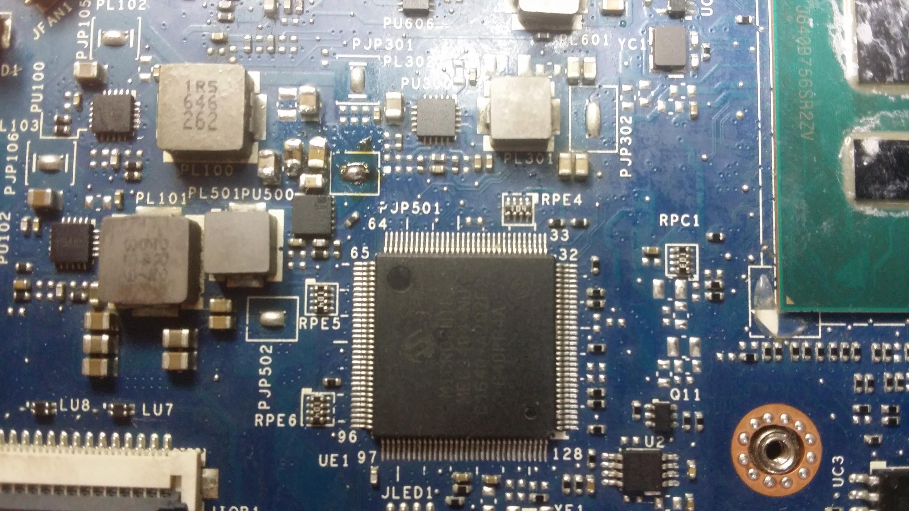

                            • Andreasbest
                              • Aug 2014
                              • 1196
                              • Hellas ( Greece )
                              #34
                              No it doesn't work, 3.3v are not back.
                              Perhaps the capacitor is reuired in order to get 3.3v?
                              The liquid hit on the other side of the board, was plenty so almost all other side needed clean.
                              Picture of the other side of the capacitor attached, it's under UE1 and kinda left as you see it in picture.
                              Checking other motherboards for same size cap in 3.3v channel meanwhile.

                                • Andreasbest
                                  • Aug 2014
                                  • 1196
                                  • Hellas ( Greece )
                                  #36
                                  Since i removed the capacitor in previous picture the short is gone.
                                  Capacitor it self is shortcircuited, measure it already.
                                  These 4 caps near L100 are these that i removed after one of the initial posts.Soldered ok, checked.
                                  Now trying to figure out the size of the capacitor.
                                  edit: it's a 0603 (1,6mm length)
                                  edit2: check picture.perhaps this is our cap?
                                  • dellxps15
                                    • Feb 2014
                                    • 1598
                                    • italy
                                    #37
                                    u have to follow the "+3VALW" line ... capacitor was shorting that ...
                                    and that 0603 is a resistor...
                                    edit: or 10u or 22U is its value.
                                    • Andreasbest
                                      • Aug 2014
                                      • 1196
                                      • Hellas ( Greece )
                                      #38
                                      I don't get it mate, what do you mean to follow the 3VALW line?
                                      The green mark not mine, i used the red arrow pointing to 10Uf CE5
                                      • dellxps15
                                        • Feb 2014
                                        • 1598
                                        • italy
                                        #39
                                        sorry watched wrong point on ur picture. yes ur right. only 10u or 22u capacitors.
                                        so one of those is the right one, but better look for a 0603 capacitor connected to a 0402 capacitor in same line, as in the picture near ue2 zone.
                                        edit" yes looks like the only one close to a 0402 capacitor is that 10uf value
                                        try powering on pc and see if something happens.
