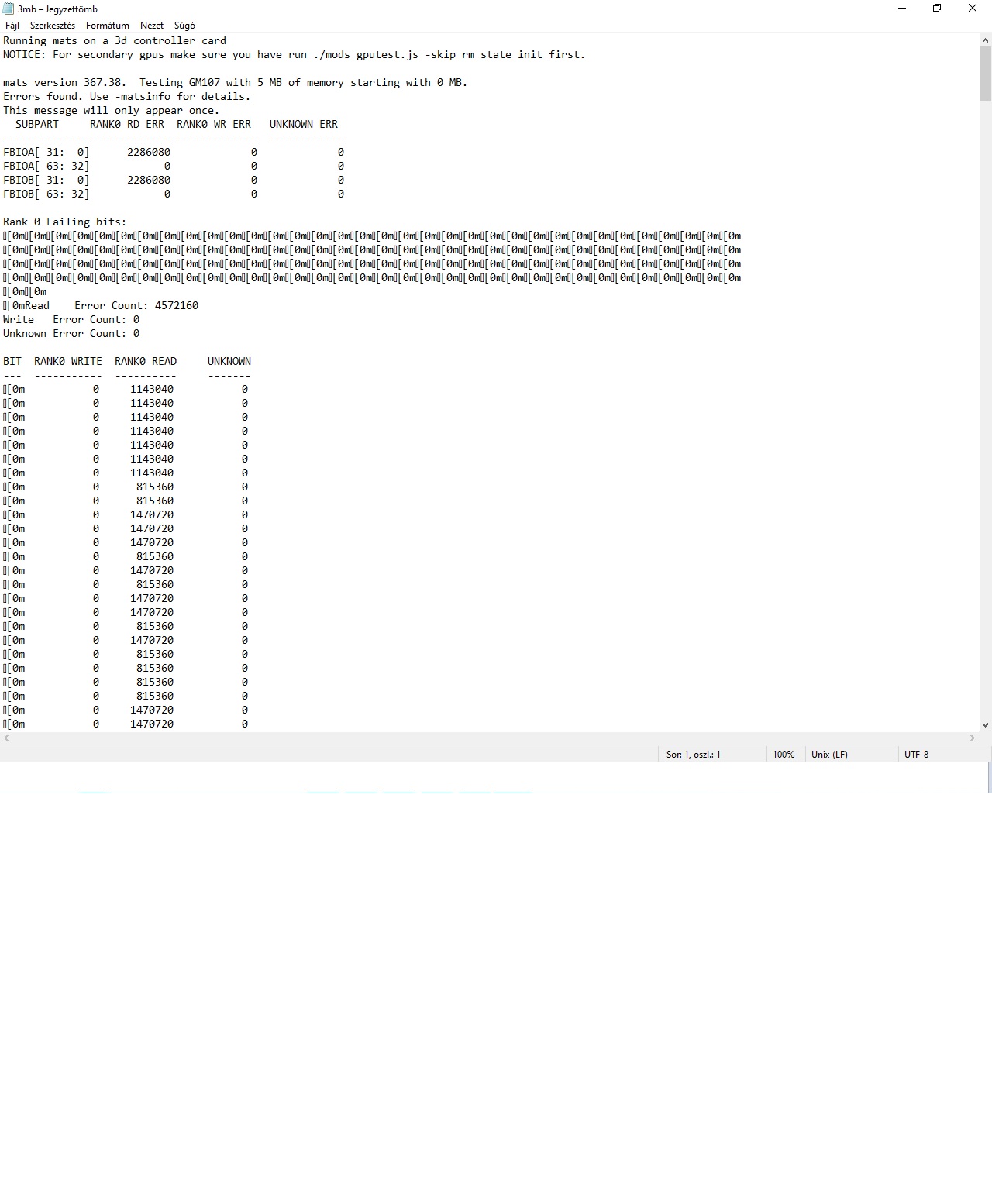

            Re: Lenovo y50-70 gtx860m BSOD on win 10
            GT960M vram error tested with mats, but I don't know which one is wrong
              what is the correct command to test vram
              i have the same laptop model but i cant start test
              please help
