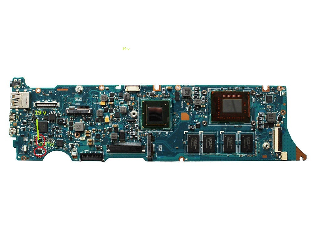

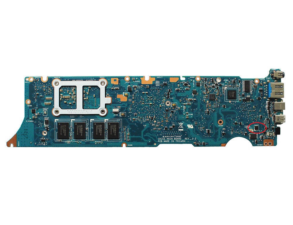

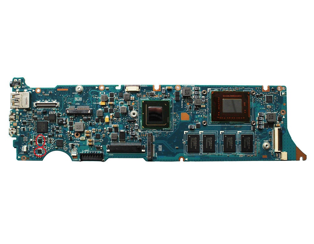

any one have this motherboard
  • maha2005
    • Oct 2013
    • 20
    • tunisia
    hi Brother
    it's possible make photo hi difinition when i can read the reference for thes mosfets

    Although You can try to repair. may i know and others, What is the Problem of This Asus Laptop?
    • maha2005
      • Oct 2013
      • 20
      • tunisia
      Re: any one have this motherboard
      it's dead i have 19 v dc jack and for bin for mosfet
      and another extremite i have 0.75v
        thanks brothers
        problem is solved

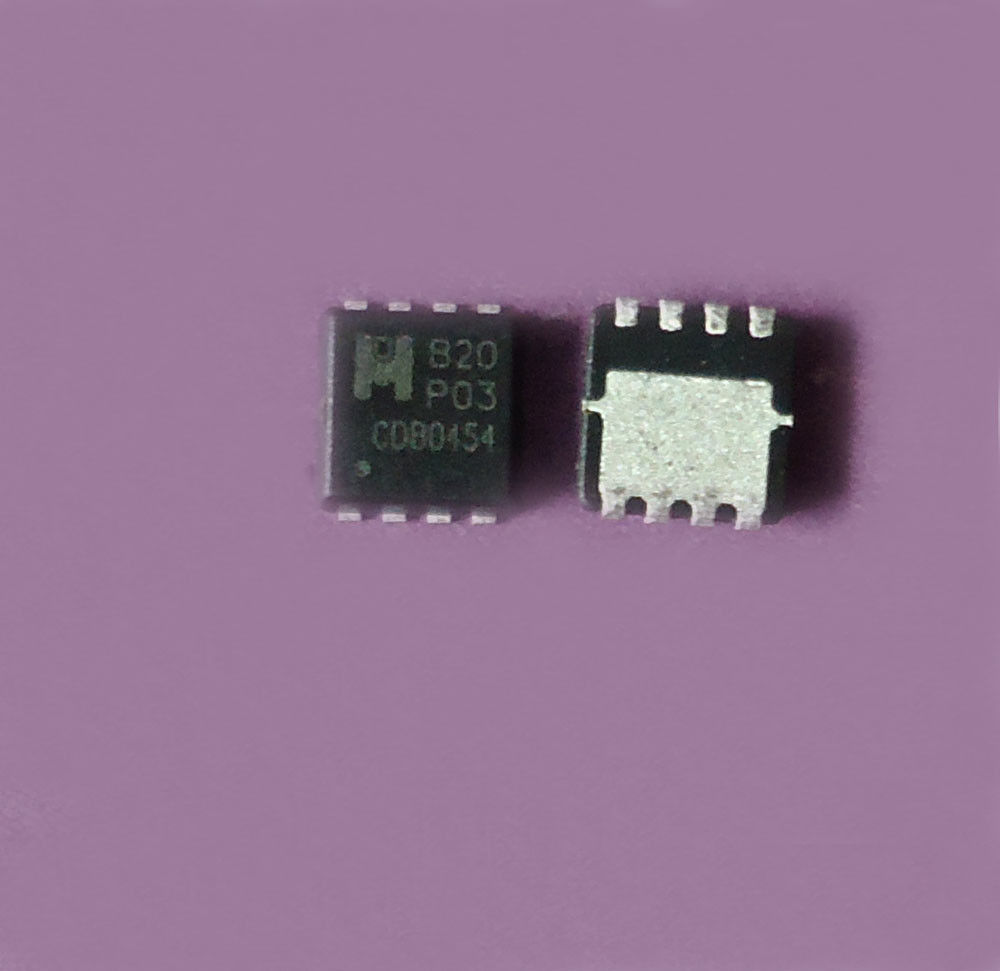

        these mosfet are p channel reference EM B20P03
        amd my zenbook ux31e are worked now i change the charger ic
        BQ24740 by another BQ24751a
