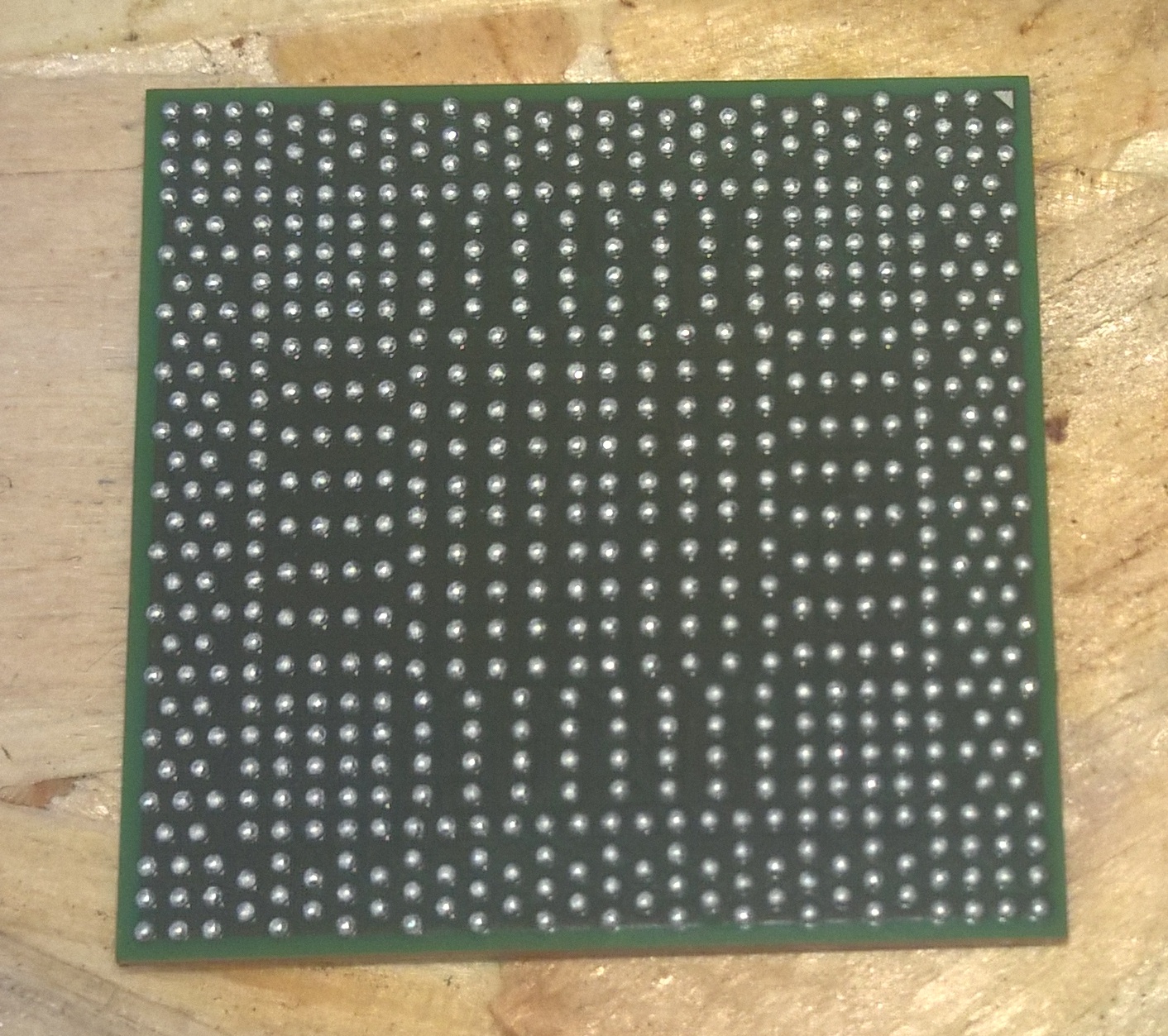

    I've been thru a lot of reballed and remarked chips with a quality of various levels of crap, and my boss still insists on being a cheapskate about it. This order was for my own personal use and some experiments i intend to run shortly.
    At first glance i was able to identify the "bulk disassemble" chips only from comparison with the new ones - they look damn near perfect, and could easily pass as new. Impressive. They will also tell you honestly if they only have stock of a chip as bulk, or if that particular chip they will sell you comes from a lot that has been polished and remarked (for whatever reason). This is info you will never get from any other vendor that i've come across.
    All the chips that I've ordered look good, i have not yet spotted anything suspicious. Now, if they work as good as they look, i will probably stick to this vendor a long time from now.

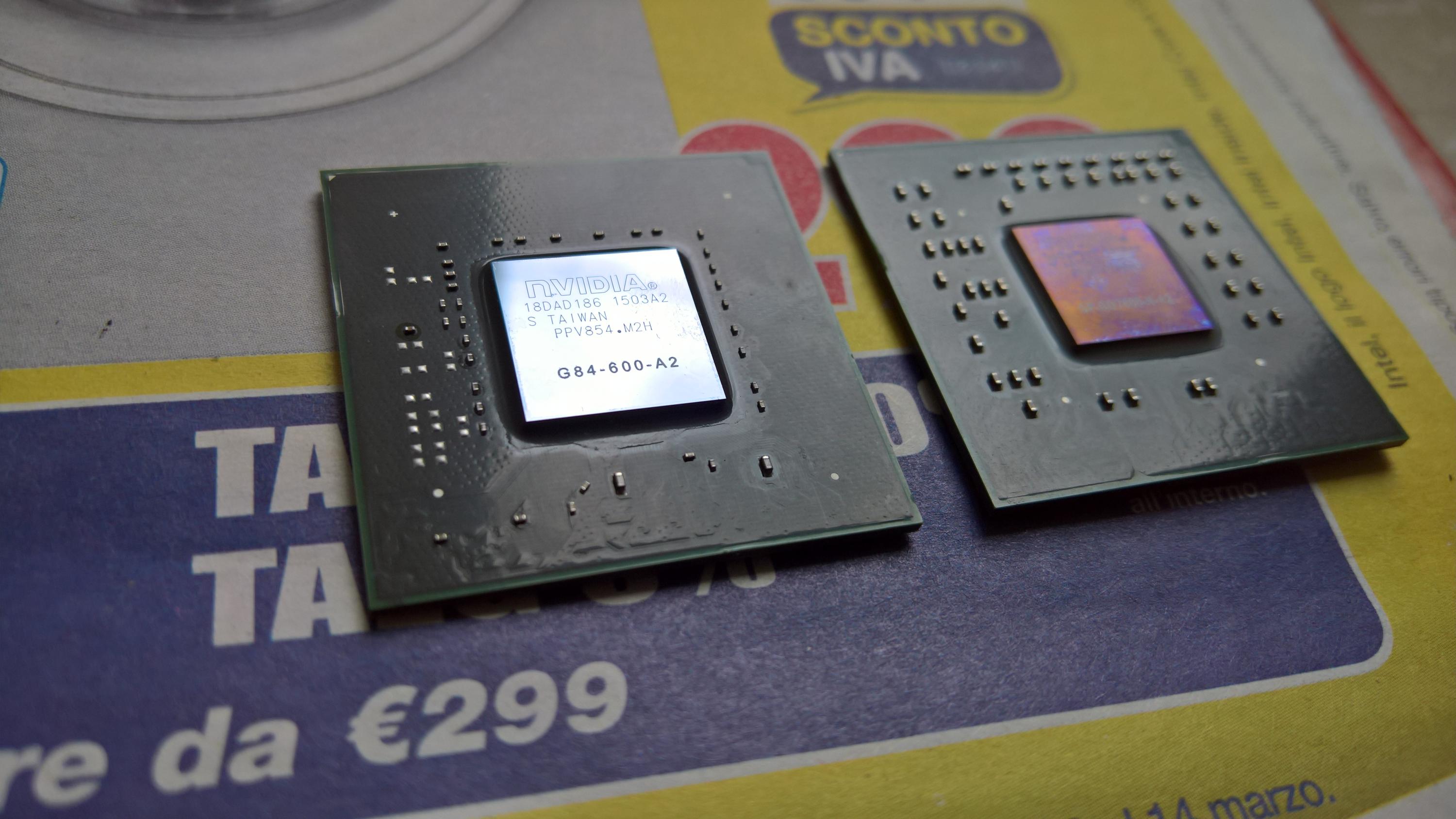

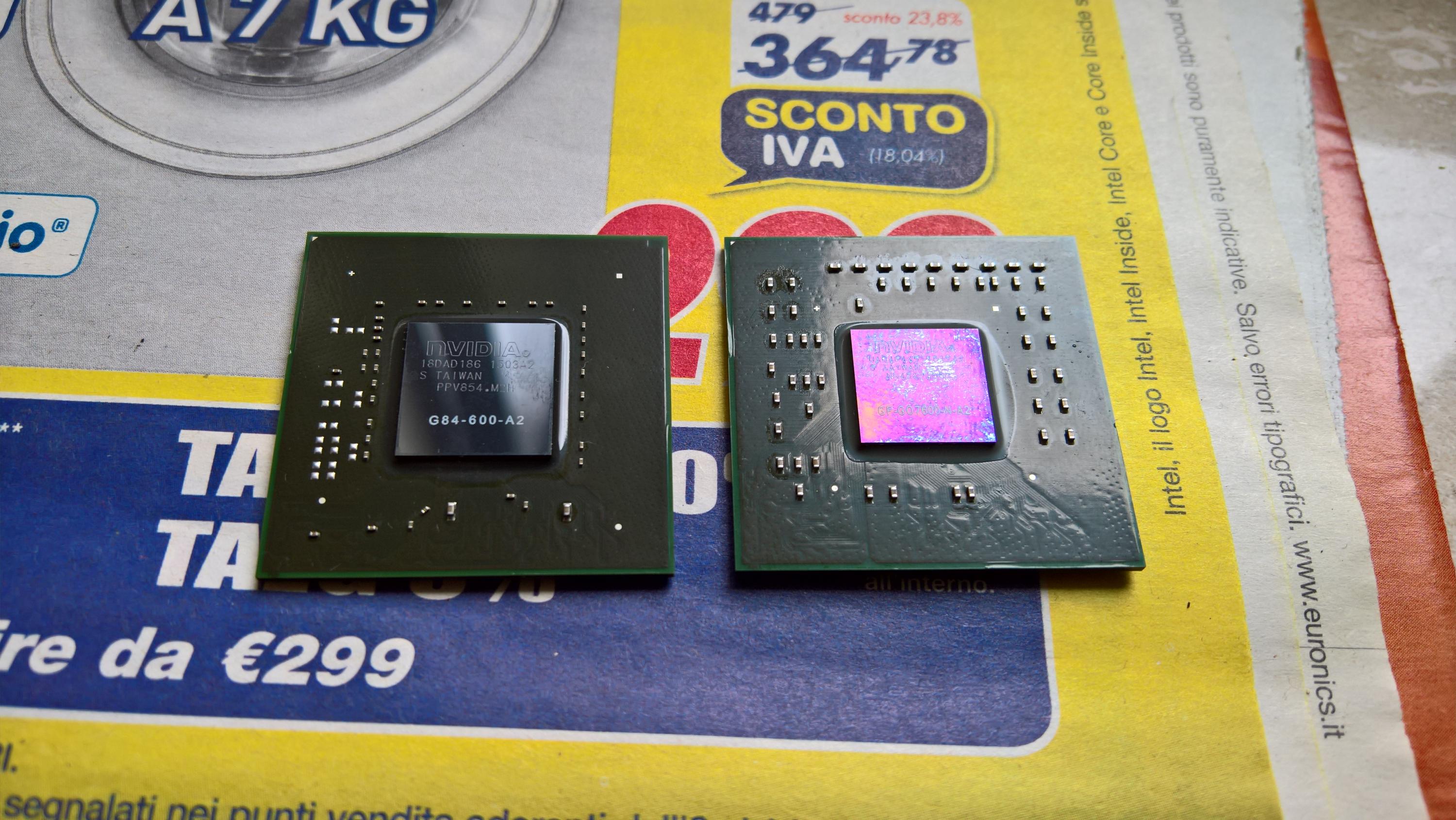

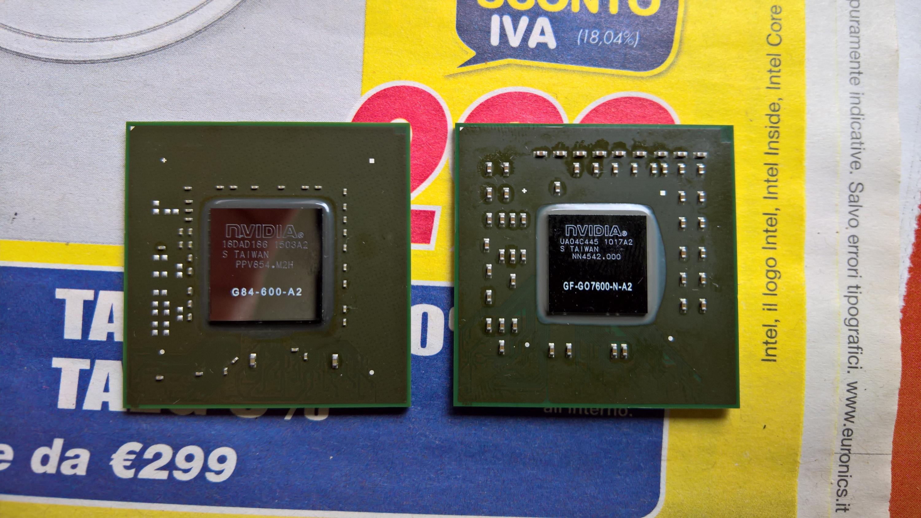

                                ive made an order from golden chipset 1 weeks ago. and im wondering why that geforce 7600 chip has that violet efect on it. other bga like gefoce 8600 and new ati dont have any of that effect.
                                in adddition golden chipset say it's vip member with dlh and as a live in a remote zone for dhl, gc give me 30$ ship cost, while see-ic make me pay 60 or more...
                                e-best ive made my first order with them.. 2 used chip, but i had no experience on rework and chip soldered gived artefact, but that could be my fault.

                                  I paid $25 for DHL shipping from SEE-IC. Guess it varies by country. That geforce 7600 looks alright, i have seen that violet glow on factory-soldered chips too, some are like that. I will upload photos of obviously remarked chip at some point.

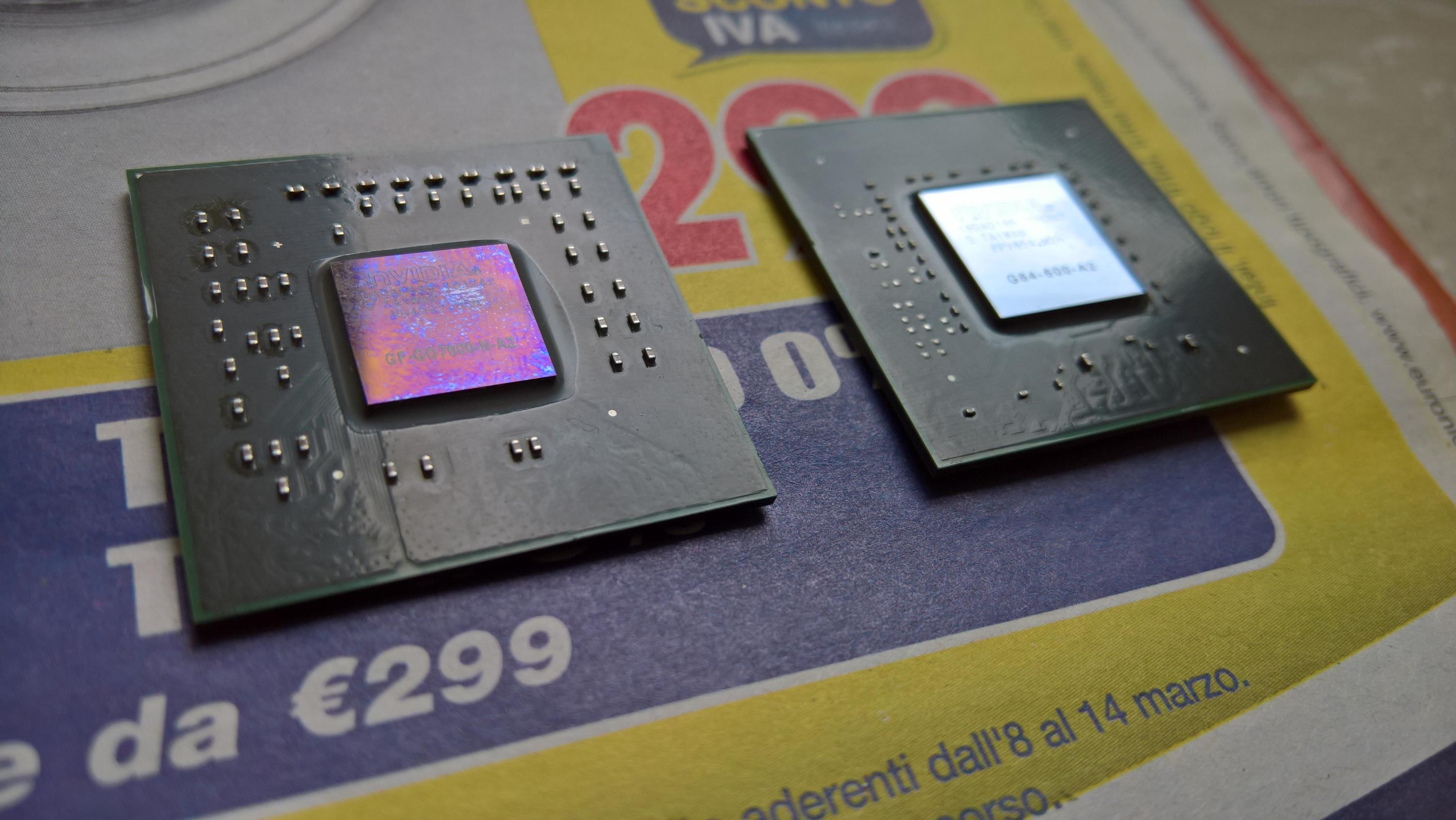

                                    something strange on that chip new from golden chipset.. soldered and working but how could that mistake be possible

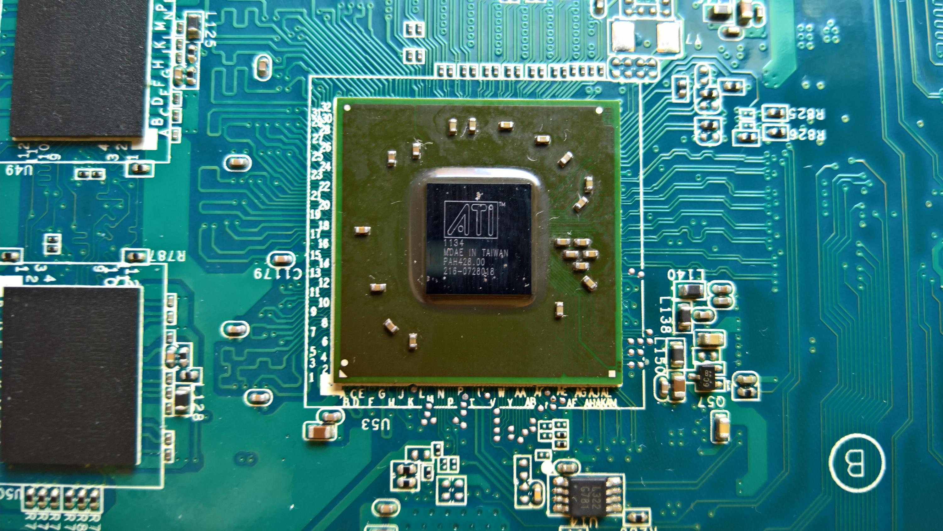

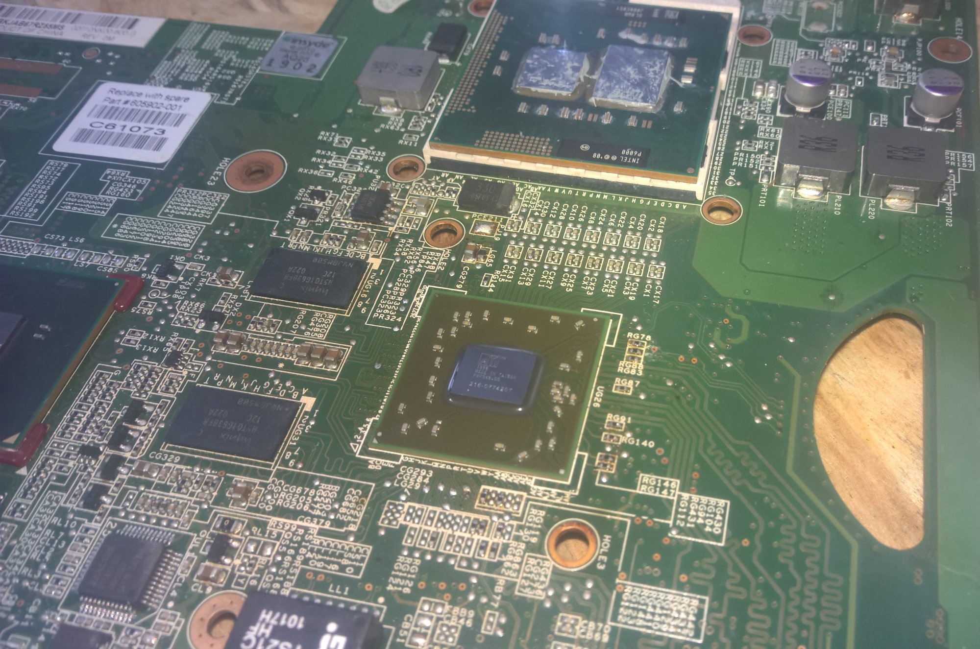

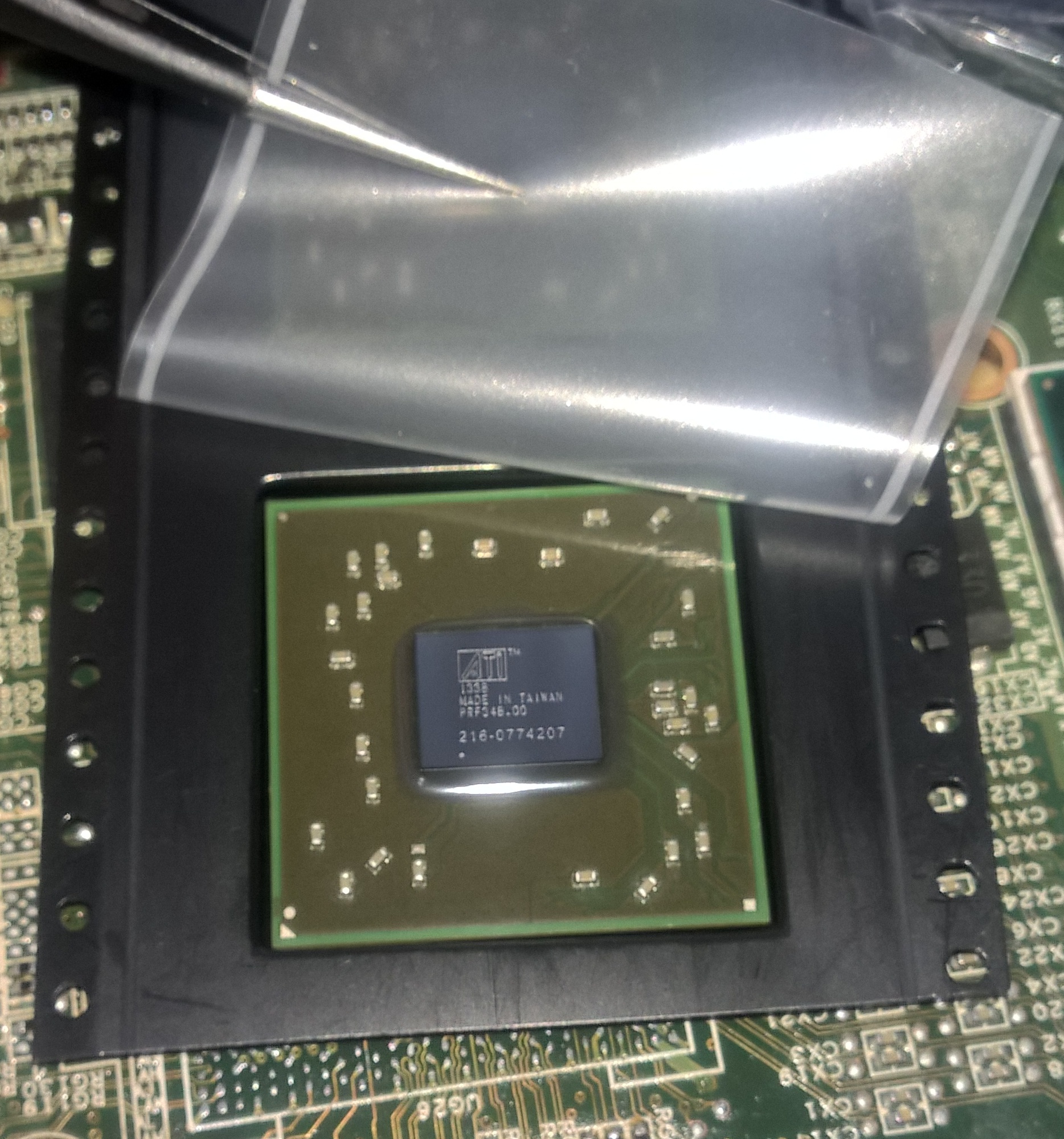

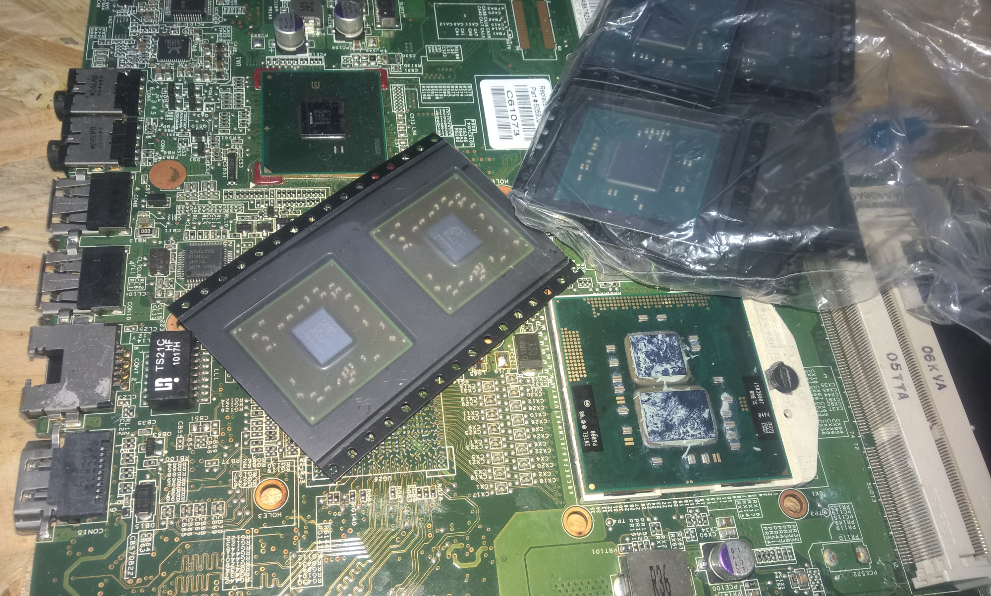

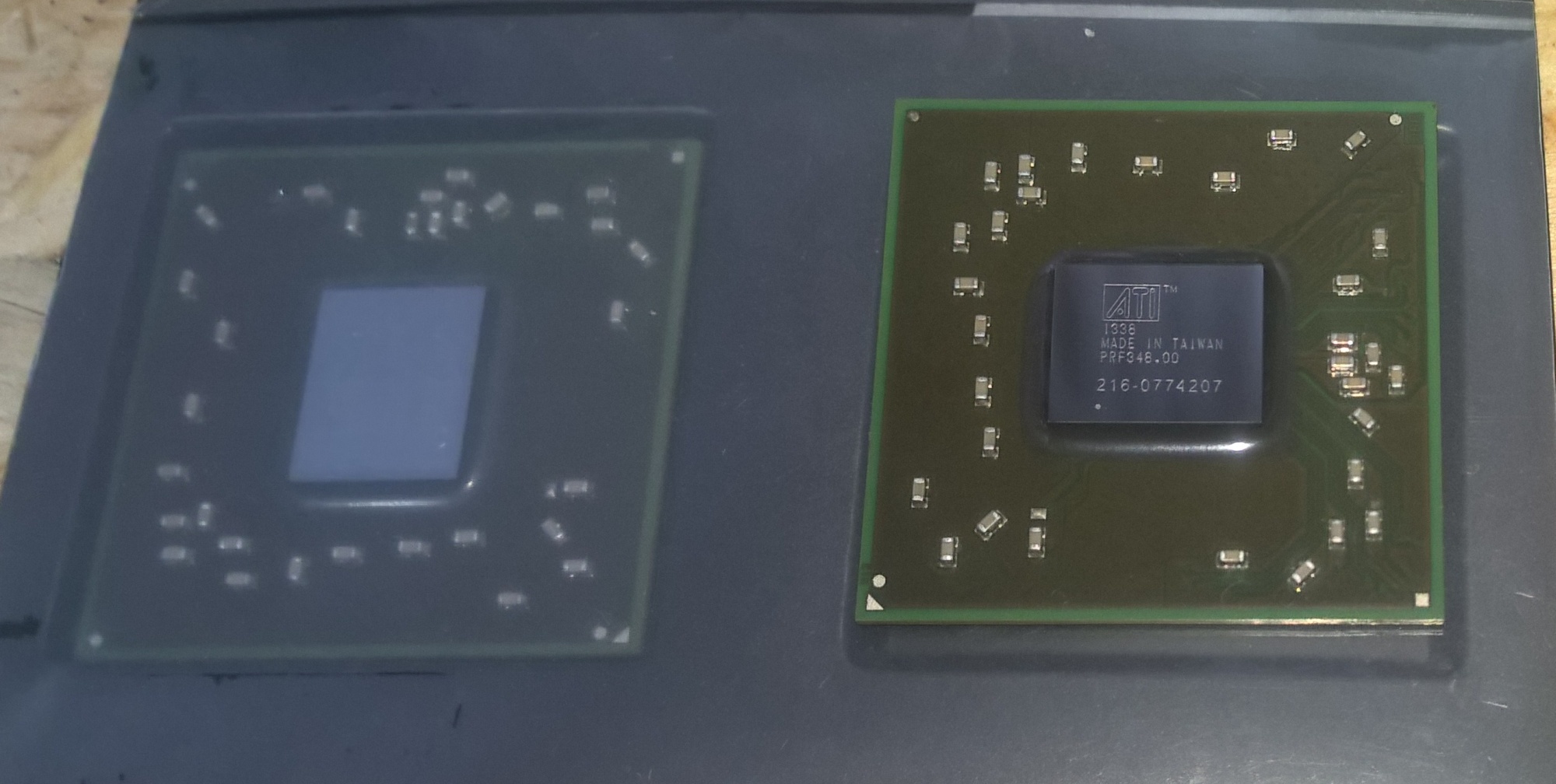

                                      Here are some photos of the chips i received from SEE-IC. I have replaced again 216-0774009 by 216-0774207 (Mobility HD 5470 -> Mobility HD 6370) on HP G62 mainboard PM_I_HPC_S MV_MB_V3 (Foxconn Star Federer), as there is less demand for 216-0774207 and it is therefore cheaper. It is also higher performing (at least per Windows 7 score assesment which i ran back when i first performed this replacement), so this is an upgrade not just a repair.
                                      These particular ATI chips i have bought from SEE as "Bulk disassemble" parts. I have looked very closely and i cannot see any imperfections. They could have easily passed as new.
                                      And of course, the question... does it work? Sure it did. Still no video at first, but i took a good look at the board and i noticed soldering work on the BIOS chip... someone else had a go at this. Flashed BIOS with a known working dump and the screen lit up, CMOS Reset, all the good stuff. Will test it further tonight.

                                        Re: Let's talk about BGA Chip suppliers
                                        The board worked 100%, drivers installed fine and everything. On to the next job.
