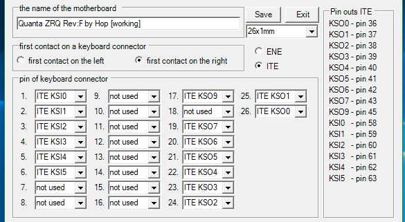

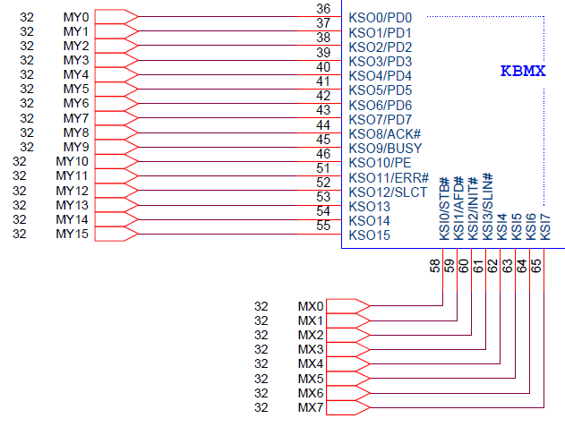

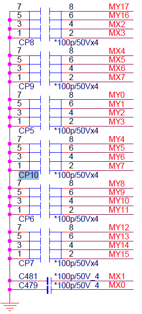

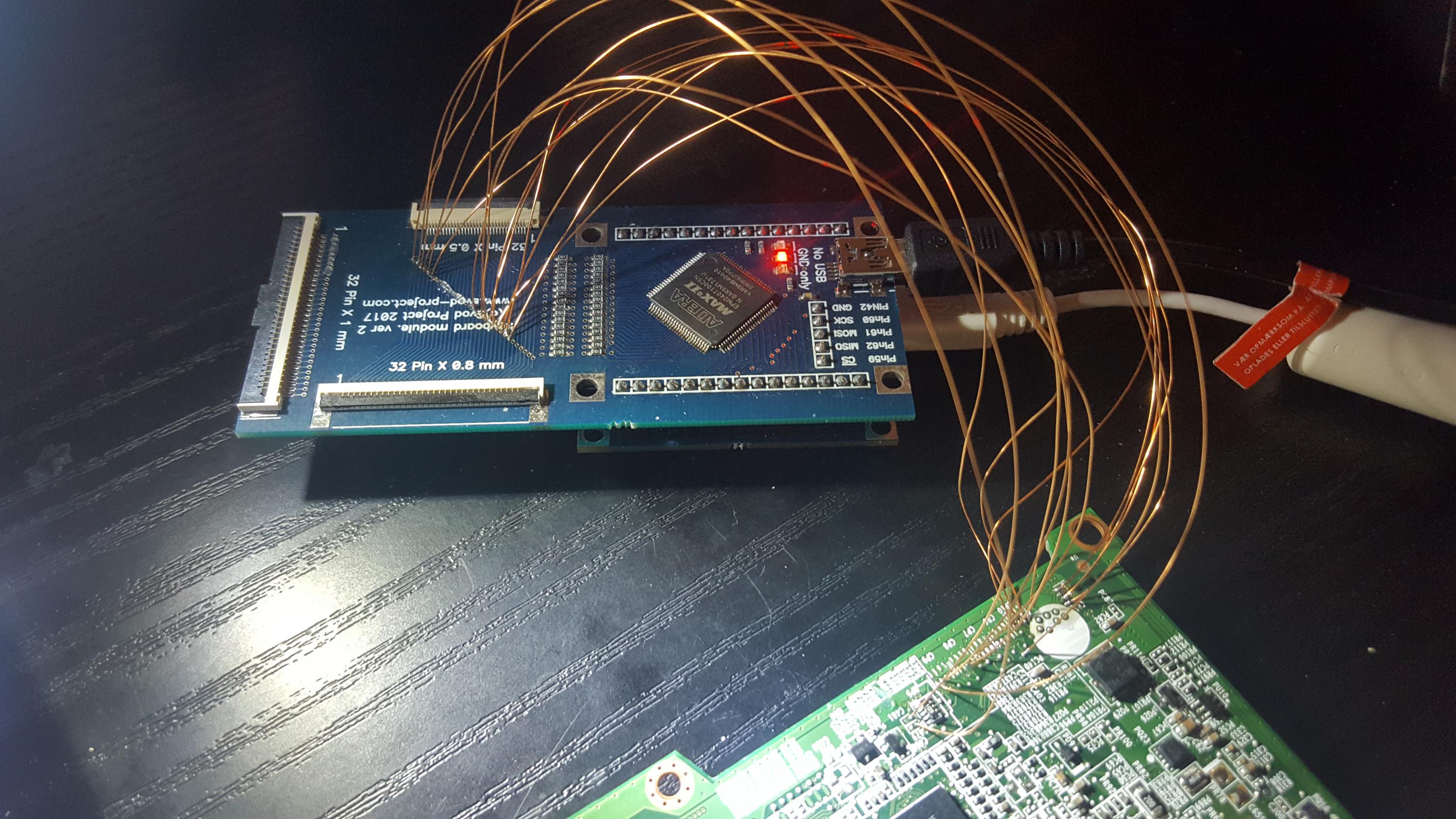

Im trying to get access/reprogram a ITE8587E chip but my SVOD programmer cannot find it
Instead of using the provided cable, I solder all the wires directly to the board accordingly to schematics.
I have attached, schematics, pics, etc.
I took some readings on all pins, if someone knows about this, please enlighten me
Voltage reads, first row is with SVOD connect and second is without, only laptop power connected.
