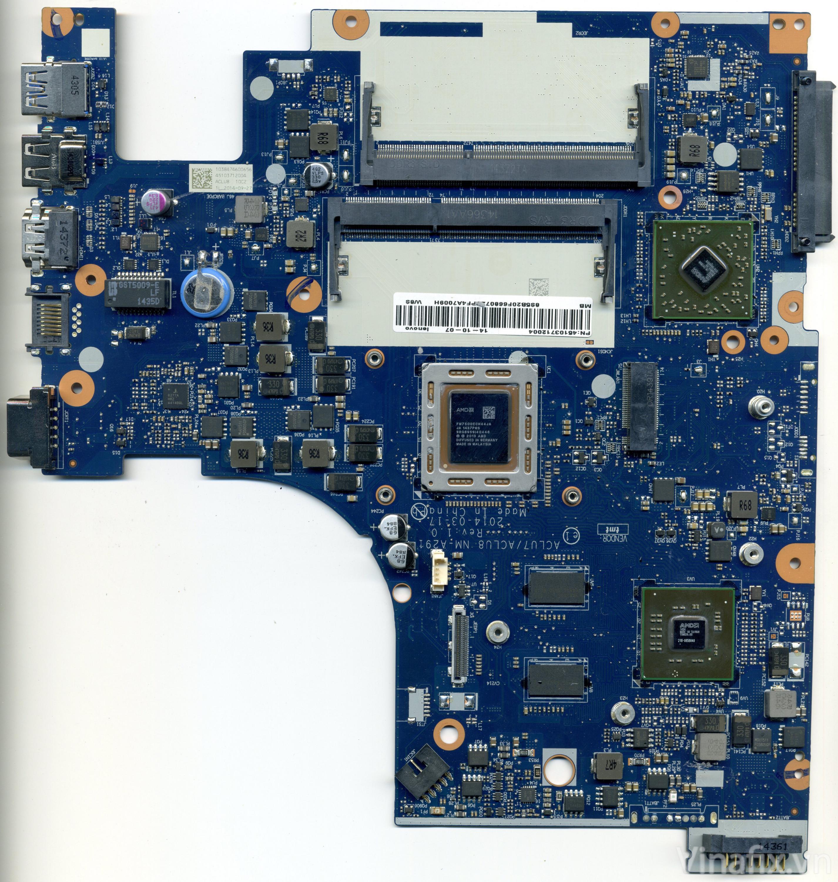

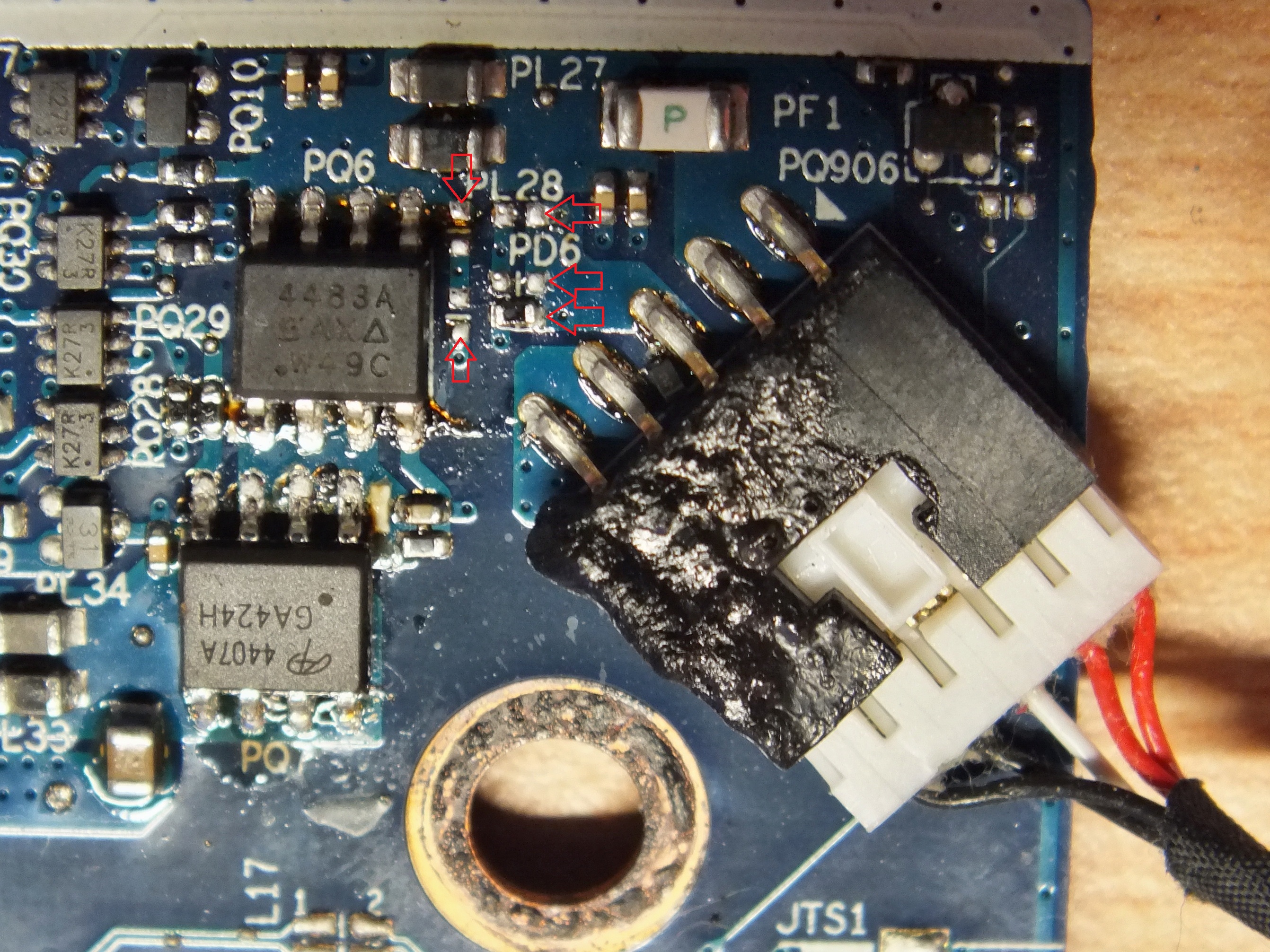

    Dear friends,
    I'd like to ask you for hihg definition picture of MB Lenovo Z50-75 ACLU7/ACLU8 NM-A291, especially near power conector.
    As you can see on my picture, somebody made some experiments and I'm not sure, if there are not some missing components.
    And if anybody can help with the values of missing components, it would be highly appreciated.
    Many thanks

    Re: Lenovo Z50-75 NM-A291 HD picture or help with components
    Sir i not have values, more send photo....
      The blank space just below PD6 will be a capacitor and just below it will be blank(so you need to remove that resistor. The other two are resistors but dont know the value.
        Not an hd photo but will certainly help you.
          Hi, just use the schematic for the Lenovo G40-45 NM-A281, page 51 will give you an idea of the value of these components.
            Thanks guys for your help, especially newfoxinformatica for that photo which helped a lot.
