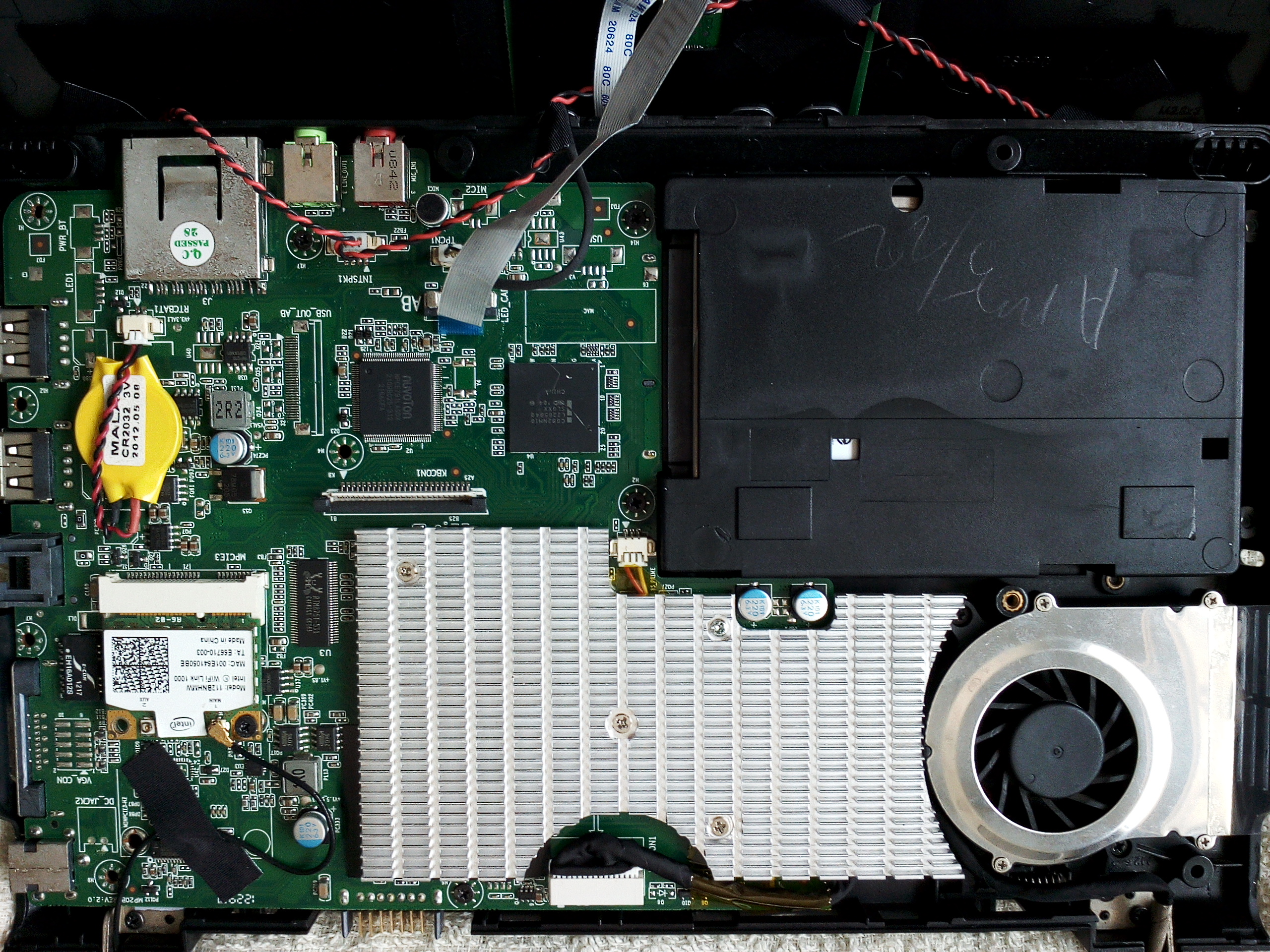

    Have been using this low end netbook since
    year 2012 without issue but suddenly it shuts
    down after about 3 hours use. I reboot by press
    on button, it starts but shut down again before
    the bios screen appears. Not battery issue since
    I plugged on the ac adapter.
    So i thought it is a heat problem and open up
    the casing. Cleaned the cpu fan using a brush
    and i also reapply new thermal grease on the
    heatsink. But it still shuts down after 3 second.
    Appreciate for any help on how to resolve this
    3 second shutdown. Thank you in advance.

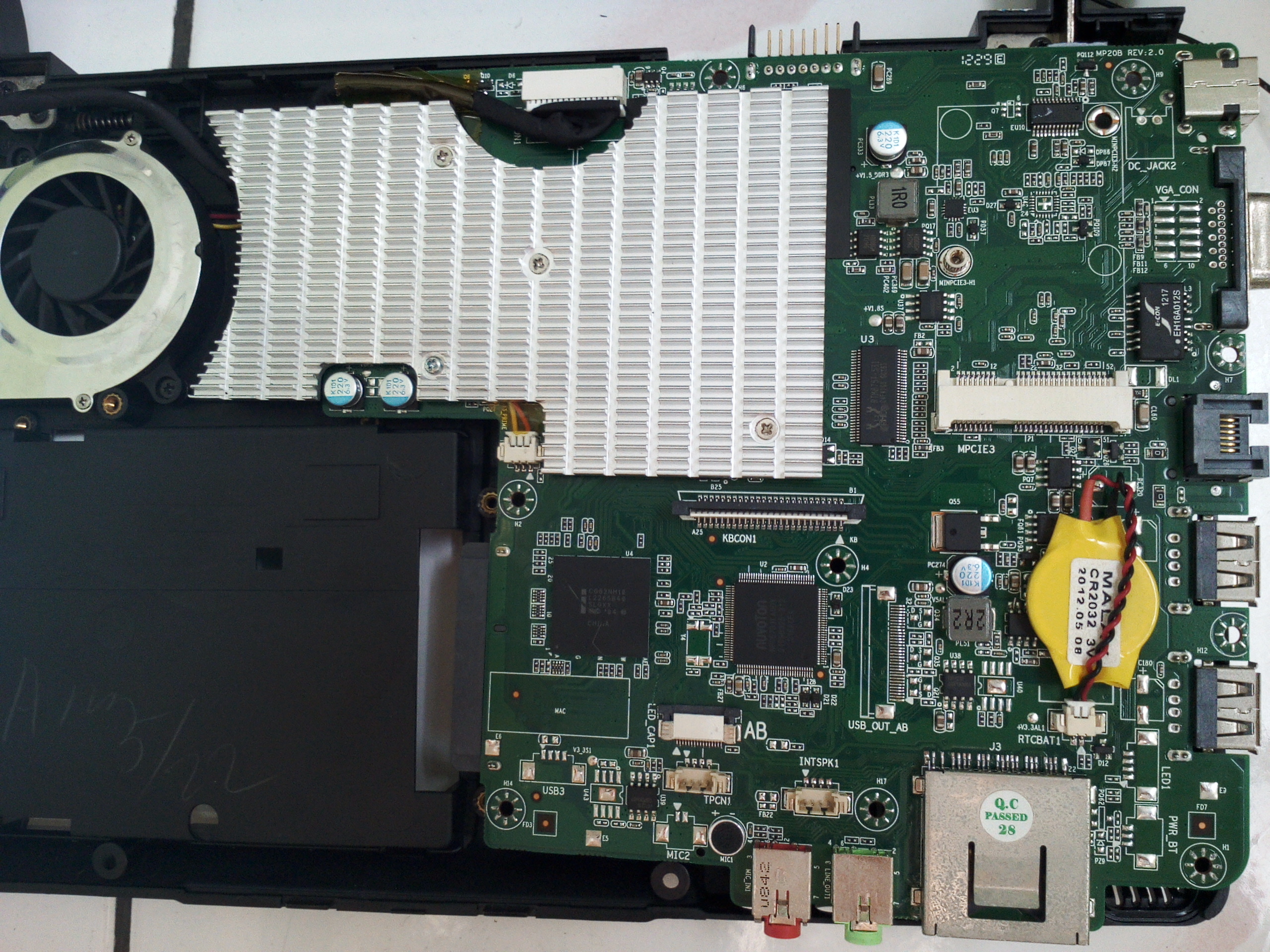

    Today i try plug in ac adapter and do some voltage test.
    On front of MB(motherboard), i put my black probe of
    my Dmm(digital multimeter) on screw hole while red probe
    on top right DC_JACK2 got reading of dc 21.3v. My ac adapter
    output dc19v. Too bad i am unable to get any schematic on
    this netbook.
    Then i move my red probe to almost middle part of MB( near
    chip U3) at FB2 and got reading of dc 3.7v. Next i probe at FB3
    which also reads dc 3.7v.
    Going further down on right hand side of yellow cmos
    battery, i put red probe on +C180 and got reading of
    dc 5.7v. Btw, i check dc on yellow cmos battery is dc 3.1v.

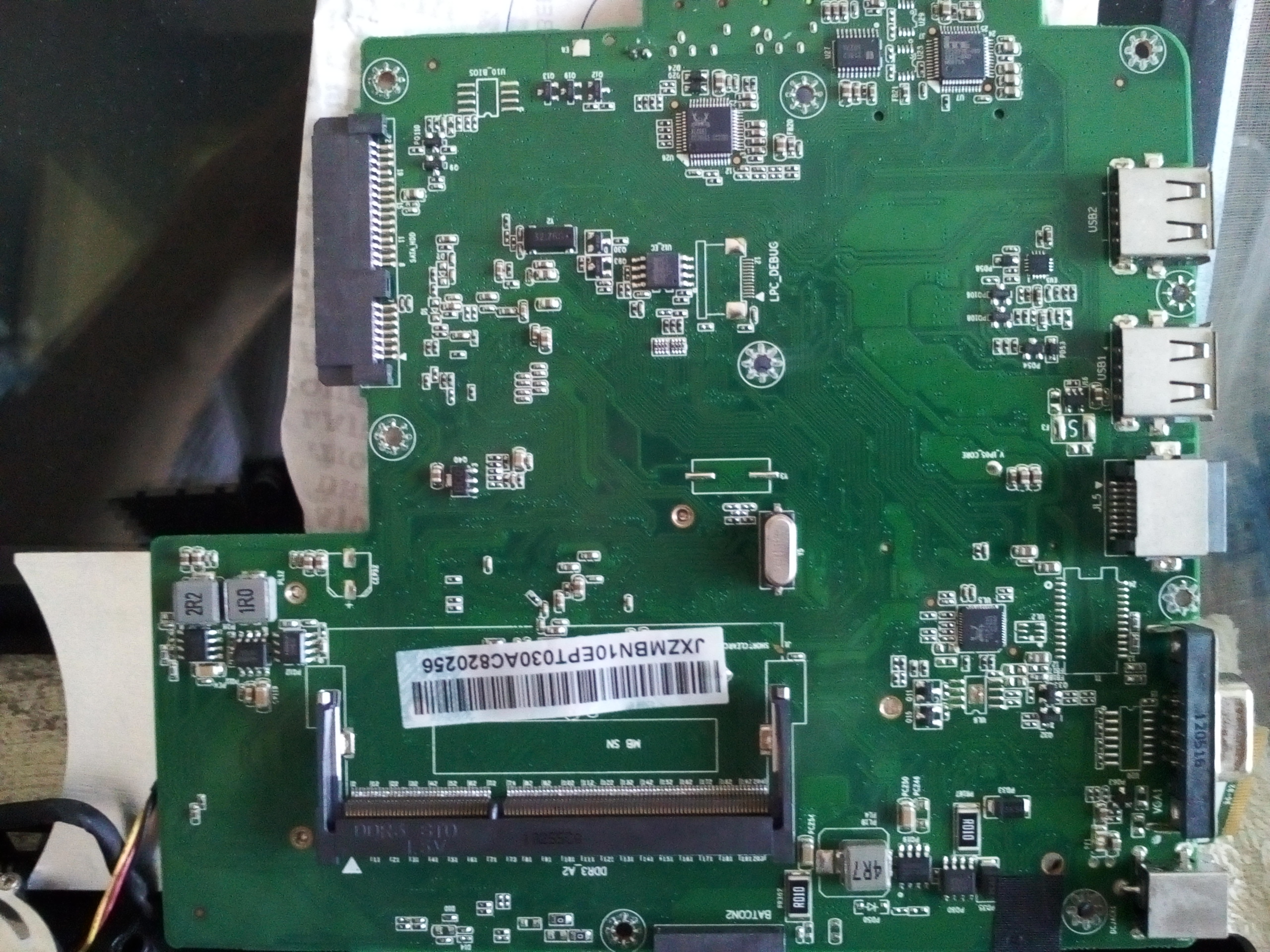

    For info, i had attached front and back of MB. I did not
    notice anything unusual on the back, so did not do
    any test. Still will appreciate your kind help in resolving
    no power. Thank you.

      Hi ,
      Finally got it, the culprit of auto shut off
      after power on is the faulty wifi card.
      Pulled it out of motherboard and netbook
      start power up like normal now.
      Case close.
