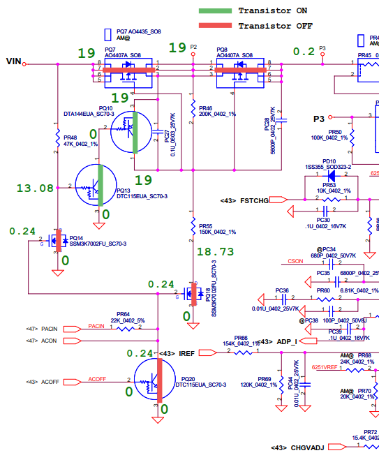

                  The longer explanation...
                  The attached picture shows the state of all the transistors. All the voltages make sense, so none of those transistors appear to be bad right now.
                  - PQ7/8 are off because they have 19V on their gates
                  - The 19V is because PQ10 is on and PQ18 is off. Normally PQ10 should be off and PQ18 should be on, which will place ~8V on the gates of PQ7/8.
                  - PQ10 is on because PQ13 is on.
                  - PQ13 is on because PQ14 is off
                  - PQ14 and PQ18 are (almost completely) off because of the 0.24V on their gates.
                  - PQ20 is off as it should be.
                  That 0.24V is the cause of that whole chain of events. And it is currently unexplained.
                  And, just a small clarification... PQ10, PQ13, and PQ20 are BJT transistors. So, instead of Drain/Gate/Source, their pins are refereed to as Collector/Base/Emitter. Or referring to them by their pin numbers is good too.

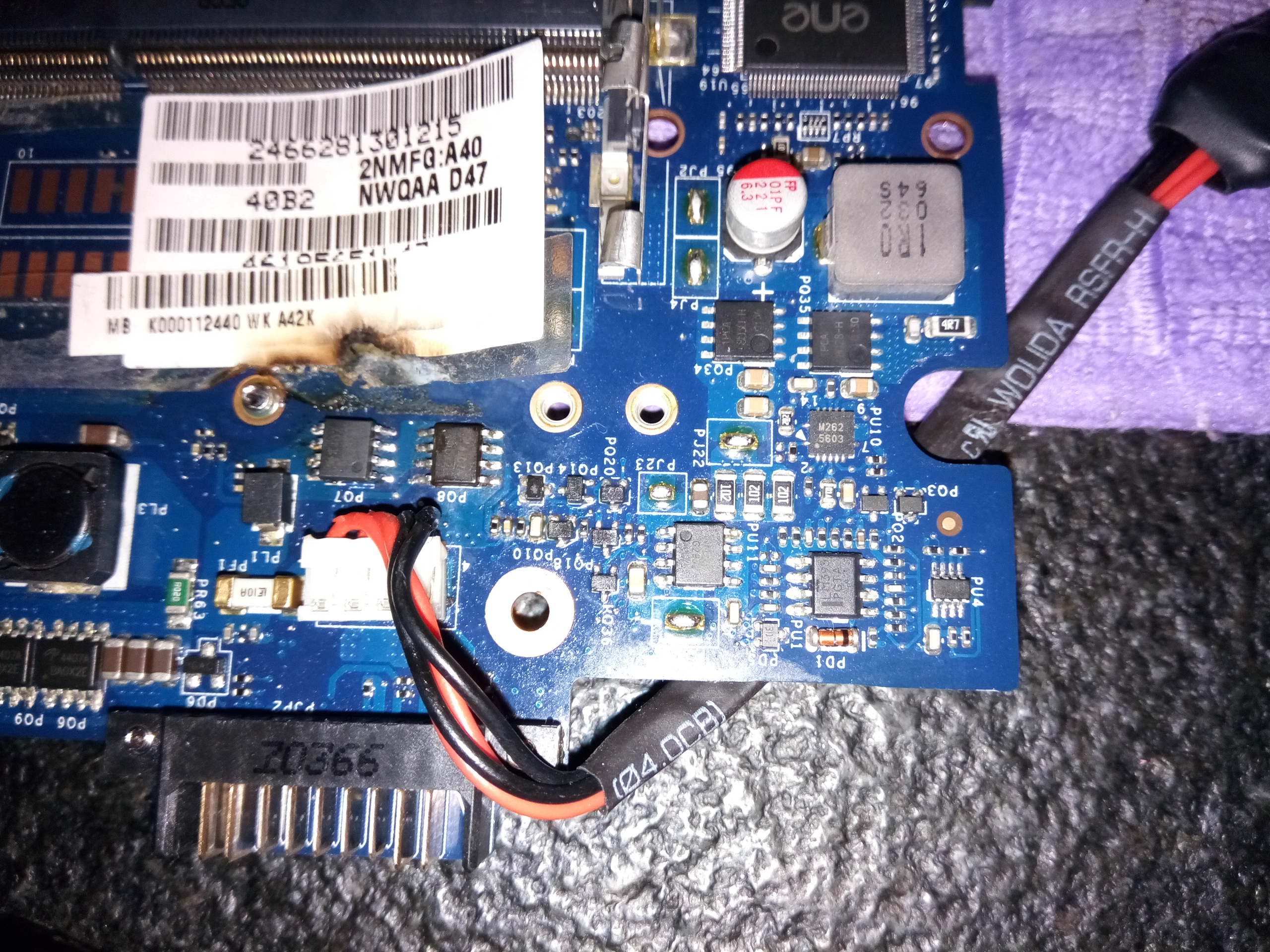

                                • Stevedb
                                  Stevedb
                                  • Feb 2018
                                  • 624
                                  • Belgium
                                  Re: Toshiba A665-14c
                                  See picture of the board
