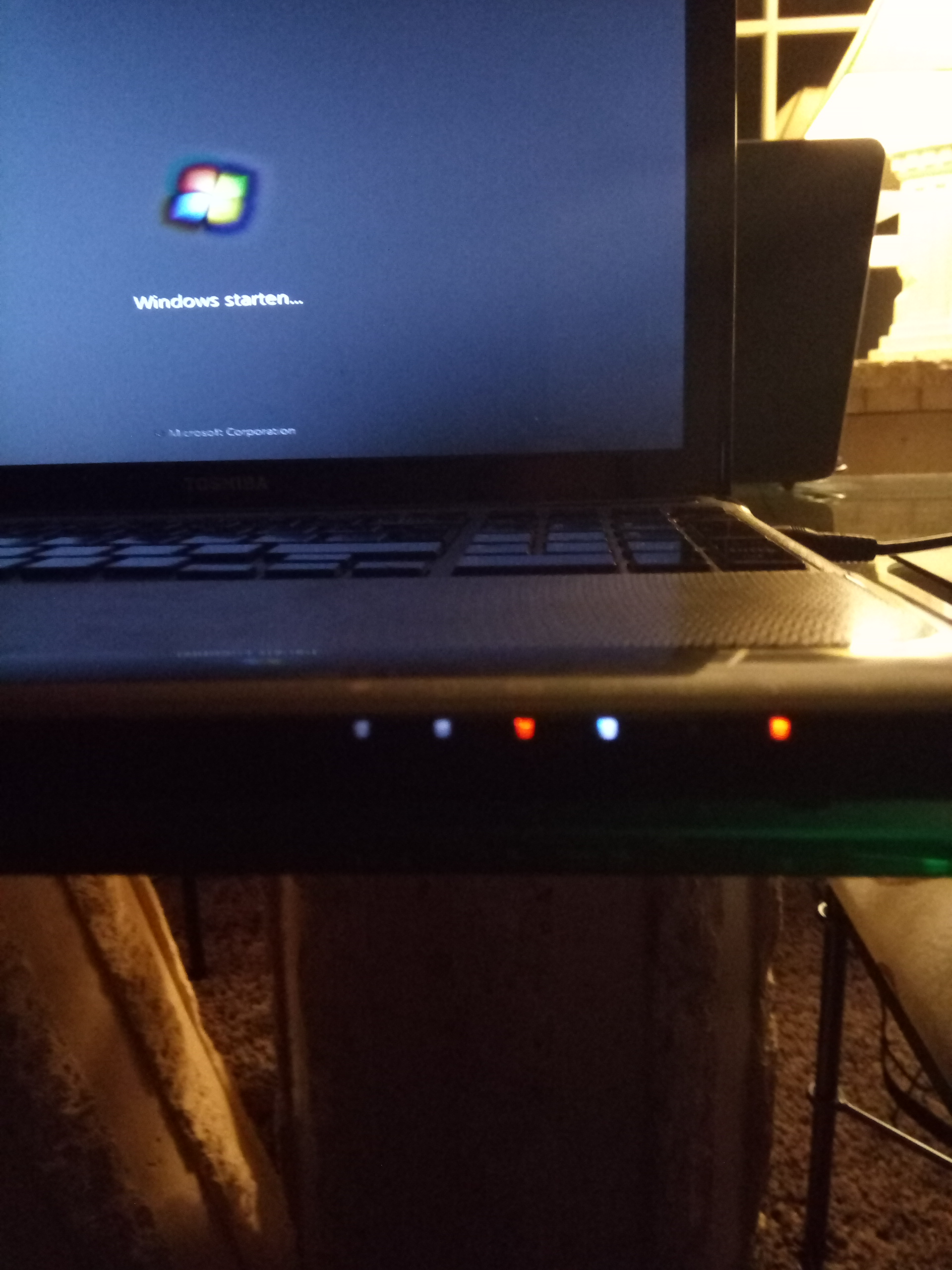

                              Yes you was a great help. Just the mosfet was bad. Ic was still good. I am very happy. Did you also read the other topic of my? I think the lapto not repairable anymore because somebody put the laptop in the oven what do you think abouth that topic.
                              Best regards

                                Re: Toshiba A665-14c
                                Hi midnight
                                Those leds i mean
                                Best regards

                                  #56
                                  I can't think of any reason why the lights on the left would be dimmer than the ones on the right unless the LED board is misaligned in its slot. You can lift out the board to confirm whether it's the alignment or the lights themselves.

                                    #57
                                    Hi midnight i did that are the leds self. When i remove the cover they are less bright. Strange i found that.

                                      #58
                                      The 5V rail is connected to the LEDs through the cable. The PCB has the LEDs and resistors. And then the return path is through the cable to pins on the EC (which are connected to ground to turn on each LED).
                                      The LED brightness is determined by the type/health of the LED and the amount of current going through it. Nothing is impossible. But I can't think of a good reason why the LEDs would suddenly become worn out, or the resistors would increase in resistance, or the transistors in the EC would have a high resistance. The most likely scenarios in my mind are that the cable isn't making good contact, or maybe those LEDs were always like that, long before you ever worked on it.
