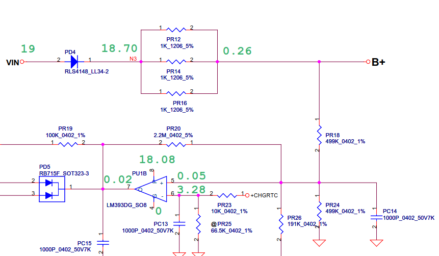

    Hi Midnight i measure the things you said but no short.
    Black on B+ and red on massa
    From testpoint N3 i got 120R
    PU6 pin 8=95K , 11=740R , 17= 29,9K and 20=748R

        It's more reliable to use "diode mode" on your multimeter to do the measurements. The readings should be in volts.
        N3 is where you were reading 18.70V. There is no short there.
        Make sure the picture I attached earlier is correct. You said "measure also 18,70 V testpoint N3 after 0,05V". You are getting 18.7V at N3 but only 0.05V at B+. Is that correct?
        From what I understand, you measured the resistance of N3 to B+ (through PR12/PR14/PR16) as 330 ohms. That is correct for three 1K resistors in parallel.
        Did you find PR18? Does it have almost 0V on both sides?

          I was mistaken testpoint n3 has 0,26V
          The measuring with diode to Massa 0,192
          PU6 pin 8=0,5V , 11=0,173V, 17=0,556V, 20=0,173V
          No I do not find the resistor but when I measure to pin 5 pu1 74,8R when I put red on n3 point , when I measure the other way red on pu1 pin 5 I measure 126,6 R
          Is that normal?

                Oh okay, if N3 has only 0.26V, then that changes things. There's no short on B+ after all. Those diode mode measurements look perfectly good also.
                It might be difficult to measure just the resistors between PU1 pin 5 and N3 accurately. You measured a different resistance in each direction. The current from the meter isn't just going through the resistors. There must be another path between those points that goes through one or more diodes or transistors. So let's not worry about those right now.
                The 0.26V at N3 is the biggest clue now. So let me confirm... are you saying you have ~19V on one side of PD4 and 0.26V on the other? Because if that is true, then PD4 is bad.

                  No on pd4 I have 19v on the 18,70v into. The resistors I have 18,70v and other side 0,26V .

                    Sorry it's is the point after resistors I always measure. What you write on schedule only 0,05V is wrong must be 0,26V same as on pq8

                      Alright, we need to be sure about this. Is the attached picture correct?

                        Yes is correct only pin5 now=0,00V I do not now why maybey it are the other measure leads I use.
                        The other values are correct.

                          Due to the resistor divider (PR18/PR24/PR26), pin 5 of PU1 should be ~21.7% of B+. Therefore, 0.26V and 0.05V make sense. But 0.26V and 0.00V does not make sense.
                          But, if you truly have 18.7V on the left side of those resistors and 0.26V on the right side, then you do have a short on B+. With a voltage of 0.26V, it must have a path to ground of only ~4.6 ohms. There might be a component that has a lower resistance when power is going through it, which is making it harder to find.
                          So, if you are sure about those voltage measurements, I will suggest the same thing I suggested before. Look at the B+ rail in the schematic to find solder jumpers you can remove to isolate parts of the circuit (PJ18 is another example, but there are many more). Or.. connect a current-limited bench power supply to B+ and try to feel which component is getting hot.

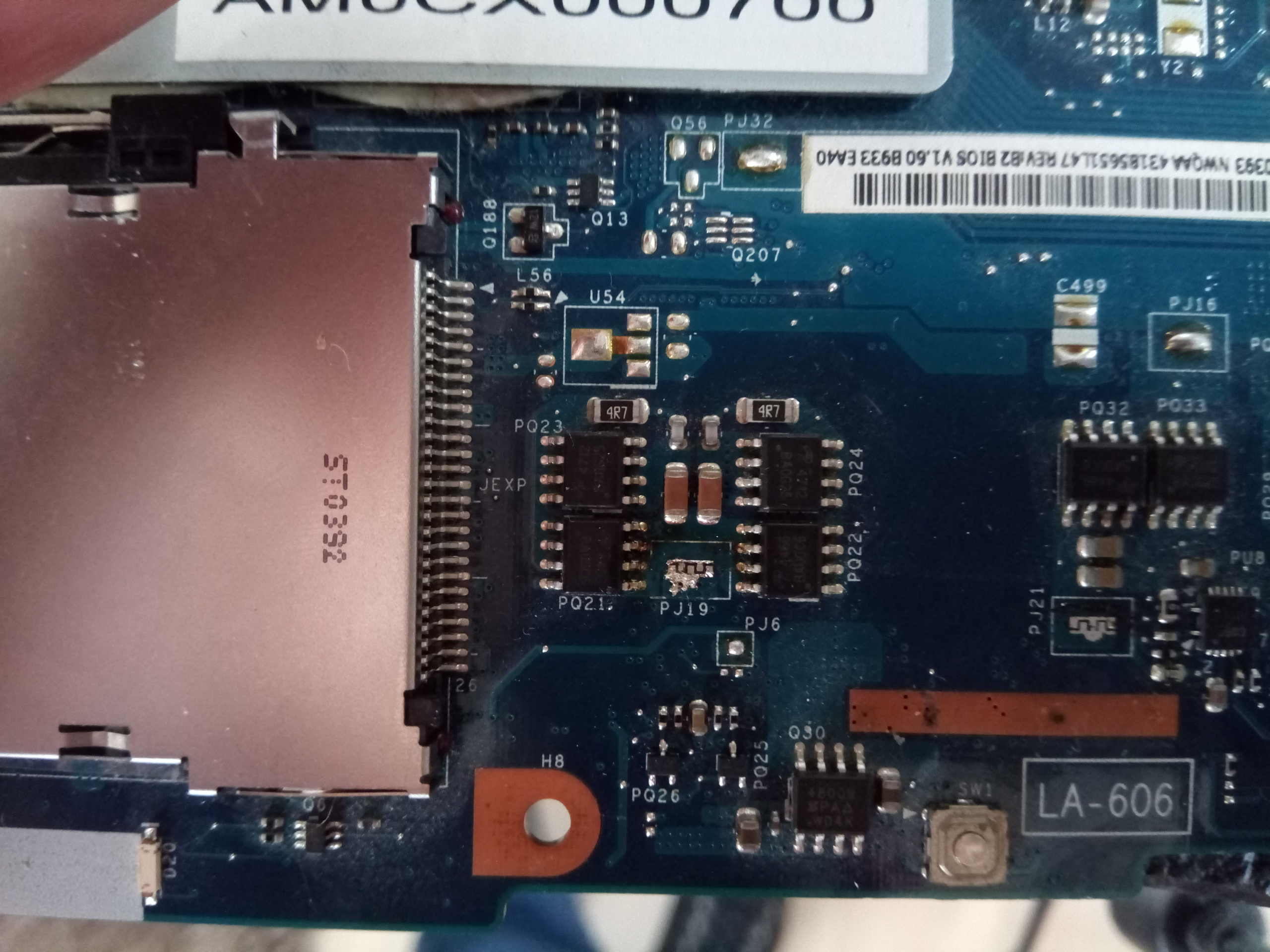

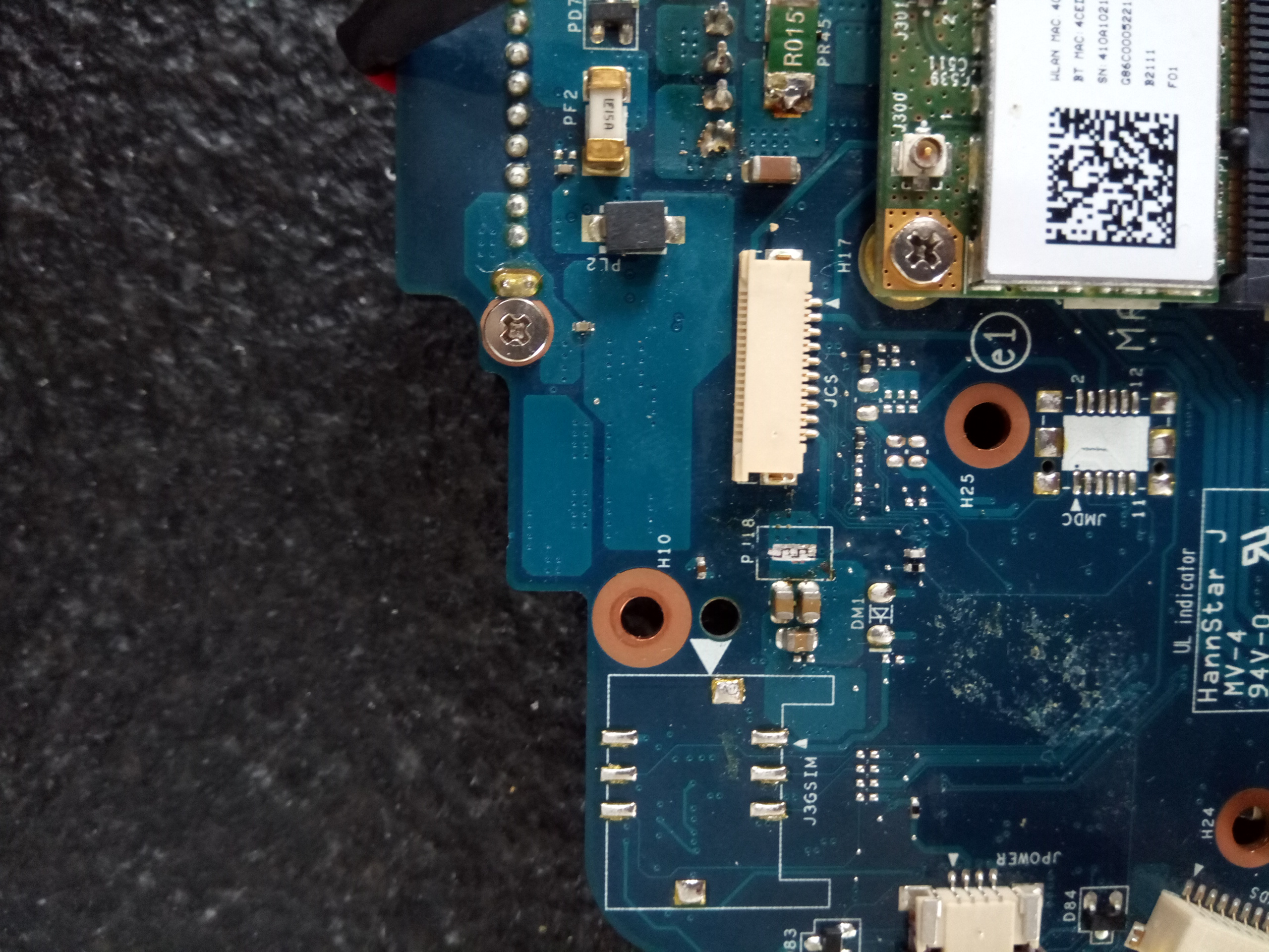

                                I removed jumpers PJ22, PJ21,PJ19,PJ18 . SEE pictures
                                But still no power(0,26V) after resistors point N3 .what can I remove more jumpers.
